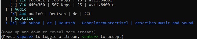

  4. I found out that the media delivery URL can be located by searching for "m3u8" in the tab media.
    Unfortunately, I guest, the video is protected by DRM, so I only get a black-yellow-blue screen. The subtitles are white (standard), but I would like to have the original colored subtitles. Is it possible to get the original colored subtitles?
    Maybe this is the incorrect/missing key?
    HTML Code:
    C:\N_m3u8DL-RE>N_m3u8DL-RE "https://delivery.vod-prd.s.joyn.de/v2/cenc/CiRlODMyOGIxNy1kZDAyLTRlYzUtOTEwYy05M2Y5MzY2N2U4MDc.Cg1hX3AwY2FrcWkydm9uEAMYwAQiJDRhNWE1ZDJlLTM3OGEtNDBiNS05ZTU2LTZmNDhhOGZhNWE1Yg.zDCZ-miuBoZCs6YwRZBwVa71FLP44LNxkG3x_AhWL9k/a_p0cakqi2von/.m3u8?filter=CiQwY2FkNDYzZi0wMWZmLTQyMWMtYjQwYS1jODA4NmU1NzY1NDE.Cg1hX3AwY2FrcWkydm9uGMAEIAEoADAB.1C9g5OCGexxPCNnbaIHjDLnVkRfKQ9UdBJEjpNFEVS4"
    19:09:17.603 INFO : N_m3u8DL-RE (Beta version) 20251029
    19:09:17.608 INFO : Loading URL: https://delivery.vod-prd.s.joyn.de/v2/cenc/CiRlODMyOGIxNy1kZDAyLTRlYzUtOTEwYy05M2Y5MzY2N2U4MDc.Cg1hX3AwY2FrcWkydm9uEAMYwAQiJDRhNWE1ZDJlLTM3OGEtNDBiNS05ZTU2LTZmNDhhOGZhNWE1Yg.zDCZ-miuBoZCs6YwRZBwVa71FLP44LNxkG3x_AhWL9k/a_p0cakqi2von/.m3u8?filter=CiQwY2FkNDYzZi0wMWZmLTQyMWMtYjQwYS1jODA4NmU1NzY1NDE.Cg1hX3AwY2FrcWkydm9uGMAEIAEoADAB.1C9g5OCGexxPCNnbaIHjDLnVkRfKQ9UdBJEjpNFEVS4
    19:09:17.695 INFO : Content Matched: HTTP Live Streaming
    19:09:17.697 INFO : Parsing streams...
    19:09:17.698 WARN : Master List detected, try parse all streams
    19:09:17.701 WARN : Writing meta json
    19:09:17.703 INFO : Extracted, there are 8 streams, with 6 basic streams, 1 audio streams, 1 subtitle streams
    19:09:17.704 INFO : Vid 1024x576 | 4140 Kbps | 25 | avc1.64001f
    19:09:17.705 INFO : Vid 1024x576 | 2470 Kbps | 25 | avc1.64001f
    19:09:17.706 INFO : Vid 1024x576 | 1502 Kbps | 25 | avc1.64001f
    19:09:17.707 INFO : Vid 1024x576 | 940 Kbps | 25 | avc1.64001f
    19:09:17.708 INFO : Vid 1024x576 | 684 Kbps | 25 | avc1.64001f
    19:09:17.709 INFO : Vid 768x432 | 509 Kbps | 25 | avc1.64001f
    19:09:17.710 INFO : Aud audio0 | Deutsch | de | 2CH
    19:09:17.713 INFO : Sub subs0 | de | Deutsch - Gehörlosenuntertitel | describes-music-and-sound
    19:09:45.917 INFO : Parsing streams...
    19:09:45.958 ERROR: Failed to get KEY, ignore.: One or more errors occurred. (The 'data' scheme is not supported.)
    19:09:45.992 ERROR: Failed to get KEY, ignore.: One or more errors occurred. (The 'data' scheme is not supported.)
    19:09:46.034 WARN : An unrecognized encryption method is detected, binary merging is automatically enabled
    19:09:46.054 INFO : Selected streams:
    19:09:46.056 INFO : Vid *UNKNOWN 1024x576 | 4140 Kbps | 25 | avc1.64001f | 2741 Segments | ~01h31m20s
    19:09:46.057 INFO : Aud *UNKNOWN audio0 | Deutsch | de | 2CH | 2741 Segments | ~01h31m20s
    19:09:46.058 INFO : Sub subs0 | de | Deutsch - Gehörlosenuntertitel | describes-music-and-sound | 2733 Segments |
    ~01h31m04s
    19:09:46.059 WARN : Writing meta json
    19:09:46.077 INFO : Save Name: _2026-02-23_19-09-17
    19:09:46.079 INFO : Start downloading...Vid 1024x576 | 4140 Kbps | 25 | avc1.64001f
    19:09:46.099 WARN : Type: cenc
    19:09:46.100 WARN : PSSH(WV): CAESEN2WrrD72YHHkhX4gPmt3FEiDWFfcDBjYWtxaTJ2b24=
    19:09:46.101 WARN : KID: dd96aeb0fbd981c79215f880f9addc51
    19:09:46.102 WARN : Reading [url=https://www.videohelp.com/software/MediaInfo]media info[/url]...
    19:09:46.422 INFO : [0x1]: Video, h264 (avc1), 1024x576
    19:11:11.514 INFO : Binary merging...
    19:11:16.475 INFO : Start downloading...Aud audio0 | Deutsch | de | 2CH
    19:11:16.497 WARN : Type: cenc
    19:11:16.498 WARN : PSSH(WV): CAESEN2WrrD72YHHkhX4gPmt3FEiDWFfcDBjYWtxaTJ2b24=
    19:11:16.500 WARN : KID: dd96aeb0fbd981c79215f880f9addc51
    19:11:16.501 WARN : Reading media info...
    19:11:16.825 INFO : [0x1]: Audio, aac (mp4a), 157 kb/s
    19:11:21.243 INFO : Binary merging...
    19:11:24.597 INFO : Start downloading...Sub subs0 | de | Deutsch - Gehörlosenuntertitel
    19:11:24.629 WARN : Reading media info...
    19:11:24.948 INFO : NaN: Subtitle, webvtt
    19:11:27.855 WARN : Extracting VTT(raw) subtitle...
    19:11:31.281 INFO : Binary merging...
    19:11:31.290 INFO : Done
    INFO : Done

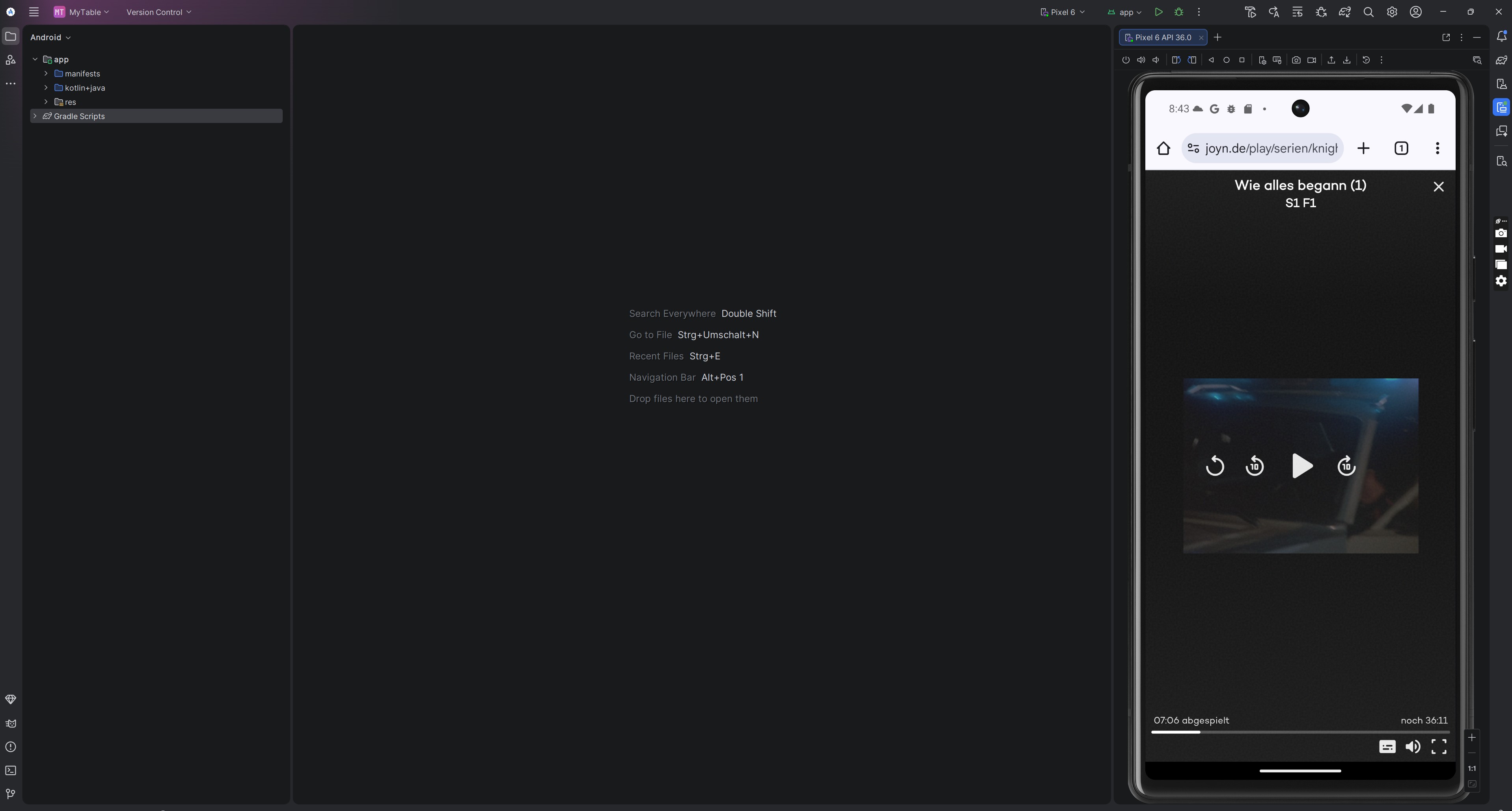

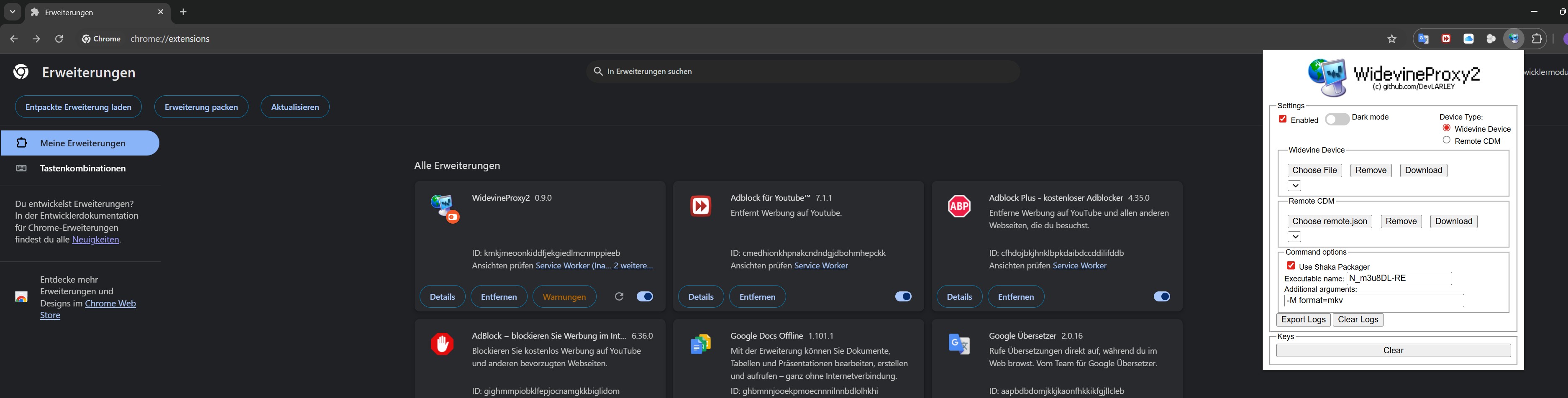

  10. I managed to get everything set up up to this point (see red marked below), but I’m stuck here and can’t move forward because I don’t fully understand these instructions:
    Once installed, open the extension, click Choose File and select your Widevine Device file.
    The files are saved in the extension's chrome.storage.sync storage and will be synchronized across any browsers into which the user is signed in with their Google account.
    Due to the sync storage limit of 100KB, the maximum number of installable devices at the same time is ~30.
    Check Enabled to activate the message interception and you're done.
    I’m not sure what exactly is meant by the “Widevine Device file” or where I’m supposed to get it from. Because of that, I can’t proceed with the setup.
    https://files.videohelp.com/u/315520/HereIsMyVirtualDevice.jpg
    https://files.videohelp.com/u/315520/IamWorkingVeryHardAndNothingIsHappened.jpg
    I'm signed already on Emulator-Device on Chrome.

    widevineproxy2 go add cdm L3.wvd and make sure check enabled

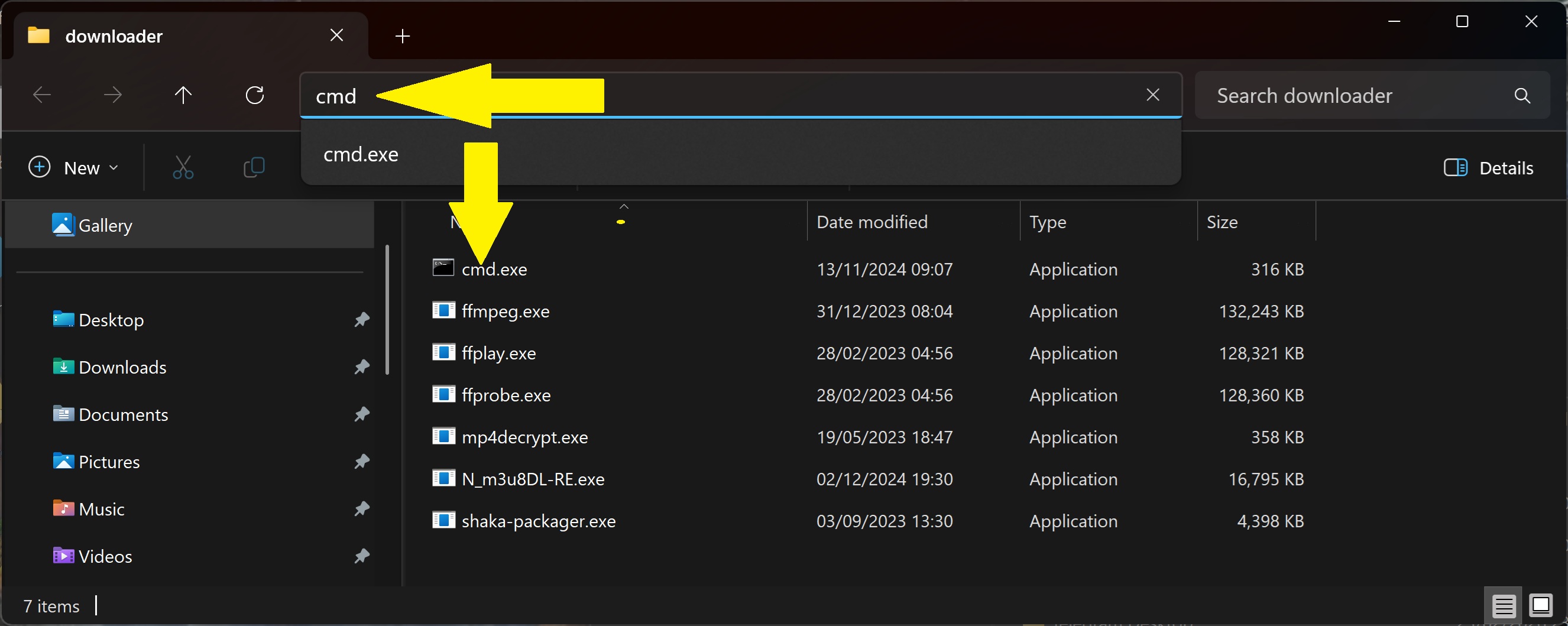

    you miss some file need to download.
    here that all you need
    https://files.videohelp.com/u/301156/downloader.zip
    run cmd, any yellow arrow. enter full n_m3u8dl-re cmd on it
    [Attachment 91312 - Click to enlarge]

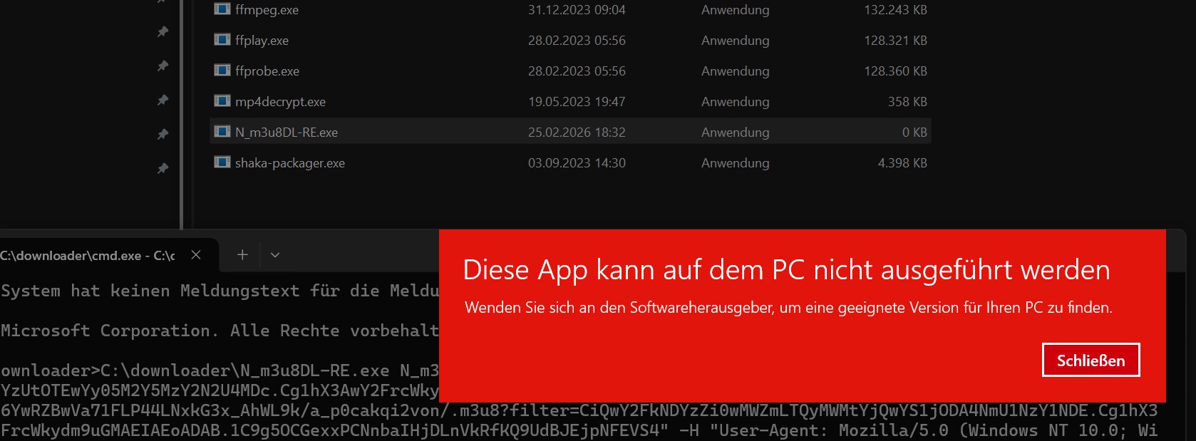

  14. It went something wrong.
    https://forum.videohelp.com/attachment.php?attachmentid=91320&stc=1&d=1772044482
    The first download was succes but the second download failed.
    Dec 2021
    england
    I dont know I cant read german
    Feb 2026
    google.com
    Ger: diese app kann auf dem pc nicht ausgeführt werden
    Eng: This app cannot be run on the PC.
    Dec 2021
    england
    well something his pc playing up.
    download again, place it somewhere
  18. the exe file size is showing 0 KB, obviously some anti-virus removed/quarantined the exe
