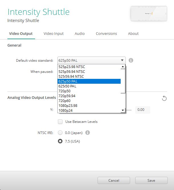

    I want to capture some of my old vhs I captured some good lossless avis back in the past if I rememver correct just need some feedback on what to choose.
    This is my current setup :
    Blaupunkt Rtv 966 > svhs cable > Panasonic DMR-Eh575 > svhs Cable > Blackmagic Intensity Shuttle > Windows 11 Machine using Virtual dub 1.9.11
    First Question :
    I want to capture standard pal vhs tapes which video output would be the best to select in my Blackmagic intensity software?
    Second question :

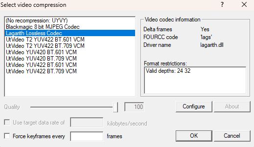

    I can't install huffyuv for the life of me tried everything with no luck so far.
    I read that either lagarith or utvideo would be equal if not supperior to huffyuv using modern machines.
    Which codec would you suggest to use for my project?
    If utvideo which one?

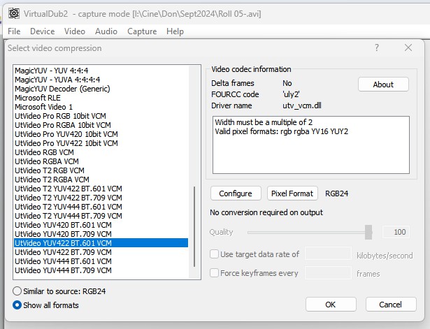

    Yes, it is hard. I have written a guide here. It does require a bit of fiddling about. That might get you there.
    That said, UTVideo is fine for lossless capture; use the ULY2 version:
    [Attachment 91255 - Click to enlarge]
