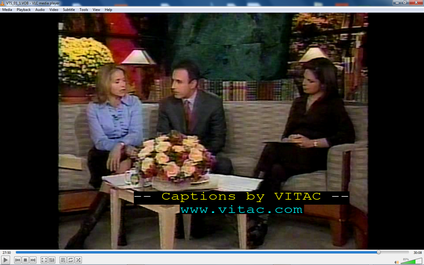

Hi, I'm a newbie here, I wasn't quite sure where to put this as it is a rather odd problem. Lately I have been capturing TV recordings made on VHS, and I have been trying to work out a way to preserve the closed caption data present on the tape. My main setup was not capable of capturing the line 21 data, (A Sony Digital-8 camcorder with built-in TBC connected to the computer via FireWire) So I got a Magnavox DVD recorder working which captures the EIA-608 stream from the tape and writes it to the DVD. I can view these captions on VLC, and the formatting and positioning are correct. My end goal is to have the captions from the DVD saved to a .scc file, as the positioning information will be preserved.
Here is a screencap of VLC's rendering:
[Attachment 91212 - Click to enlarge]
