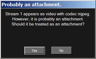

  10. I got it to work on the third try.
    I must have answered some of the Messages incorrectly.
    This one came up on the first song & then 9 more times when I dragged the rest into the batch list: I was not sure but I answered "Yes".

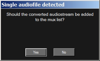

    Later I also answered this Message "Yes":
    Correct.
    This are audio recodes, so there is no need to mux them.
    You can answer NO here.
