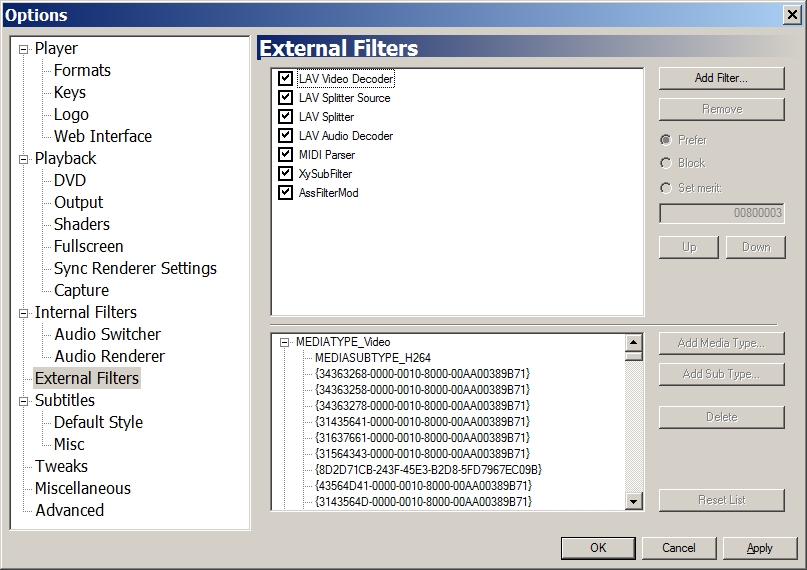

    This is what my External filters looks like.
    All set to prefer except the midi filter:
    [Attachment 91087 - Click to enlarge]

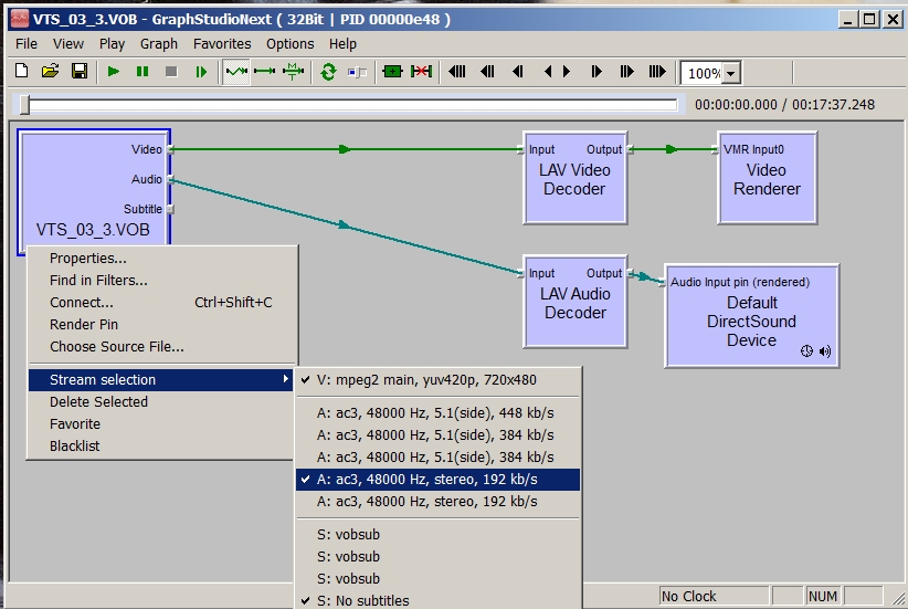

    Per davexnet's instructions tested the LAV filters with graphedit but I used the newer version graphstudionext-0.7.3.2.
    I did this strait from a DVD disc.Once you load your file :
    Use the right click\Stream selection\then the 2 channel audio track.
    The one I selected is .AC3 .
    Then Play. If it plays then the LAV filters are working.
    I also have my LAV filters to show in the system tray when they are used.
    [Attachment 91097 - Click to enlarge]
