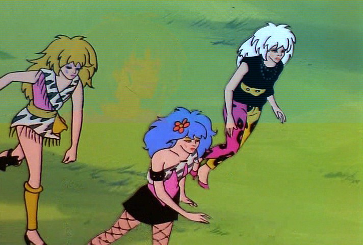

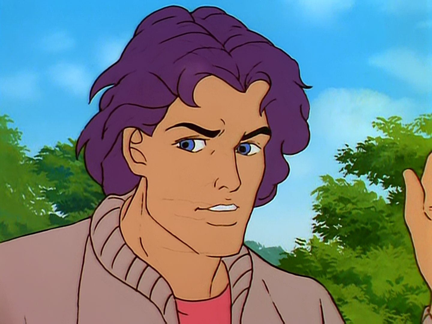

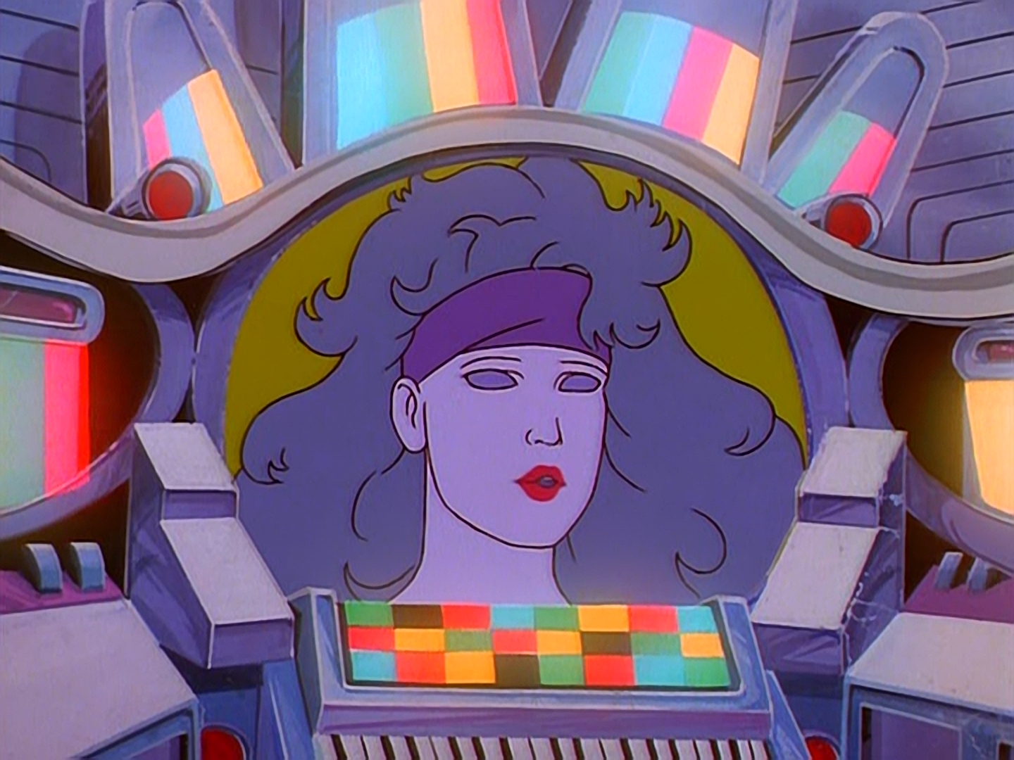

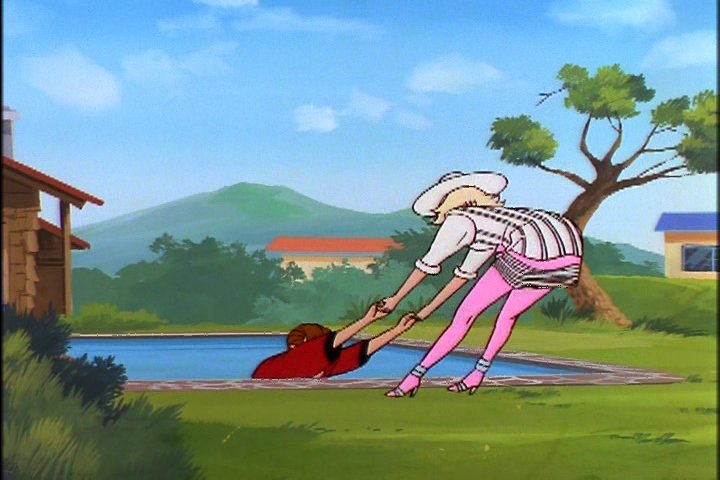

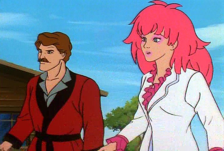

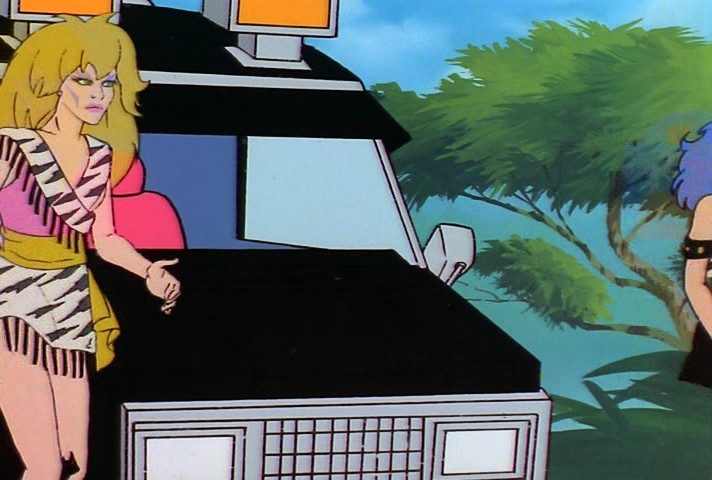

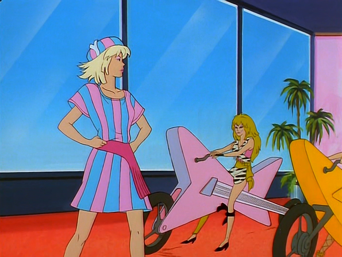

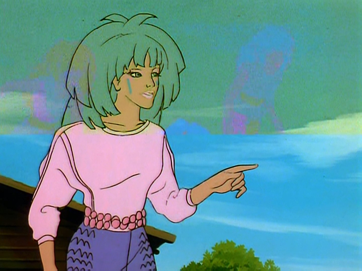

  1. Hi, I have been trying to restore a cartoon (JEM) from DVD for the last few weeks. I'm still a beginner at Avisynth, so I'm looking for any advice and help to get the cleanest source. Here is my code:
    DGsource("VTS_03_1.dgi",fieldop=0)
    TFM()
    TDecimate()
    daa3()
    crop(4,0,-4,0)
    TemporalDegrain2(degrainTR=3)
    mergechroma(aWarpSharp2(depth=8, blur=3, type=1))
    turnright()
    turnleft()
    nnedi3_rpow2(rfactor=2, cshift="Spline36Resize",fwidth=1440, fheight = 1080)
    ColorMatrix(mode="Rec.601->Rec.709")
    GradFun3()
    Prefetch(16)
    So I still have 3 main issues.
    I need a better way to correct the chroma; you can see pink at the edge of white parts and on the skin of the characters.
    There's another strange issue with the chroma where, on some frames, only the top part of the frame has a "ghost" of the previous frame that appears. I will put a picture as an example.
    My 3rd issue would be that on sudden scene changes, the last frame before the scene change has a lot of noise. I also still have some IVTC issues, but I'm not sure anything can be done besides manually replacing the problematic frames in an editing software.
    (The pictures were taken without any post processing just IVTC)
    Chroma issue example:
    [Attachment 90941 - Click to enlarge]
    [Attachment 90944 - Click to enlarge]
    [Attachment 90942 - Click to enlarge]
    Scene change noise (blocking of the picture?):
    [Attachment 90943 - Click to enlarge]
    Chroma bleed example:
    [Attachment 90940 - Click to enlarge]
    Thanks for any help (english is not my native language, sorry if theres some errors).

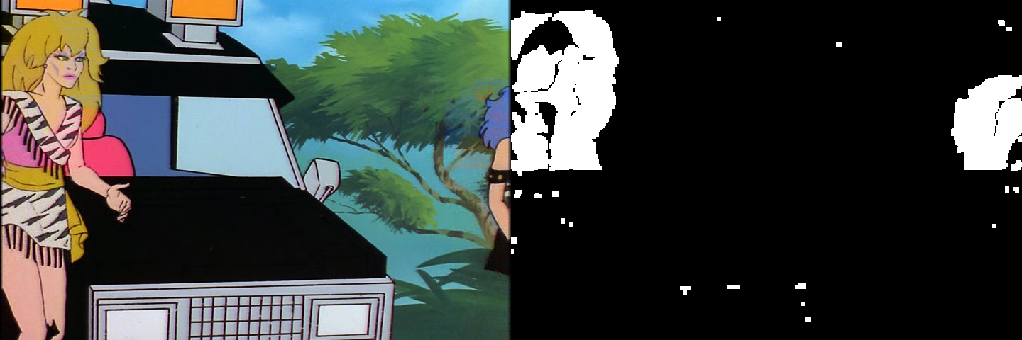

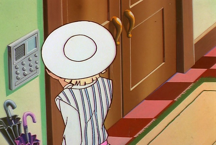

  4. Here is also an example of a frame that is still combed after the IVTC, it's frame number 9336 after decimating at 23.976 fps
    [Attachment 90945 - Click to enlarge]
  5. Looking at the fields:
    a. the intro really didn't get enough bitrate:
    b. there are blends or artifacts already in some fields before some scene changes:
    (in the intro)
    c. rainbows are another issue:
    Ignoring the intro, bobbing the source and looking at the first 10k frames I noticed no chroma issues.
    So the chroma issues seem to be caused by wrong ivtc.
    The problem seems to be the field matching.
    Using TDecimate with clip2=QTGMC(FPSDivisor=2) seems fine. (Alternatively QTGMC followed by sRestore probably is fine too)
    Most of the other issues are due to compression artifacts.

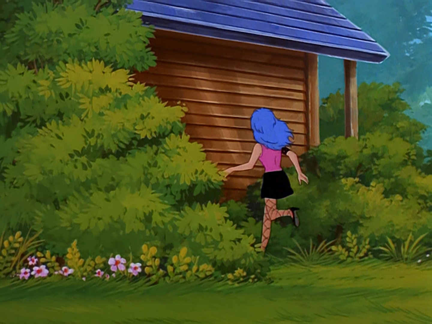

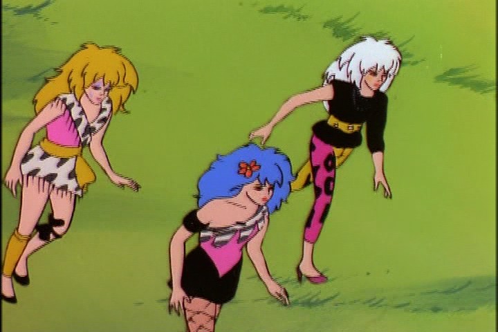

  9. i also have another issue, at decimation it's not always a good frame thats taken here is an example at this frame, that's why i thought about manually correcting those problems by processing a decimated version and an undecimated version (at 29.97fps) so i would take the problematic frames and replace them but maybe with the righ settings this issue can be fixed ?
    The good frame (frame 14934 at 29.97fps) :
    [Attachment 90952 - Click to enlarge]
    The frame taken by Tdecimate (frame 14935 at 29.97fps) :
    [Attachment 90953 - Click to enlarge]
    The frame number from my last message was 9308 (blue haired girl)

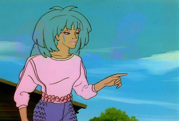

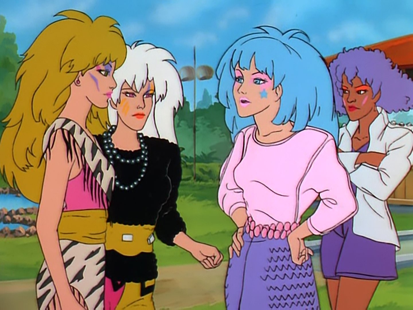

    I used AnimeIVTC first but i always had additional issues so the best way i found was with TFM, i will probably end up correcting all the chroma issues manually in editing because the next frame is usually the same so i will juste replace those frames with the previous and next ones, so this leaves me with two last problems, the bad selected frames at decimation and the colors, would you have recommendations to fix the colors issues on the edges ? with this code i used earlier it ends up doing a white halo in this scene (very visible around the skirt) for example and like you said earlier chroma bleed would not be the issue ?
    Code :
    turnright()
    turnleft()
    [Attachment 90955 - Click to enlarge]
    Heres is an example of the problem, we can clearly see on the jacket of the girl to the right, blue on the left edges and pink on the right edge, the issue is present everywhere we can clearly see it at the edge of the skin whre it's also pink etc
    [Attachment 90956 - Click to enlarge]
  12. ChromaShiftSP(x=-1.5) or similar usually works
    But it might cause problems on other scenes.
    Alternatively mlrt with BleedOut:
    If Vapoursynth is also a possibility and you have an NVIDIA card, BasicVSR++ might also be interessting: https://imgsli.com/NDQ1MDY5
    For white halos, you could also try YAHR or DeHalo_alpha.
    Don't really see it in your example,... (the white there seems to be from the bushes)
    Also for white borders, aWarpSharp on chroma with a negative value might help too.
    Cu Selur

    That's caused by TFM's post processor. It sees the very thin lines as residual combing and deinterlaces the frame. You can reduce that problem by raising the combing threshold, cthresh. Doing that can let some combed frames through though. But in this case a threshold is only slightly higher than the default will prevent the deinterlacing, 10 instead of the default of 9.

  20. For the residual chroma combing/blending, the first step is to detect it. Here I've used mt_edge to detect areas of combing (after TFM) in the chroma channels:
    [Attachment 90973 - Click to enlarge]
    On the left is the frame, the right is the areas of residual combing in white.
    The next step is to get good chroma from either the frame before or the frame after. In this case the next frame is the same as this one but free of the chroma combing/blending. But sometimes it's the frame before. And a few cases (scene changes) neither is a match.
    One could use a runtime filter to copy the good chroma to the bad frame (or just copy the entire frame) when the combing is detected. The trick is to determine which frame to get the good chroma from.

  22. Originally Posted by jagabo View Post

  23. Now I'm working on the upscaling part and with my actual code I have this residual noise you can see it especially around the edges of the hair and the nose, etc. I'm trying to remove it while keeping the most details possible, by example, I can get it out with Hqdn3d but it erases a lot of fine details in the backgrounds etc, would anyone have a suggestion? And is my upscaling code good or could it be performed better ?
    [Attachment 91005 - Click to enlarge]
    code :
    FFmpegSource2("JEMP.mkv")
    nnedi3_rpow2(rfactor=2, cshift="Spline36Resize")
    GradFun3()
  24. Here is an unprocessed sample and a processed sample
  25. You might want to try dehalo or deringing filters for noise that is just around edges or use an edgemask and a denoiser.
