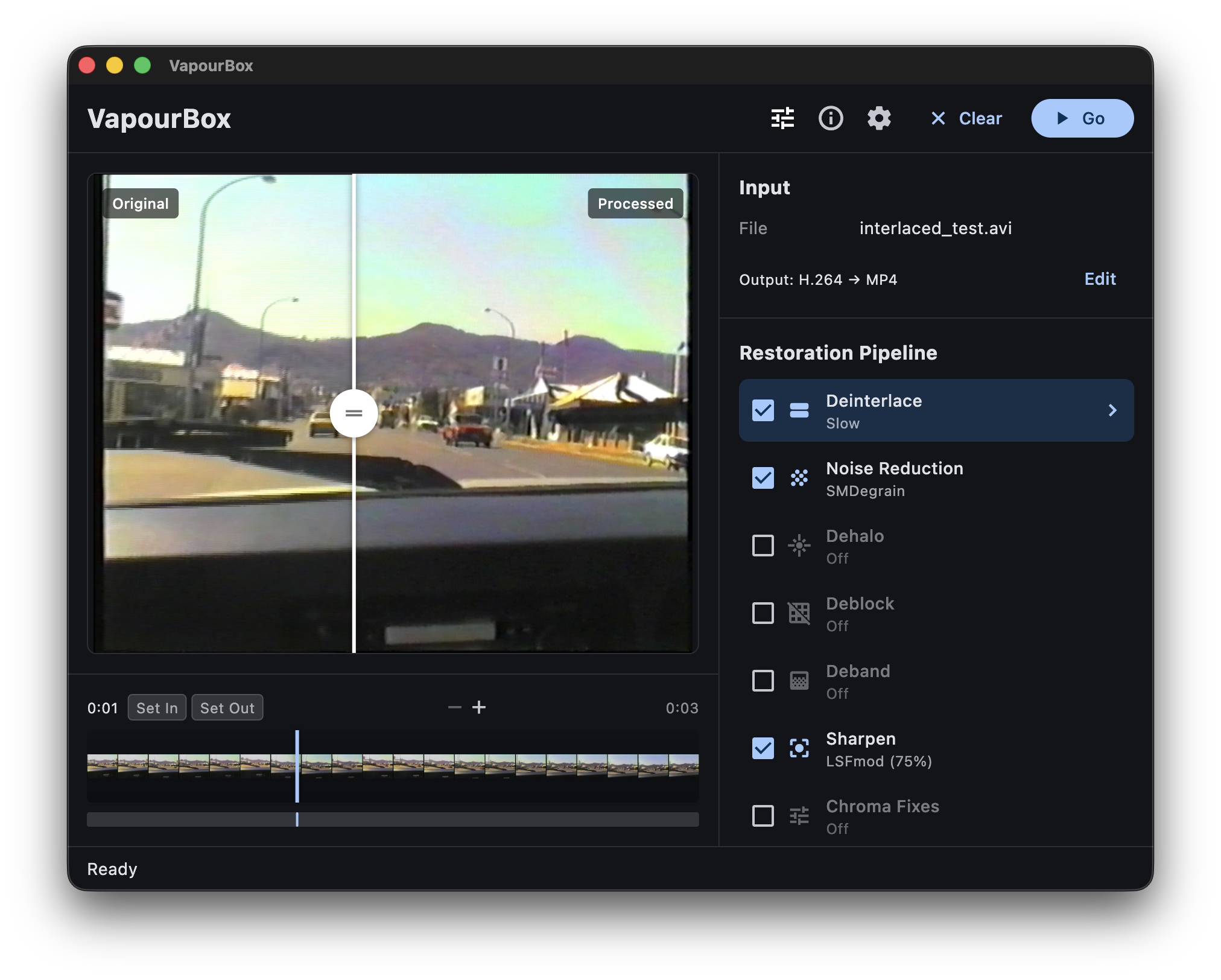

    I've just released 0.1.0 of a new open source tool GUI tool I've built called VapourBox (in honour of all the heavy lifting done by VapourSynth).
    [Attachment 90871 - Click to enlarge]
    It's a friendly wrapper around VapourSynth and its various plugins (including QTGMC de-interlacing) available to everyday folk who don't want to have to navigate the command-line or complex tools. It's available on both Mac and Windows. Just drag & drop an input video, tick the filters you want to apply, check out the split preview and go nuts.
    You can grab a copy from https://github.com/StuartCameronCode/VapourBox, just go to the Releases page. The app automatically fetches a bundle of all the various third-party tools required on first launch.

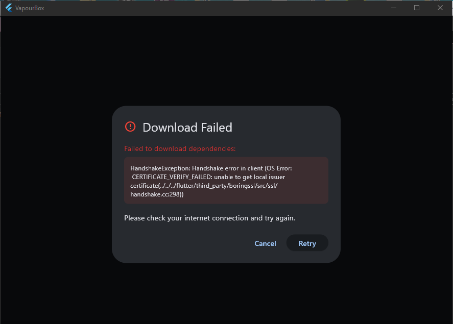

    I ran it and got this:
    [Attachment 90873 - Click to enlarge]

    Thanks, I'm setting up a VM to try to reproduce the issue. From some googling it seems to be that the underlying HTTP library used by Flutter has SSL trust issues with GitHub if you don't have their root certificate installed. Having a play with a workaround, stay tuned.

    0.2.0 release is out with a change to the http library used to download dependencies. Hopefully that sorts the issue!
  8. Thanks, 0.2.0 downloads ffmpeg,ffprobe, portable vapoursynth and portable python 3.8 into directories within portable vapourbox.

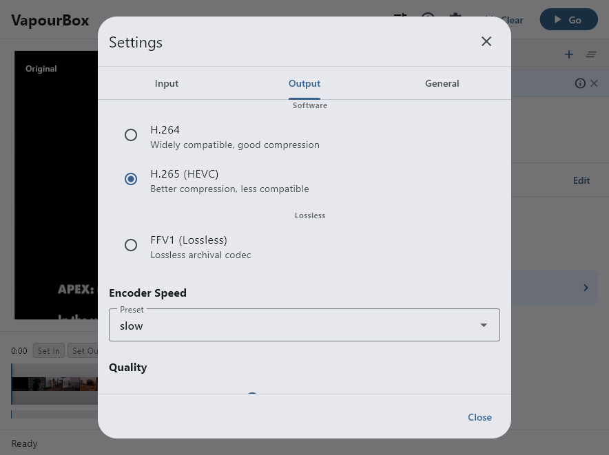

  20. I'm using an NVIDIA RTX 2060 with the latest drivers, 591.86, under Windows 10 and it doesn't appear that I have the option to use hardware encoding with v0.5.0. I see the software codecs listed and lossless. No hardware encoding.
    [Attachment 91128 - Click to enlarge]
    Jan 2026
    Melbourne, Australia
    If you go into the deps\windows-x64\ffmpeg folder and run "ffmpeg -encoders -hide_banner" can you see "h264_nvenc" or "hevc_nvenc" listed? The app queries what codecs ffmpeg supports on your machine, if it's not listed then I guess it must be an ffmpeg issue.

  22. Originally Posted by StuartCameronCode View Post
    The version of ffmpeg used on Windows comes from https://github.com/BtbN/FFmpeg-Builds/releases/download/latest/ffmpeg-master-latest-win64-gpl.zip, can you try downloading from there and running the same command on that version and tell me if it's any different? If you've still got no luck perhaps try a few ffmpeg versions and if you find one that works for you then copy it into the app's `deps` folder and run VapourBox again. If that works, let me know and I can try switching the bundled version to an alternate build.
    Thanks!
    C:\Program Files\VapourBox\deps\windows-x64\ffmpeg>ffmpeg -encoders -hide_banner
    Encoders:
     V..... = Video
     A..... = Audio
     S..... = Subtitle
     .F.... = Frame-level multithreading
     ..S... = Slice-level multithreading
     ...X.. = Codec is experimental
     ....B. = Supports draw_horiz_band
     .....D = Supports direct rendering method 1
     V....D av1_nvenc            NVIDIA NVENC av1 encoder (codec av1)
     V....D h264_nvenc           NVIDIA NVENC H.264 encoder (codec h264)
     V....D hevc_nvenc           NVIDIA NVENC hevc encoder (codec hevc)
    The output lists NVIDIA NVENC for av1, h264, and hevc. That said, the RTX 2060 doesn't have support for av1 encoding so I'm confused on that. Regardless, I used the ffmpeg that came with VapourBox in the deps folder to perform a command line encode for both h264_nvenc and hevc_nvenc and it worked successfully so the issue doesn't appear to be with ffmpeg.

    I've released version 0.5.1, which fixes the bug with hardware codec detection on Windows release builds. Ironically it was working in debug builds just fine .
    https://github.com/StuartCameronCode/VapourBox/releases/tag/v0.5.1
    VapourBox will now always display all hardware codecs, it's up to you to ensure you pick one that's supported on your system.
  25. Originally Posted by StuartCameronCode View Post
    Oops!
    I can confirm it's definitely working for me now. Thank you!
