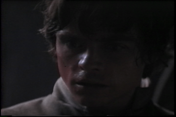

  1. Hello, I've been doing VHS capturing for several years now and have spent a lot of money on various capturing and recording devices to improve my capturing methods. Without going into full history of what I've done I'll break it down to where I have it currently. My current recording devices include a JVC HR-S9900U S-VHS VCR, a WinTV HVR 950Q capture card, and for external TBC I alternate between a AVT-8710 (green) or a Big Voodoo TBC10 along with a Panasonic ES15 DVD recorder. I have a Panasonic AG1980 VCR but its so problematic that I don't use it anymore. I did have a JVC HR-S9911U VCR but I was having some repairs done to it and it might not be usable anymore.
    Anyways to what I really want to discuss and I'll be honest semi-rant about. A major reason I've done the bulk of my capturing in the last few years with S-VHS players is well those are what are typically recommended if you want quality captures and mostly for the built in TBC's that improve image stabilization. But I have had one continuous gripe with EVERY S-VHS player I have tested in the last few years and that is that regardless, and I mean REGARDLESS, of whatever my capturing setup is, regardless of what device I'm capturing with be it a capture card or a DVD recorder, these players have an annoying tendency to either go slighter dark in some spots or slightly bright. Most of the time its random but I've done several tests where every now and then they occur in the same spots. Here's a GIF that semi illustrates what I mean (I recommend looking at this from a computer monitor). Note how it goes slightly dark near the end??
    I know it's not the best example but its what I have on hand. Maybe I'm being picky but frankly I find this very annoying. In my history of doing VHS captures if I capture from a non-S-VHS player most of the time I don't get issues like this if for example I use a DVD recorder for pass through. However a big problem with that method is without a proper TBC I get occasional frame jumps. Not many, they're probably as infrequent as the dimness spots I get with S-VHS players but nonetheless still there. Either way I'm settling for less than what I want.
    Regardless of what my capturing method is, if an S-VHS VCR is in the mix, those dimness spots are gonna occur. Its occurred with EVERY S-VHS player I've tested. A year or so back I even tested a JVC-S7600u VCR. Still happened. This just seems like a continuous byproduct of S-VHS players, at least with me it has. I've yet to test an S-VHS player that didn't do this. Frankly its been ruining my interest in capturing and there's stuff I wanna save. But not if there's continuous spots where it randomly gets dim and then not. I almost wanna just go back to a regular VCR and a DVD recorder as a passthrough and just live with the frame jumps. They're not frequent, they're about as noticeable as the dimness spots I'm getting with these S-VHS players. I just think on a professional and monetary level these are not the results people should have. I've tried and tried, what seems so simple just guarantees a compromise. I literally would rather just watch my tapes as is going forward. S-VHS players and external TBC's do not give me what I want.

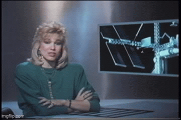

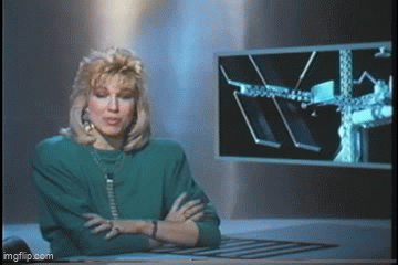

    Don't think its a tape issue (am I certain?? no) mainly just cause it happens to varying degree regardless of what tape I use. Could you elaborate on AGC of the capture card?? Is that something I need to tap into (I wouldn't know how anyway)?? Here's a few more GIFS. That first one I shared was actually captured a few years on the Panasonic AG1980 using a a Mygica Capit capture card. No DVD recorder or external TBC (I didn't have an external TBC at the time).
    This was captured literally two days ago. Setup was JVC S9000U VCR, Voodoo TBC10, Panasonic ES15 DVD recorder, WinTV HVR 950q capture card.
    For comparison here's a capture I did of the same tape about 2-3 years ago. Can't fully remember the setup. Think this was the either the JVC HR-S9900U or the HR-S9911U and the Panasonic ES15 as a passthrough and recorded to a JVC DR-M10 DVD recorder. Fairly sure I didn't have an external TBC for this not counting the Panasonic. But as you see there's no subtle flicker here.

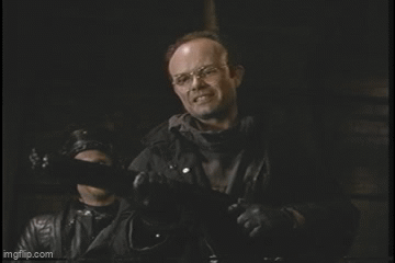

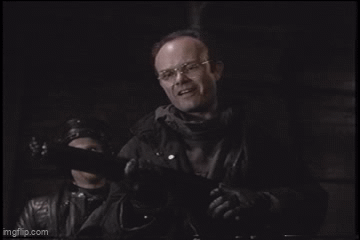

    But just to counter that here's a clip from the capture I did two days ago...
    ...versus the DVD recording I did a few years ago.
    The first one goes slightly lighter near the end while the second if you look REAL close it goes slightly dim about midway (as he starts raising the rifle).

    Apologies since I'm only just seeing this response after I posted my last one. The first GIF I shared was a straight capture. AG1980 (TBC on), Mygica Captit Capture card, computer. I should've clarified that bit in my initial post but as I said that was the only clip I had on hand at the time that I could share on the fly to illustrate what I meant.
