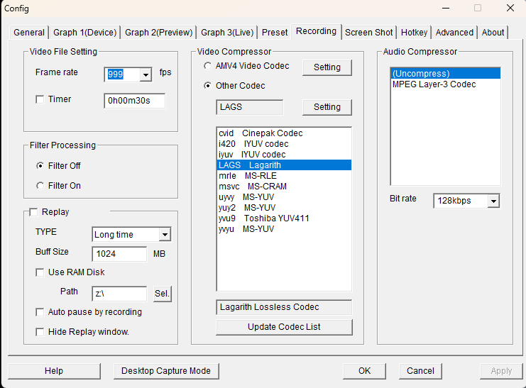

    I installed the Lagarith codec and set it as my codec in AmaRecTV. Also set my recording resolution to 720x480
    [Attachment 90753 - Click to enlarge]
    Still getting the same result, with video becoming extremely choppy after about 11 minutes . AmaRec reports 0 dropped frames. Even when I'm not recording the preview is choppy.
