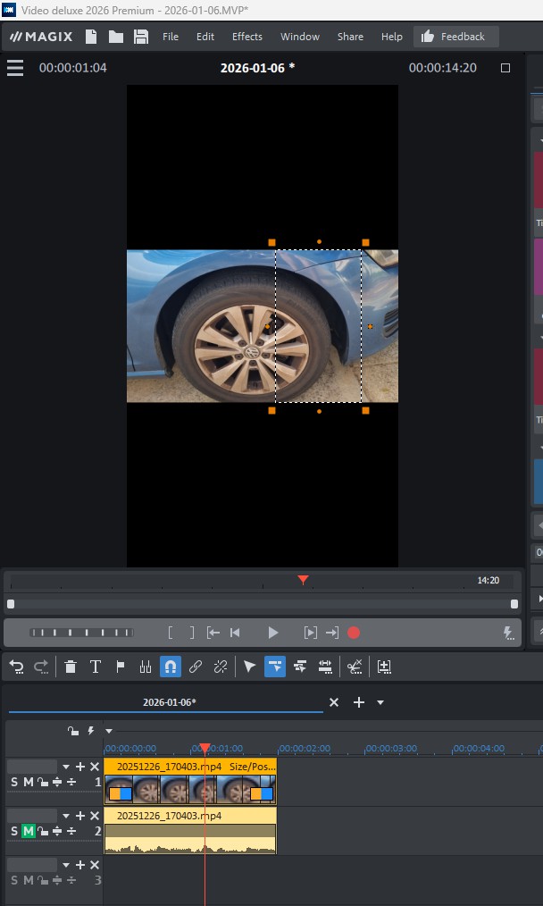

    Here's a test. 2 seconds long (50 frames), panning from left edge to right edge of a 16:9 video and back. It's going to be jerky because you're panning so far.
