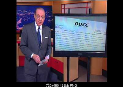

    at the tv station i work at we have a setup for transferring our beta tapes. the issue is that the encoder that we have SUUUCKS. 10mbps mpeg2, anamorphic widescreen 480i with pillarboxing, and the fields are screwed. the raw video when imported in premiere is jagged and jumpy. i know you gotta do what you gotta do if you're in a time crunch but i wanted to see if this could be fixed in software.
    i was able to fix this in vapoursynth with some help, but i'm much more familiar with avisynth. plus trimming both video and audio at the same time is much easier for me. is there a way to fix this in avisynth? sample attached.

  14. The fields are stored in the wrong spacial order. Ie, the lines of the top field are stored below the lines of the bottom field.
    LWLibavVideoSource("Monday 10PM B Week Cap 2 clip2.avi")
    ConvertToYV24(interlaced=true) # to allow cropping one line off the top and adding one at the bottom
    Crop(0,1,-0,-0).AddBorders(0,0,0,1)
    SwapFields()
    QTGMC()
    You can then fix other issues...
    SwapFields()
    QTGMC()
    thanks!! that helped a lot!!

  22. Originally Posted by ProWo View Post
    How did you discover that?
    You can see it on diagonal edges that aren't moving. It's obvious the scan lines are in the wrong order. The "combing" isn't caused by motion since the edge isn't moving. Swapping the fields smooths out those edges.
