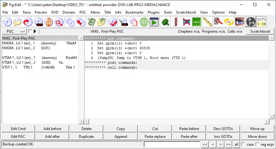

    PgcEdit main page after VIDEO_TS folder.

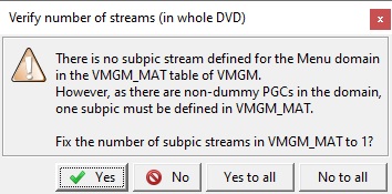

    PgcEdit gives this message when launch. Clicking yes to all didn't work either.
