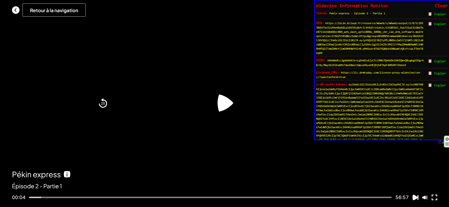

  6. Hello, I just used Tampermonkey on M6.fr to extract x-dt-auth-token from the license url, the pssh code and the mpd extension of the video, adding colors in console.log.
    [Attachment 90332 - Click to enlarge]
    If you are interested in the script, let me know.

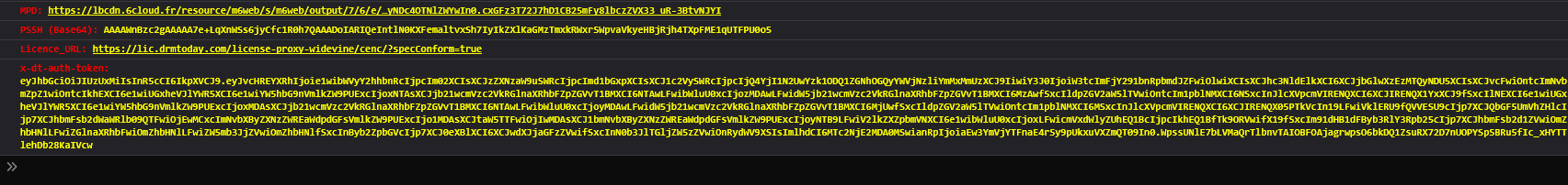

  7. Here I come to finish with a panel with M6 replay with Tampermonkey:
    [Attachment 90350 - Click to enlarge]
