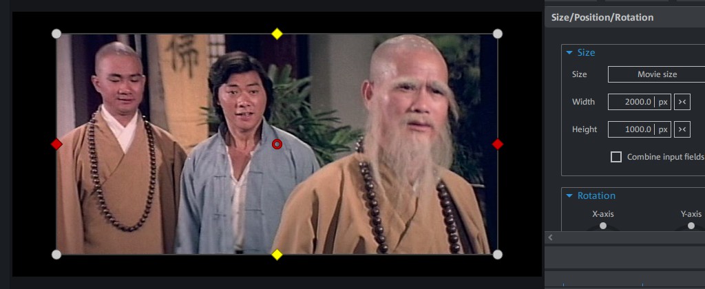

Some doubts here about the true aspect ratio of the movie. DVD is DAR 16:9 or 4:3 (and theoretically SAR 1:1 square pixels). Neither looks quite right for the .VOB source. Leaves some room for speculation IMO ....
Is the true movie aspect ratio 16:9, 1.85:1 or 2.40:1 or something exotic, like 2.0:1 (18:9 Univisium)? Opinions?Last edited by Sharc; 16th Dec 2025 at 06:56.
Agree, the DVD, if displayed at 16:9 (as per Mediainfo), is definitely borked.

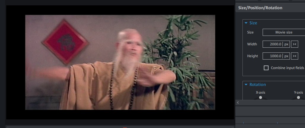

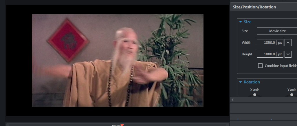

I'm leaning towards 2:1. All the heads are different shapes, which makes it tricky, but the red diamond on the wall (assuming it's square) looks best at 2:1.
1:85:1
[Attachment 90264 - Click to enlarge]
2:1
[Attachment 90265 - Click to enlarge]
1:85:1
[Attachment 90266 - Click to enlarge]

I agree with 2:1 for the movie. So the OP's DVD (the .VOB) is square pixels it seems. I have never seen this. Every day something new
I just wonder which DVD player would play it correctly. -
