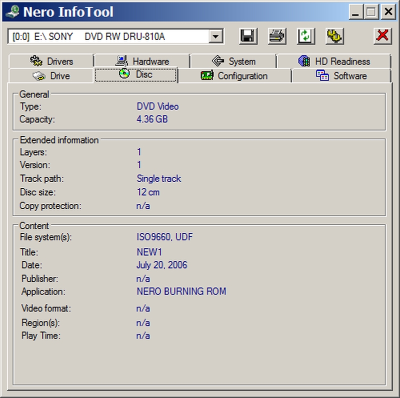

    Nero InfoTool shows this:
    [Attachment 90256 - Click to enlarge]
    Application shows as Nero Burning ROM.
    This indicates to me it is a Written(Burned) DVD.

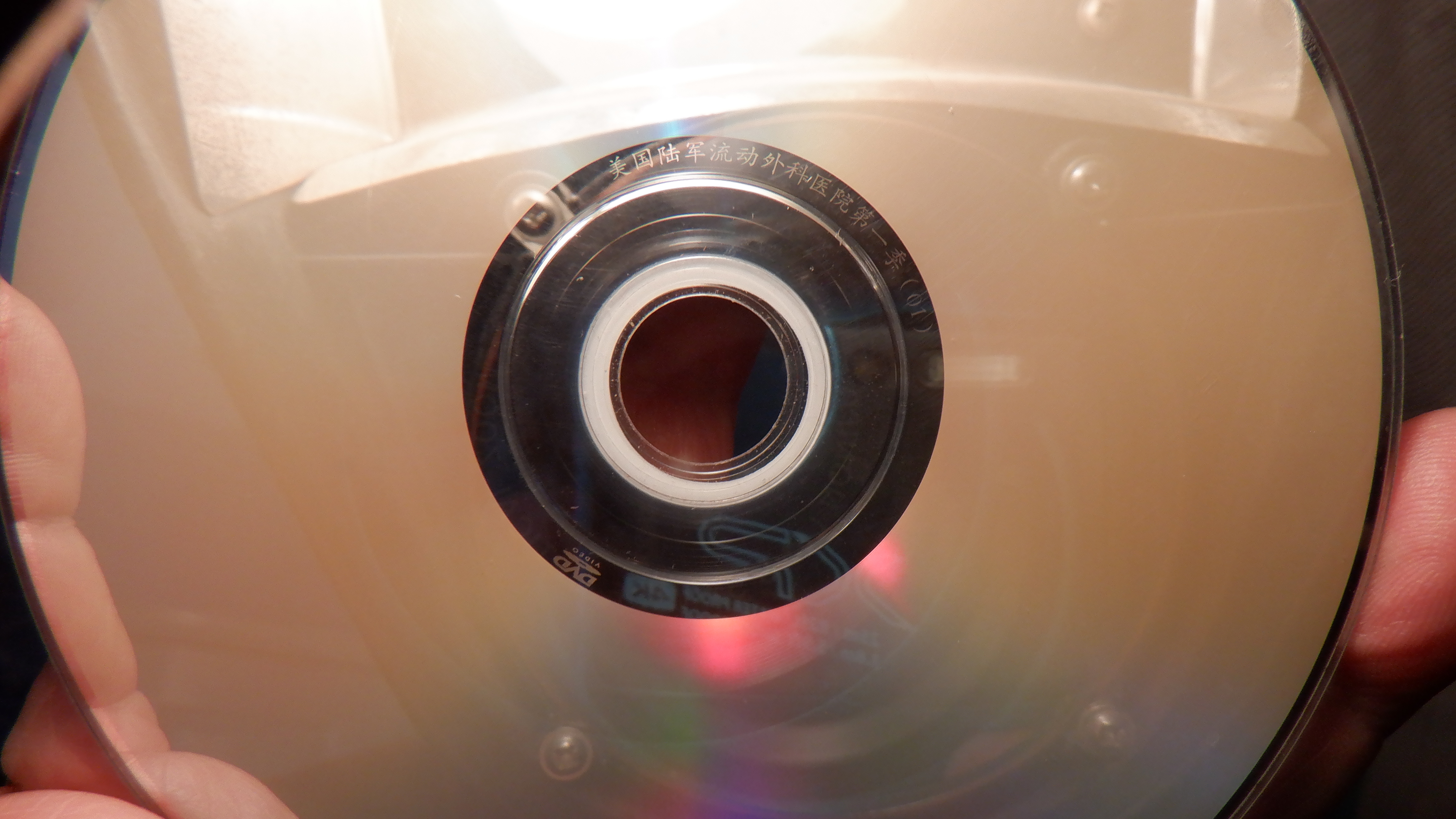

    In this picture there is Japanese or Chinese writing:
    The only English says "DVD Video"
    [Attachment 90257 - Click to enlarge]
    Nothing shows it as DVD + or - R .

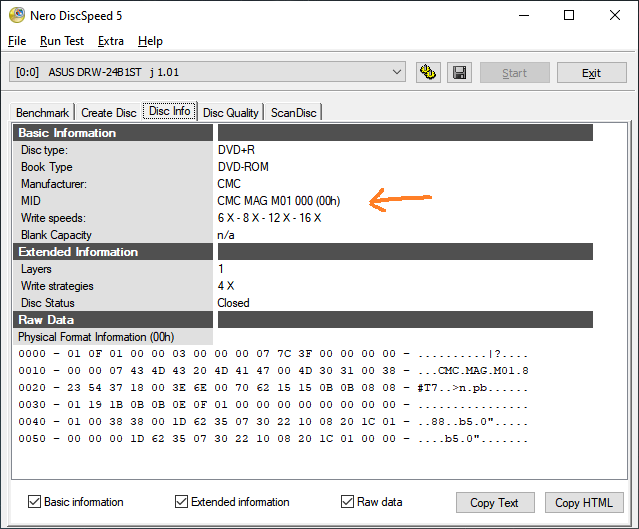

    For a burned disk you would see MID info:

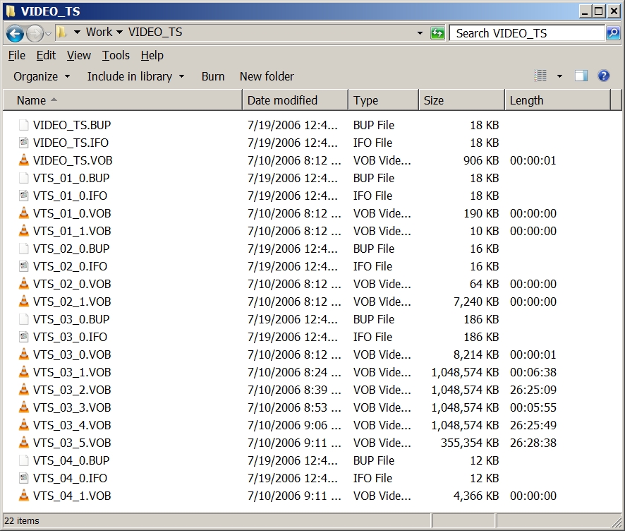

    Yes. This is what the Windows Explorer looks like.
    Note the times of the main .VOBs.
    I usually run a TV series DVD through DVDShrink & break it into a .VOB per episode.
    I have deleted DVDShrink rip but The episodes only showed 6 seconds.
    In both VlC & MPC-HC the episodes showed as about 25 minutes each & played correctly..
    On my TV they showed 6 seconds & that was all that played.
    [Attachment 90259 - Click to enlarge]

    But note these two .VOBs
    VTS_03_4.VOB 1,048,574 KB 26:25:49
    VTS_03_5.VOB 355,354 KB 26:28:38
    I doubt the 355,354 KB .VOB is 26:28:38 in length. or the 1,048,574 KB either,
    The 26 is hours.
    If you mean 26:25 is minutes & seconds I know from playing the DVD all the episodes are not the exact same length.

    It's simplified Chinese characters on the DVD.
    美国陆军流动外科医院第一季
    U.S. Army Mobile Surgery Hospital Season 1
    美国陆军流动外科医院第一季
    Thanks for the translation. I feel better about these DVDs now.
    I still believe they are burned discs. Made in China some years ago & without a MID.
    If they were not burned then Nero InfoTool would not show Nero Burning ROM as the application.

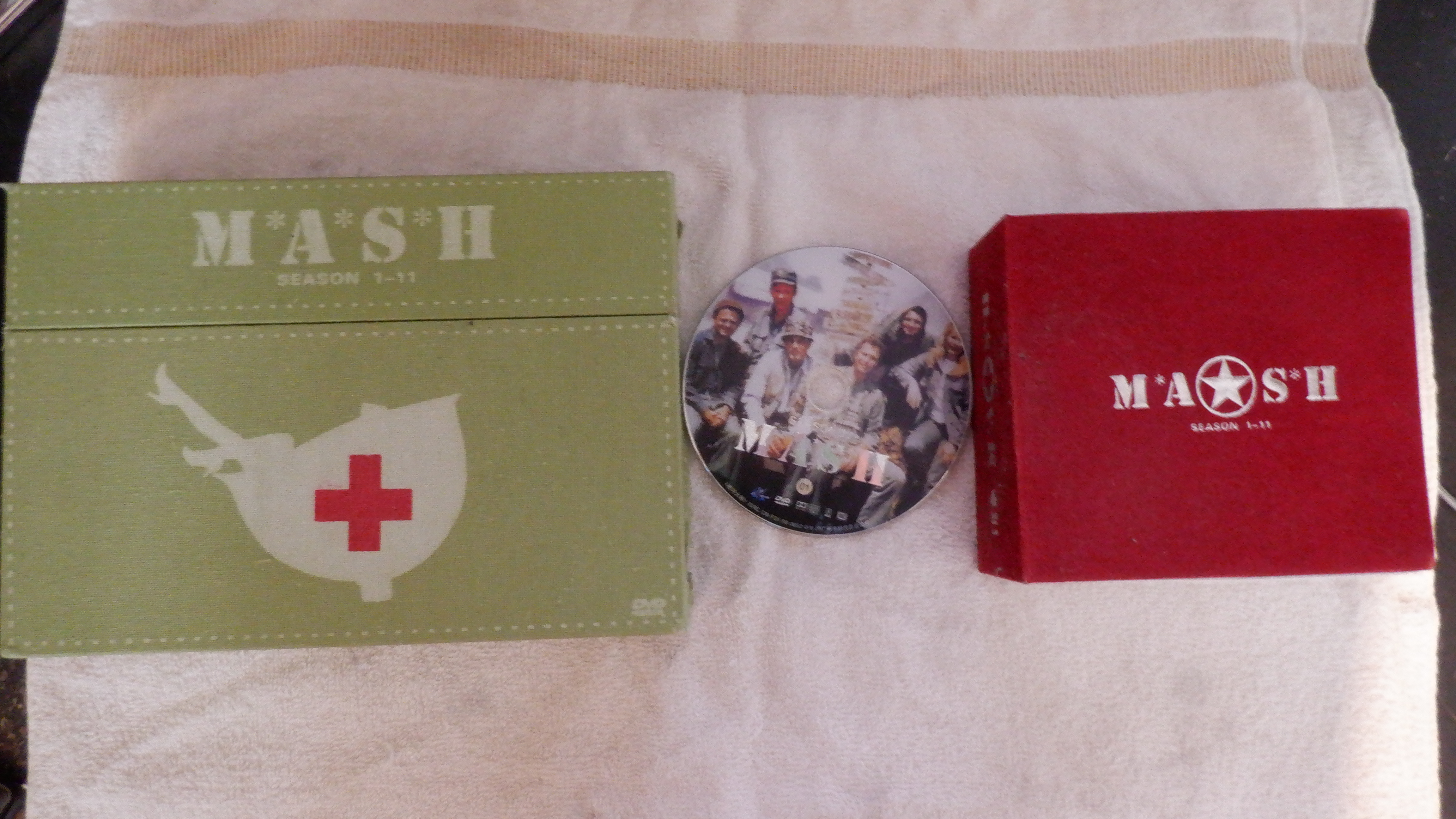

    This is the boxed set I have:
    33 discs 256 episodes disc 33 has the final 2 hour episode.
    [Attachment 90311 - Click to enlarge]

    I tend to agree with you on this.
    A professional bootleg created box set.
    The only thing that conflicts with this is:
    Nero InfoTool reports: Application:NERO BURNING ROM
    VSO Inspector reports Application:NERO BURNING ROM
    This may be a "false read" but it should mean these are burned DVDs.
    I suppose it is possible that a rip with NERO BURNING ROM of the commercial copyrighted DVD was used to create the "single layer DVD-ROMs done in an industrial stamper". Meaning used to create the master for the press.
