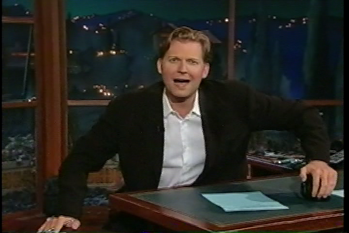

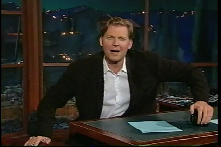

    Frame before:
    [Attachment 90133 - Click to enlarge]
    Erroneous frame:
    [Attachment 90134 - Click to enlarge]

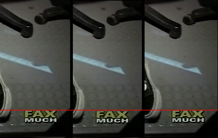

    Another video with a logo also illustrates it well. Middle frame it drops by two lines, the frame before and after are both aligned.
    [Attachment 90136 - Click to enlarge]

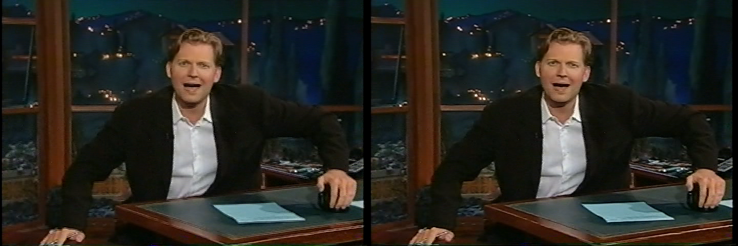

  2. Field glitches, like breaks in the fields sequence (=broken field dominance), dropped or swapped fields.
    You can try to mitigate with field matching
    TFM(order=-1,mode=0,pp=0) # play with the settings
    Frame 125: left original - right matched
    [Attachment 90139 - Click to enlarge]
    or maybe better just deinterlace using QTGMC() for some improvement.
    For a better (more laborious) fix one would have to address these drops or swaps individually.

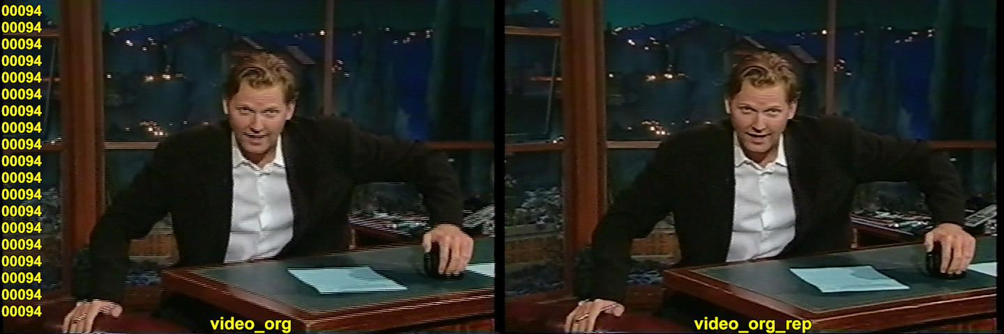

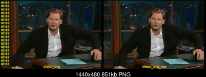

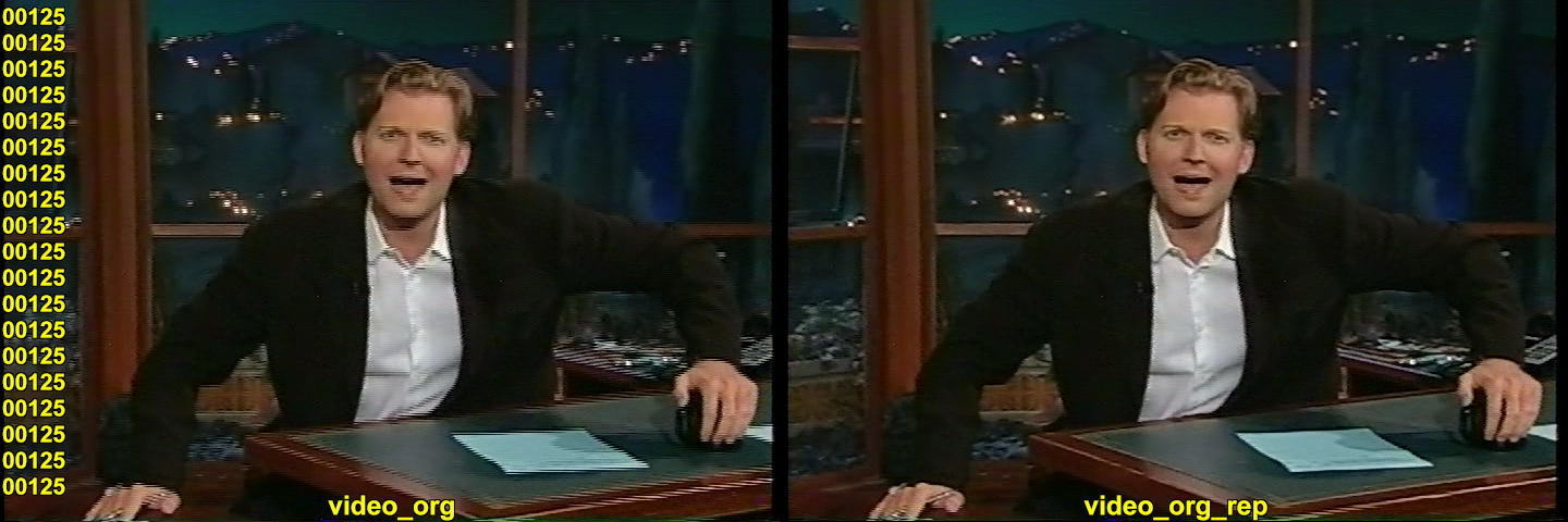

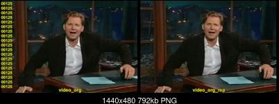

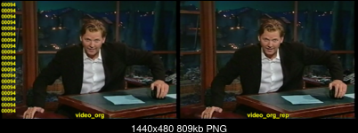

    To fix them you can run a dedicated script:
    video_org=FFmpegSource2("error-sample.demuxed.m2v").ConvertToYUY2()
    # shift fields
    video_org_rep=video_org\
    .shift_fields(25,-1,-1)\
    .shift_fields(94,0,-1)\
    .shift_fields(125,0,-1)\
    .shift_fields(161,0,-1)
    stackhorizontal(subtitle(video_org,"video_org",size=28,align=2).showframenumber(), subtitle(video_org_rep,"video_org_rep",size=28,align=2))
    #return(video_org_rep)
    function shift_fields(clip c, int frame_number, line_shift_even, line_shift_odd)
    # separate fields tff
    c_tff_sep=c.AssumeTFF().separateFields()
    # separate fields tff even
    c_tff_sep_even=c_tff_sep.SelectEven()
    # separate fields tff odd
    c_tff_sep_odd=c_tff_sep.SelectOdd()
    # shift field even
    c_tff_sep_even_rep = (line_shift_even > 0) ?\
    	c_tff_sep_even.trim(0,frame_number-1)\
    	++c_tff_sep_even.trim(frame_number,frame_number).crop(0,0,0,-line_shift_even).addborders(0,line_shift_even,0,0)\
    	++c_tff_sep_even.trim(frame_number+1,0)\
    	++c_tff_sep_even.trim(frame_number,frame_number).crop(0,-line_shift_even,0,0).addborders(0,0,0,-line_shift_even)\
    # shift field odd
    c_tff_sep_odd_rep = (line_shift_odd > 0) ?\
    	c_tff_sep_odd.trim(0,frame_number-1)\
    	++c_tff_sep_odd.trim(frame_number,frame_number).crop(0,0,0,-line_shift_odd).addborders(0,line_shift_odd,0,0)\
    	++c_tff_sep_odd.trim(frame_number+1,0)\
    	++c_tff_sep_odd.trim(frame_number,frame_number).crop(0,-line_shift_odd,0,0).addborders(0,0,0,-line_shift_odd)\
    # repaired video
    c_rep=interleave(c_tff_sep_even_rep,c_tff_sep_odd_rep).Weave()
    return(c_rep)
    You can also notice that the defect at frame 161 triggers the AGC of the capture device, because the is a change in brigthness (sometimes it happens)
