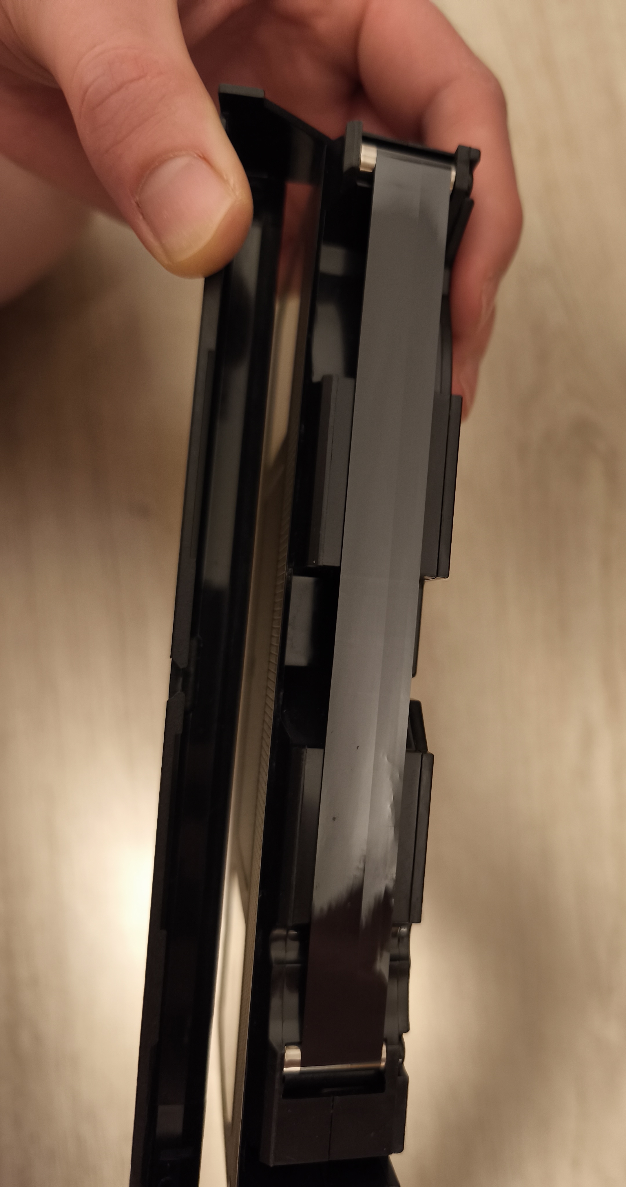

    Hold open the flap and take a clear picture of the tape issue and post it here.

    Sure, it's a bit awkward to photograph.

    Try cleaning the capstan, pinch roller and the other guides

    You need to observe the tape during playback to make sure it looks steady, if it's waving, lifting up or sinking then you have a transport problem. If unsure take a 5 min video with your phone moving very slowly across the tape path and changing angles while shooting.
    Alternatively, inspect the affected tapes, take them apart and see if there is any broken parts inside the cassette shell or anything unusual, Post pictures if unsure.

    The photo isnt totally clear but it's possible the damage was incurred from the back side of the tape, not the oxide side we see in the photo. But having the tape with you, you should be better able to tell from which side of the tape the damage occurred. Then work out which stationary parts in the tape path press against the tape and from which side. This should help you narrow down which part or parts in the cassette and/or the VCR likely did the damage. It could be a small piece of hardened dirt stuck to a guide or perhaps a scratch or sharp edge in a metal part in the tape path of the VCR or cassette. There arent a lot to check.
