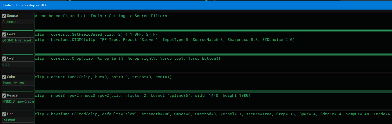

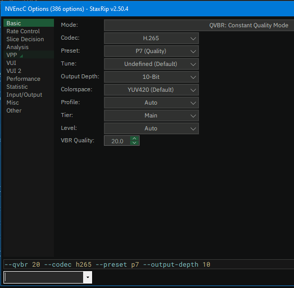

Now, I've tried using StaxRip to improve a test clip of about 5 minutes as much as possible
before working on the hundreds of clips I'll have in total.
[Attachment 90058 - Click to enlarge]
[Attachment 90059 - Click to enlarge]

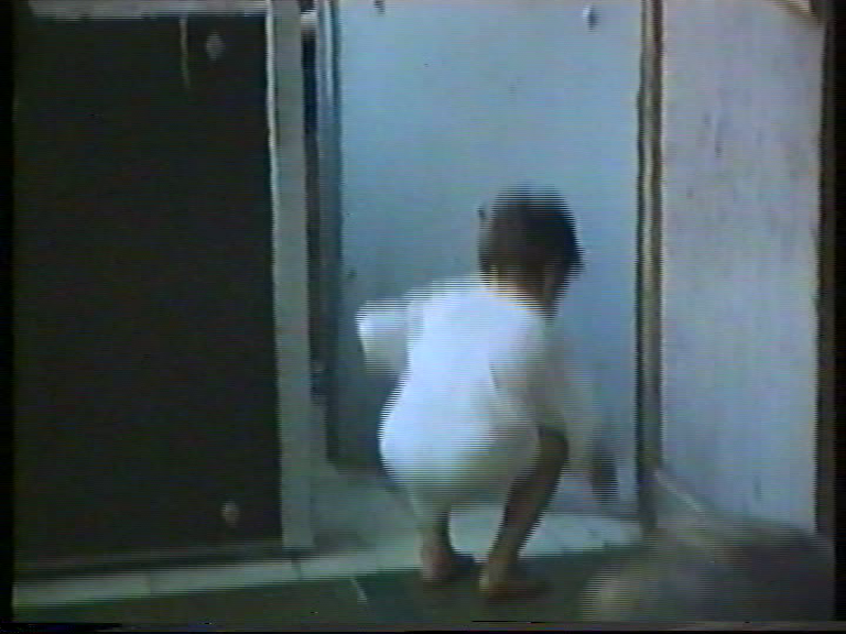

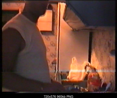

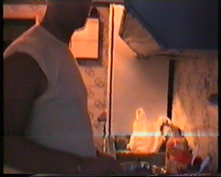

The source is interlaced TFF, and is not in good shape.
There are corrupted frames (4, 5, 1288, 5862, 5863, 5876, 5877), comets (the white moving spots) and other defects.
The levels are OK.
I do not use any GUI, so following is an AviSynth flow.
As first, I would deinterlace with QTGMC.
Then I would motion interplate the corrupted frames, for instance with MVTools (MFlowInter)
Let's stop here for now, let us know if you need assistance running this filtering. We'll try to fix the others defects later. However, do not expect miracles. -

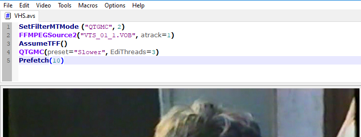

[Attachment 90083 - Click to enlarge]
I also downloaded AvsPmod_64, AVSInfoTool_113 and VirtualDub2
I created a basic starting script and it seems to work
[Attachment 90084 - Click to enlarge]
How did you figure out which frames were corrupted?

Sorry but I'm a newbie, Here is the current script:
Code:SetFilterMTMode ("QTGMC", 2) FFMPEGSource2("VTS_01_1.VOB", atrack=1) AssumeTFF() QTGMC(preset="Slower", EdiThreads=3) Prefetch(10) -

Concerning detection of corrupted frames, there is some automatic procedure (like the one developped here: https://forum.doom9.org/showthread.php?t=183582), but nothing beats a visual inspection, better at slow speed (very time consuming), for example with a code like this, played for instance in VirtualDub:
About the replacement of corrupted frames, let's start with a basic procedure:Code:video_org=AviSource("your file") video_org_no_audio_slow_motion=video_org.killaudio().AssumeFPS(10, true) return(video_org_no_audio_slow_motion)

FFMPEGSource2("VTS_01_1.VOB", atrack=1) SetFilterMTMode ("QTGMC", 2) AssumeTFF() QTGMC(preset="slow", matchpreset="slow", matchpreset2="slow", sourcematch=3, tr1=2, tr2=1, NoiseTR=2, sharpness=0.1) Prefetch(10) video_org=FFMPEGSource2("VTS_01_1.VOB") video_org_rep=video_org_rep\ .interpolate_1frame(frame_number=4)\ .interpolate_1frame(frame_number=5)\ .interpolate_1frame(frame_number=1288)\ .interpolate_2frames(frame_number=5862)\ .interpolate_2frames(frame_number=5876) return(video_org_rep) function interpolate_1frame(clip c, int "frame_number") { # interpolate bad frame sup = c.MSuper()\ bv = MAnalyse(sup, isb=true, delta=2) fv = MAnalyse(sup, isb=false, delta=2) interpolated = MFlowInter(c, sup, bv, fv) # replace bad frame with interpolated frame video_repaired = \ c.trim(0,frame_number-1)++\ interpolated.trim(frame_number-1,-1)++\ c.trim(frame_number+1,0) # video repaired return(video_repaired) } function interpolate_2frames(clip c, int "frame_number") { # plugins directory plugins_dir="C:\Program Files (x86)\AviSynth+\plugins64+\" # a x x b # a x b b # a iab b b # a iab iabb b # replace second bad frame with a duplicate of its next frame video_repaired_tmp1 = \ c.trim(0,frame_number)++\ c.trim(frame_number+2,frame_number+2)++\ c.trim(frame_number+2,0) # replace first bad frame with interpolated frame video_repaired_tmp2 = video_repaired_tmp1.interpolate_1frame(frame_number=frame_number) # replace second bad frame with interpolated frame video_repaired = video_repaired_tmp2.interpolate_1frame(frame_number=frame_number+1) # video repaired return(video_repaired) }Code:--------------------------- File open error --------------------------- Avisynth open failure: I don't know what 'video_org_rep' means. (D:\FileScaricati\VHS.avs, line 13) --------------------------- OK ---------------------------
does not open .VOB fileCode:video_org=AviSource("your file") -
Thanks for your help and patience, but I also got the error message with FFmpegSource2 as I wrote in my post
Sorry, it should be:
Btw, better to use the same type of code style for the whole script (the deinterlacing part does not use variable assignement for each command)Code:video_org_rep=video_org\ .interpolate…
Thanks Lollo! Now it seems to work!
Code:SetFilterMTMode ("QTGMC", 2) FFMPEGSource2("VTS_01_1.VOB") AssumeTFF() QTGMC(preset="slow", matchpreset="slow", matchpreset2="slow", sourcematch=3, tr1=2, tr2=1, NoiseTR=2, sharpness=0.1) Prefetch(10) processed_clip = last video_org=FFMPEGSource2("VTS_01_1.VOB") repaired_clip=processed_clip\ .interpolate_1frame(frame_number=4)\ .interpolate_1frame(frame_number=5)\ .interpolate_1frame(frame_number=1288)\ .interpolate_2frames(frame_number=5862)\ .interpolate_2frames(frame_number=5876) return(repaired_clip) function interpolate_1frame(clip c, int "frame_number") { # interpolate bad frame sup = c.MSuper()\ bv = MAnalyse(sup, isb=true, delta=2) fv = MAnalyse(sup, isb=false, delta=2) interpolated = MFlowInter(c, sup, bv, fv) # replace bad frame with interpolated frame video_repaired = \ c.trim(0,frame_number-1)++\ interpolated.trim(frame_number-1,-1)++\ c.trim(frame_number+1,0) # video repaired return(video_repaired) } function interpolate_2frames(clip c, int "frame_number") { # plugins directory plugins_dir="C:\Program Files (x86)\AviSynth+\plugins64+\" # a x* *x* * b # a x* *b* * b # a iab b* * b # a iab iabb b # replace second bad frame with a duplicate of its next frame video_repaired_tmp1 = \ c.trim(0,frame_number)++\ c.trim(frame_number+2,frame_number+2)++\ c.trim(frame_number+2,0) # replace first bad frame with interpolated frame video_repaired_tmp2 = video_repaired_tmp1.interpolate_1frame(frame_number=frame_number) # replace second bad frame with interpolated frame video_repaired = video_repaired_tmp2.interpolate_1frame(frame_number=frame_number+1) # video repaired return(video_repaired) }ok I'm waiting for a good plugin and scriptOnce you are able to run it come here and we'll see the spot removal.

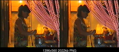

just for fun:
QTGMC+AutoWhite+SpotLess+Small_Deflicker+Crop+Bala nceBorders+CAS+MCTemporalDenoise+AddGrain. (VapourSnyth script)
(replacing broken frames with interpolated one might still be a good idea)
Cu Selurusers currently on my ignore list: deadrats, Stears555, marcorocchini -

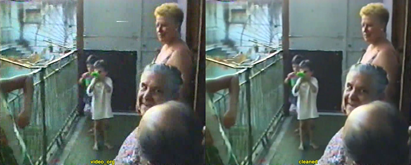

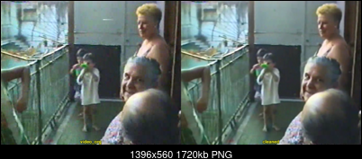

You are in good hands with Selur support, but let's continue step-by-step the restoration process.
After deinterlacing and interpolation of bad frames, you can apply SpotLess (it needs MVTools and MedianBlur2 dependencies to run) to remove the comets and other defects (a_1.avs opened at the beginning is the previuos script):
Some sample:Code:video_org=AviSource("a_1.avs") ### cleaning cleaned=video_org.SpotLess(BlkSz=12, OLap=8/2, pel=2, Tm=false, Bblur=0.0, ThSAD=1000, RadT=3) /* stackhorizontal(\ subtitle(video_org,"video_org",size=20,align=2),\ subtitle(cleaned,"cleaned",size=20,align=2)\ ) */ return(cleaned)
SpotLess (and all similar filters) is destructive so use it with caution and play with its parameters for best results, in particolar RadT for the temporal radius of the frame repair and ThSAD), and may be apply it only to concerned segments of the video.
If you feel confortable, then we can later address denoise/degrain.
edit: for a major defect like in frame 1288 of the original source SpotLess is not enough, you can either replace this frame by interpolation or apply FixRipsp2 as in this example: https://forum.videohelp.com/threads/403553-Restoring-VHS-Tapes-with-Damage-(White-Hori...n)#post2635329 (again, a very destructive filter, so apply it with caution)
Last edited by lollo; 6th Dec 2025 at 12:22. Reason: added info to process difficult bad frames

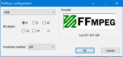

In addition to Prefetch setting, the only way to deeply increase the speed is to split the script in two.

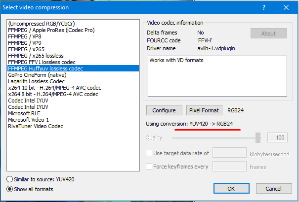

1- create script1.avs
2- open it in VirtualDub and create the output "script1.avi" compressing with HuffYUV (lossless)Code:FmpegSource2("VTS_01_1.VOB") # cropping crop_left=12 # | rimozione esatta delle bande nere sinistra, sopra, destra e del disturbo sotto crop_top=4 # | 720-(12+10)x576-(4+12)=698x560 crop_right=10 crop_bottom=12 Crop(crop_left,crop_top,-crop_right,-crop_bottom) ### repair bad frames 4-5, 1288, 5862-5863, 5876-5877 interpolate_2frames(frame_number=4) interpolate_1frame(frame_number=1288) interpolate_2frames(frame_number=5862) interpolate_2frames(frame_number=5876) ### de-interlacing AssumeTFF() QTGMC(preset="slow", matchpreset="slow", matchpreset2="slow", sourcematch=3, tr1=2, tr2=1, NoiseTR=2, sharpness=0.1) ### cleaning SpotLess(BlkSz=12, OLap=8/2, pel=2, Tm=false, Bblur=0.0, ThSAD=1000, RadT=3)
3- create script2.avs
4- generate the final output of fed this script to ffmpeg for encodingCode:AvoSource("script1.avi") # cropping crop_left=12 # | rimozione esatta delle bande nere sinistra, sopra, destra e del disturbo sotto crop_top=4 # | 720-(12+10)x576-(4+12)=698x560 crop_right=10 crop_bottom=12 ### denoising TemporalDegrain2(degrainTR=3) ### change color matrix Colormatrix("Rec.601->Rec.709") ### add borders addborders((crop_left+crop_right)/2-1,(crop_top+crop_bottom)/2,(crop_left+crop_right)/2+1,(crop_top+crop_bottom)/2) ### upscale nnedi3_rpow2(rfactor=2, nns=4, qual=2, cshift="Spline36Resize", fwidth=1440, fheight=1080) ### sharpening LSFmod(defaults="slow")
This flow generates an additional temporary file (script1.avi) with consequent disk occupancy, which can be removed at the end of the processing.

Here is my ffmpeg bat, is it ok or should I edit it for YouTube?
Is it possible to do everything with ffmpeg or VirtualDub2 or is it better to use both?Code:ffmpeg -i "script2.avs" -c:v hevc_nvenc -preset slow -rc vbr -cq 19 -b:v 0 -pix_fmt yuv420p 01.mp4
Do the black borders have a function or can I remove them?
Better LSFmod or CAS in my case?
Will audio be included in the video?Last edited by Angy86; 9th Dec 2025 at 03:28.
I never used FFMpeg HuffYUV, so I cannot help; the error message suggests that the colorspace in the script1.avi file (input to script 2) is not "standard YUV"; check its properties.
DAR (or SAR) flag addition is missing. I use a simpler:
Your choice.Code:ffmpeg.exe -i <script>.avs -c:v libx264 -crf 17 -preset slow -aspect 4:3 -c:a aac -b:a 128k <output_file>.mp4
Yes, they keep the right proportions. You can remove them and specify the SAR instead of the DAR, but not all players/devices are able to consider that flag.
In general CAS is less effective than LSFmod and introduces more artifacts. But always experiment with your material, I did not try it.
Yes. -

I also tried adjusting the levels slightly to get a more pronounced look, is this bad for the quality or does it have no impact?Code:ffmpeg.exe -i script2.avs -c:v libx264 -crf 17 -preset slow -aspect 4:3 -c:a aac -b:a 128k ok.mp4
https://imgsli.com/NDMzNDkyCode:Levels(0, 1, 235, -15, 255, coring=false)
