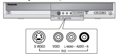

Use the S-Video IN2 on the front (IN2 aka AV3) of the ES10 and select it accordingly in the settings menu.
[Attachment 89983 - Click to enlarge]Last edited by Sharc; 29th Nov 2025 at 03:40. Reason: picture added
Hi, already did this. Also used a Scart to S-VHS adapter. For some time it seems to work with luck for some minutes but then after some minutes the signal is gone and you do not get it back. I opened the Recorder and saw some capacitors broken on the Power Supply part of the board. I will try to fix this, but I do not think that they have something to do with my S-Video signal?
Looks like you should replace all electrolytic capacitors, or look for another ES-10 or ES-15, or equivalent.
