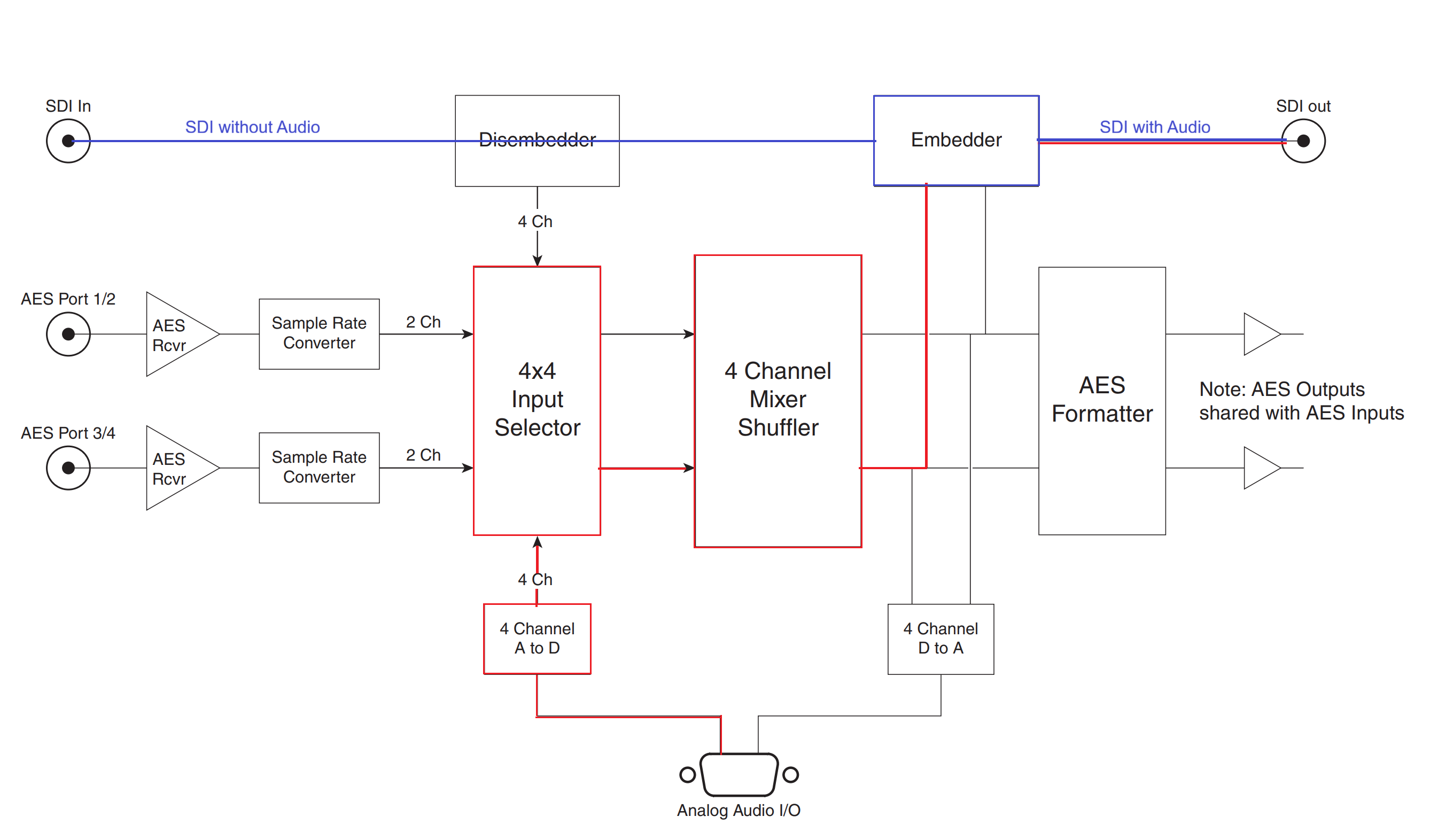

    Here is a block diagram on how the BE20 embeds analog audio into an SDI digital stream, I altered it to show how the analog audio is digitized and embedded into the SDI stream:
