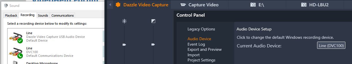

    Using the black dazzle, I can get a picture in Pinn Studio for Dazzle 23.2.4 and record it, but on playback on the computer there is no sound
    The drop down menu to choose Composite or S-Video import only gets a signal on S-Video - even though only the white, red and yellow leads are connected to the camera and Dazzle ????
    Here is the Audio input:
    [Attachment 89842 - Click to enlarge]

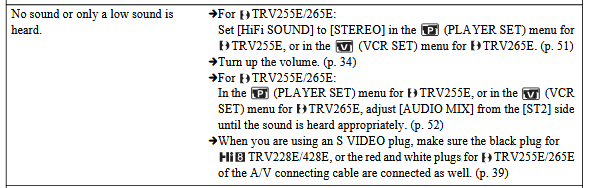

    Edit: Your sound issue, from the SONY manual:
    [Attachment 89912 - Click to enlarge]
