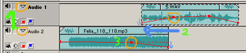

Audio fade in/out:
Drop down the audio track.
Make the two audio files cross each other.
Click on the red line to make “stops” and then just drag the line as abrupt as you want the audio to tone down.

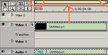

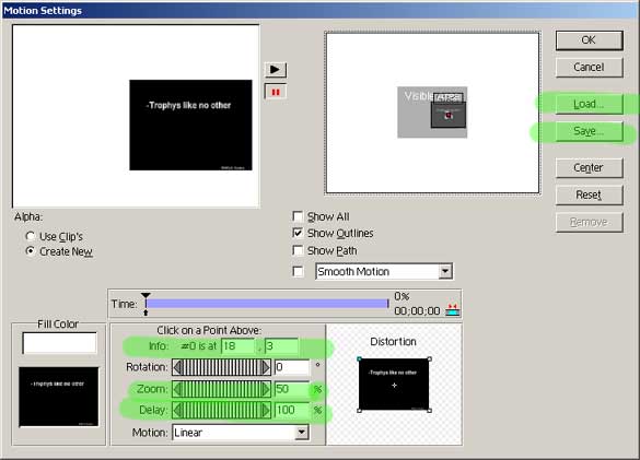

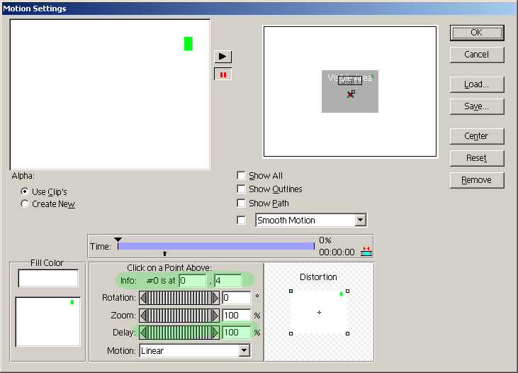

Make the text roll:
Mark the clip you want to roll. Then choose Clip-> Video Options->Motion
Set the start point under the visible area (inside the red line) and the end above.
If you press the play button you’ll see an example on how it will look like (inside the green). But the speed isn’t correct that you see in that window, it’s much faster.
Note! To see the correct result you must render the area and see it in the preview window. You adjust the speed by making the clip longer or shorter.

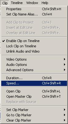

Reverse:
Mark the clip you want backwards.
Go to Clip->Speed
Type -100 in the box
Note! You have to render the clip to see the correct resulat. The renderarea is the area between the yellow line. You adjust the area by draging the grey buttons in the end of the yellow line. Too start the rendering just press enter. Everything inside the red line under the area must be rendered to see the correct result.

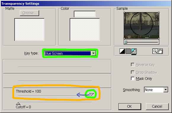

Blue/Greenscreen
Put the video you want to cut away the background on in the video 2 line. The movie that you want to use as background you put in the video 1 line.
Mark the clip in video 2 and go to the effect controls (Clip-> Video options-> Transparancy) and choose transparancy.
Change the key type to bluescreen or greenscreen dependent on if your background is green or blue.
Adjust the thresholds byt draging the pointer. This you do if there is colors still left in the background that you want to cut off, maybe the background got diffrent blue tint. Of course this can make trouble like cut off from the picture you want to have left.. you’ve got to adjust carefully.
Press ok and render the area and see if it looks good.

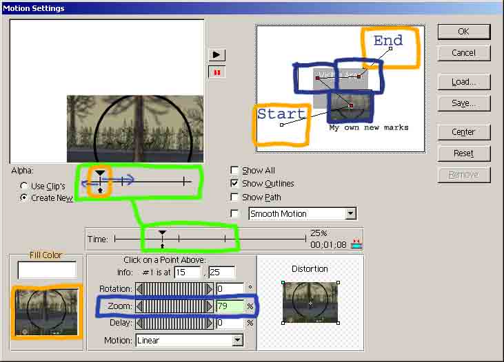

Make you fly!
First you have to make the movements then add the background. Mark the clip and go to the motion section, Clip-> Video options-> Motion
You see the start and end marks, drag the start point where you like to have the movement starting and the end where it will stop.
After done that you maybe not want the movement just to go straig from start to end. Then you point on the line between start and end and a new mark will be done, just drag the new mark where you like it.
It’s kind of borring if the picture isn’t seem’s to go further and closer. To fix that you can use the zoom function. Choose one mark where you like the clip to be zoomed out/in. Then the motion function automatacly zoom the picture while it’s moving.
When you have done the marks it also has been marks in the timeline. It’s because if you don’t like the time when the picture is in the mark, so if you liked the picture to be zoomed after 10sec, just drag the mark where you are zoom settings are to the time where you like to have it.
Now there is one big “bug” in premiere, I realy hate it. When you are zooming out the clip it will be a black line just above the picture you’ve been filming. I only got one solution to that and it’s to make sure you never show the whole picture when it’s zoomed out, you have to place the black line outside the visible area. Keep that in mind when you act in the film.
Set the fill color as the same as your backgroundcolor that you are planing to cut away. You get the same color by pressing on the picture below the fill color text, you see a small sample of you picture there, just press on the background.

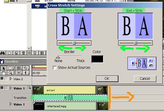

Simple split screen
Set the clip on video 1a and b, then add the transition “Cross strecht” in the transition track. You can use the find function to find the transition, just search on Cross strecht.
Double click on the transition icon and choose start at 50% and end at 50%. To make the split screen longer just drag the clip to the right and the transition icon too. Now just render the area and you will see the result.

Now select the other clip and go to Clip->Video options->Motion and load your previous settings, it will place the clip in the same position and size, so now there is only one change you have to do and that is to change the position. In the top of the same box as the zoom slider there are two entries, where you can adjust the position. The right box is your vertical setting and the left your horizontal. If your number is -18 then change it to 18 or if it is 18 make it -18.

2. Use the motion function (Clip->Video Options->Motion). Set the delay to 100% and then adjust the start and end point in to the right position.

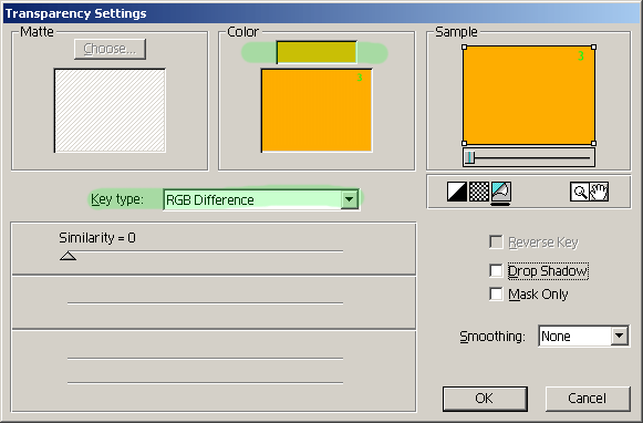

3. If your picture where the logo is isn't transparant you need to use the transparancy function. Mark your picture and go to Clip->Video Options->Transparency.
Choose RGB Difference and then choose the color you want to remove.

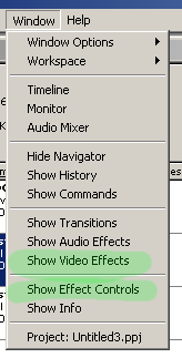

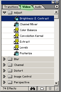

Add video effects
1. Go to the Window menu and click on Show Video. If it stands Hide Video the video effect map already is open. Drag the effect you like to use on to the clip.
2. Now click on the clip where you have droped the effect on. Go to the Window menu again and choose Show Effect control.
Now you will see the settings for the effect. For example if you have taken the brightnees effect you can adjust the strength of the brightness.
You want notice any diffrent before you change the settings because it is on 0.0 when you add it. So just drag the bar to the left or right.
If you want to see what happens with the clip in the preview window while you are adjusting the brightness you need to have the time bar in the position where the clip is.
Remeber that the f must be selected in the littel window in the effect control menu, else the effect want effect the clip.
Render the area and you are done!

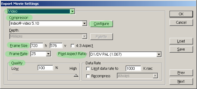

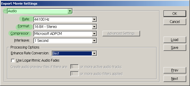

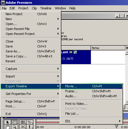

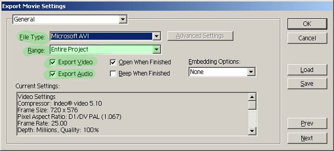

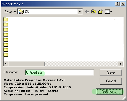

Export movie
1. File->Export Timeline->MOvie
2. Press the settings button.
3. Choose the file type that you want to export the movie in. Remeber to check so the Export range is set to "Entire project", export video, audio is selected. To get to the video settings press the next button or scroll down in the general box.
4. Here you choose what codec you want to compress the film in and what quality you would like to have (resulotion, fps and so on). The configure button beside the codec is the button to press if you like to configure the codec you will use. The things markt with green is the most importent things to adjust. Now press the next button or scroll in the general box to get to the audio settings.
5. Set the settings as you like. The things markt with green is the most importent things to adjust.
If you wonder what settings to use, you shall ask the great members on the forum and not meI'm not into codec and stuffs. The settings you see on the pictures are those settings I use when a export my dv clips. You got a great quality with these settings but in a big avi file that you cant play on the dvd-player. So after I have export the film into this I convert it to a mpg with tmpgenc. Read this guide for that: http://www.vcdhelp.com/convert
