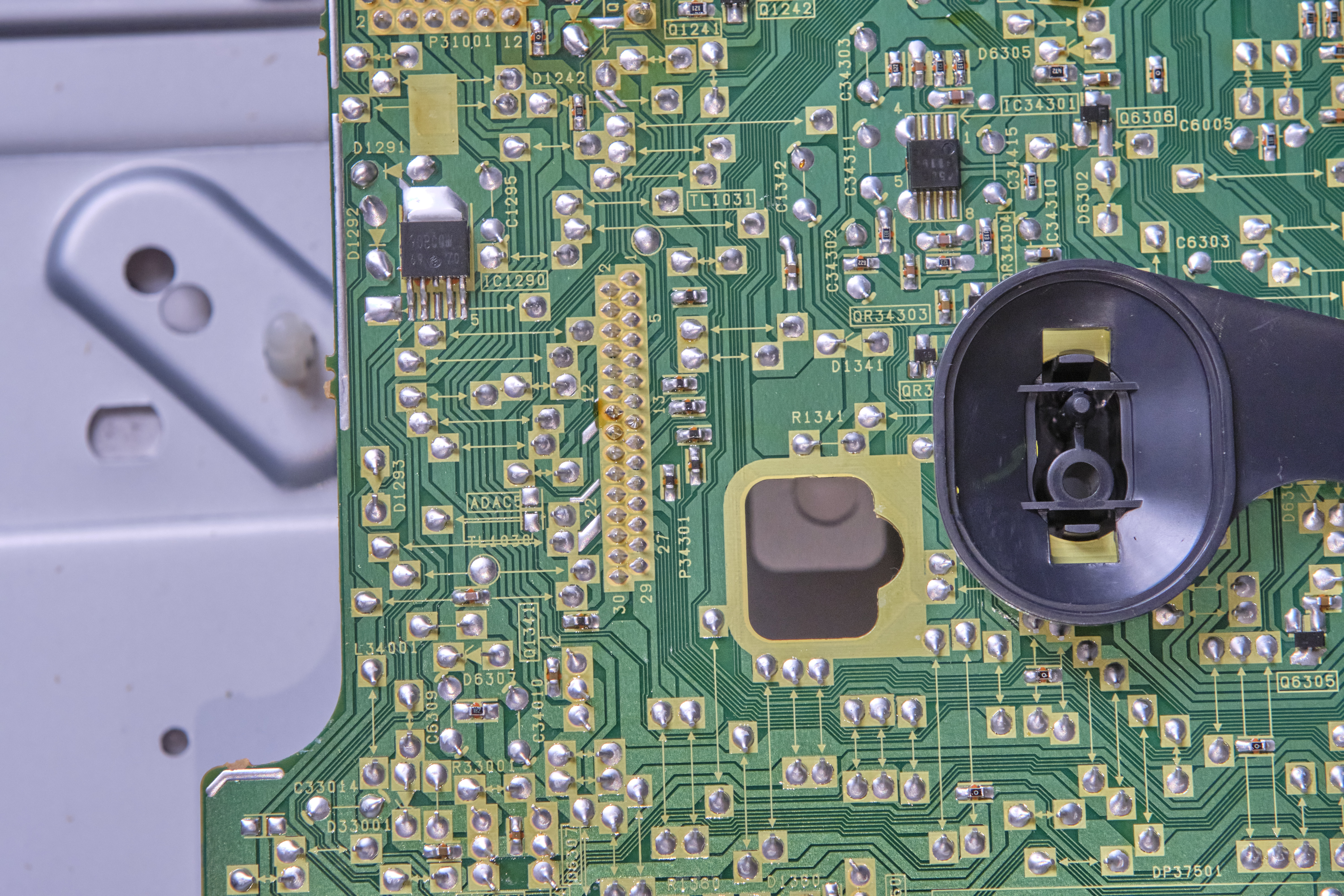

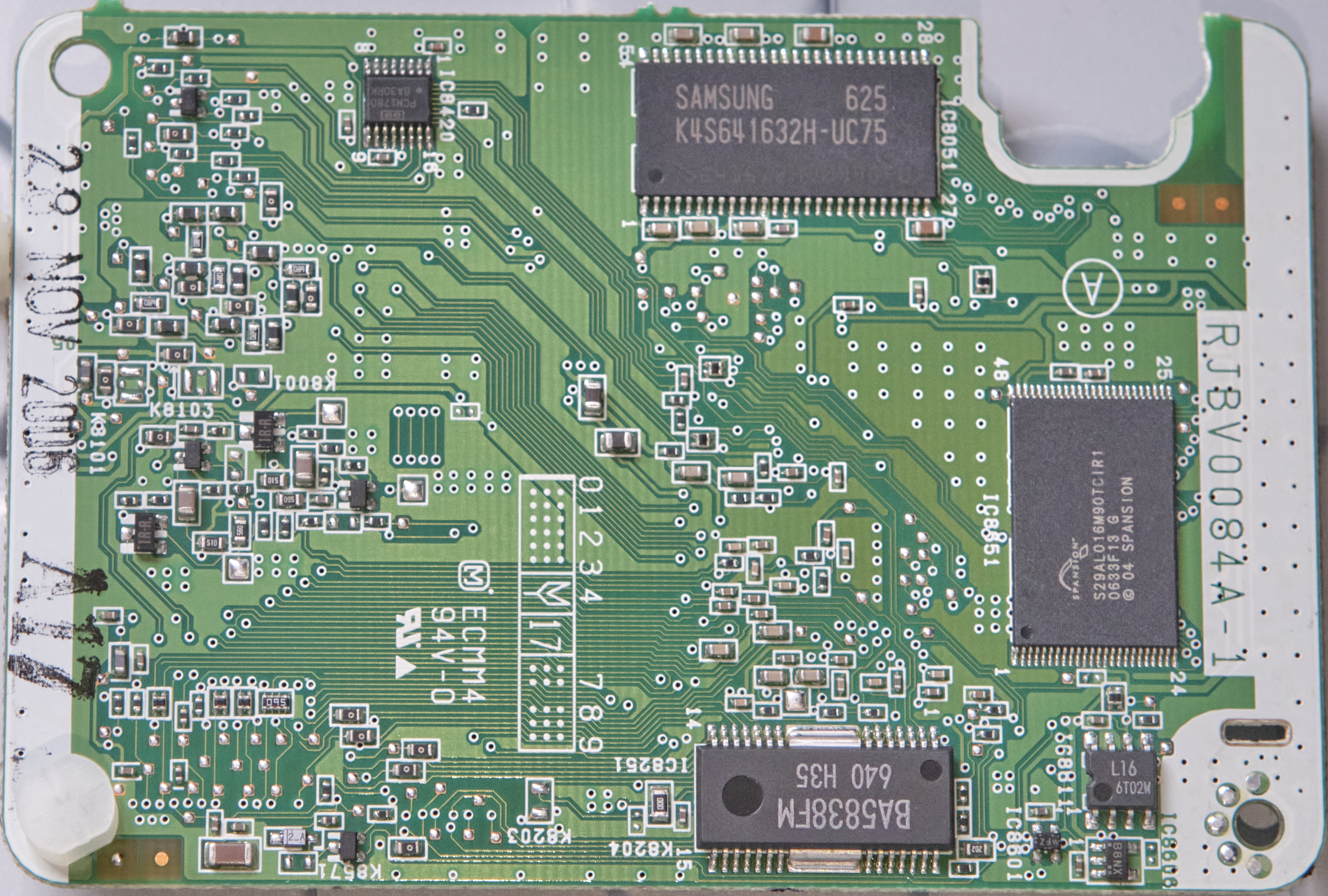

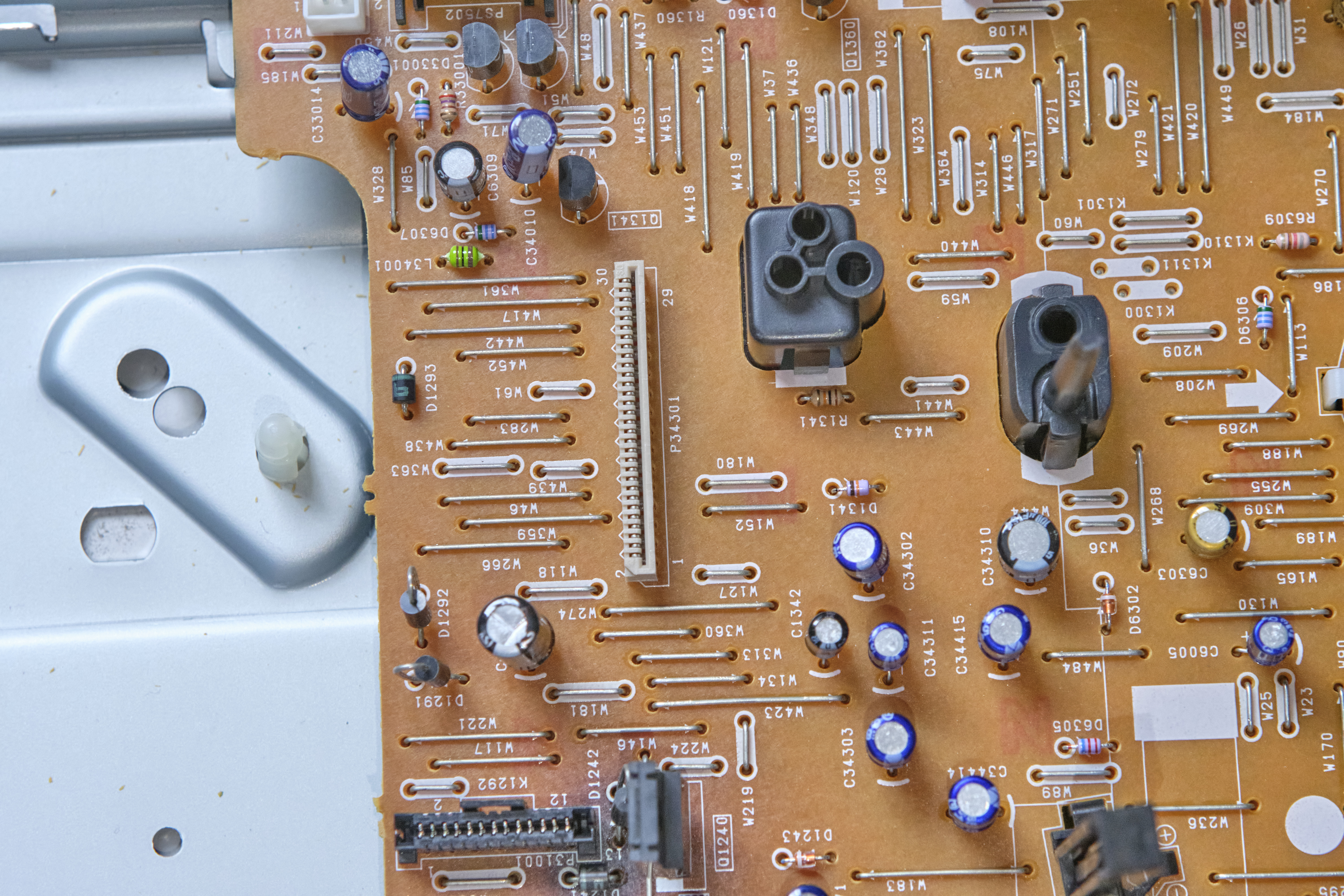

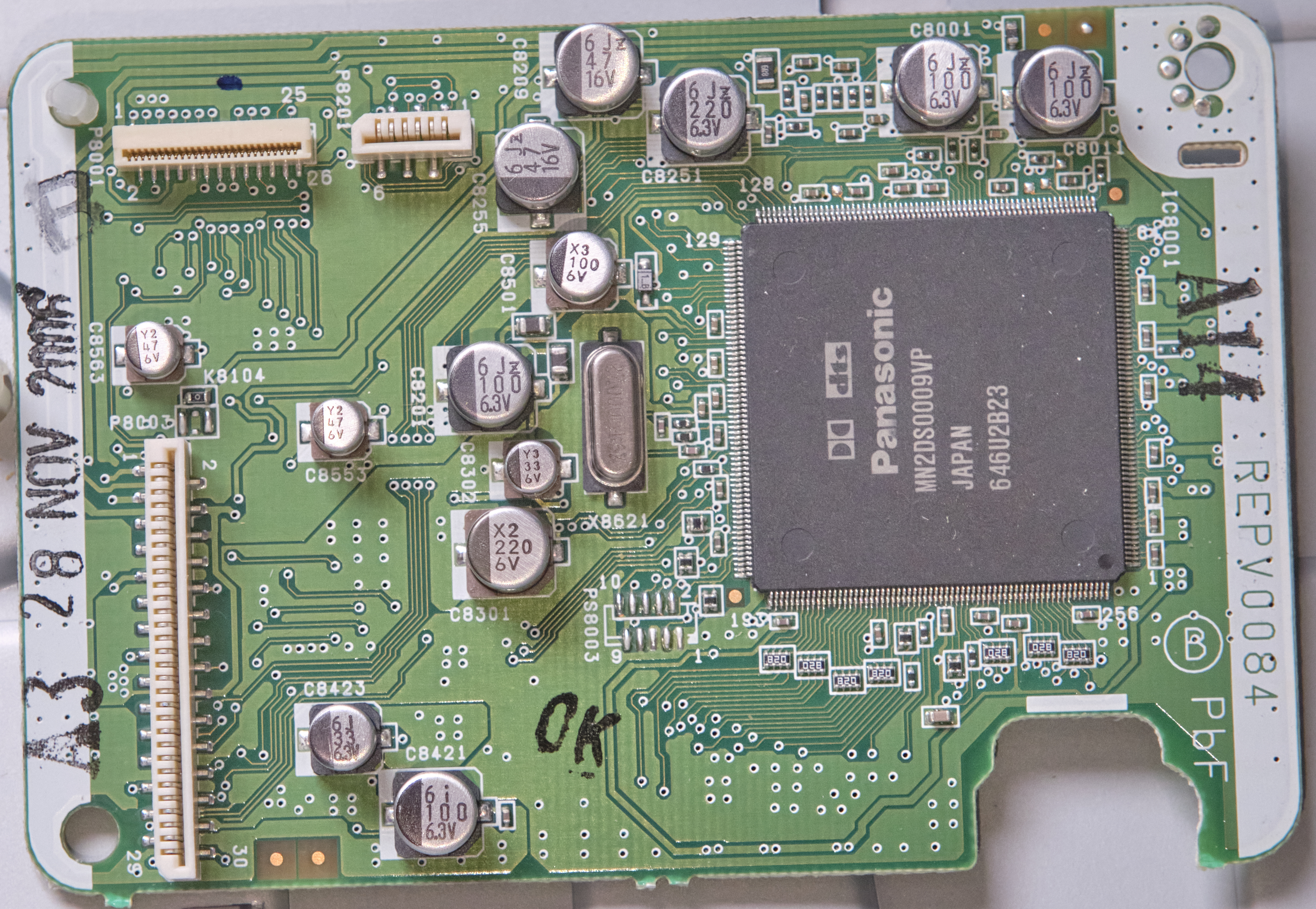

    I am Working on an S-Video mod for a Panasonic NV-VP60GN.
    As you may know this model comes with an S-Video but because Panasonic decided to be cheap it only shows video from the DVD through the S-Video.
    However looking at the service manual it seems that the VCR sends pre-separated Y/C to the DVD board (for dubbing feature purposes?), going through the ribbon cable to the DVD board (Small board).
    Does anyone have any advise for how I should go about finding which lines in the ribbon cable are the Y/C signals?
    I have attached some pictures of the boards.
    Cheers

  3. As I see it
    Y: PIN 11 of socket P34301 on the main board -> socket P8003 on the DVD board
    C: PIN 13 of socket P34301on the main board -> socket P8003 on the DVD board
