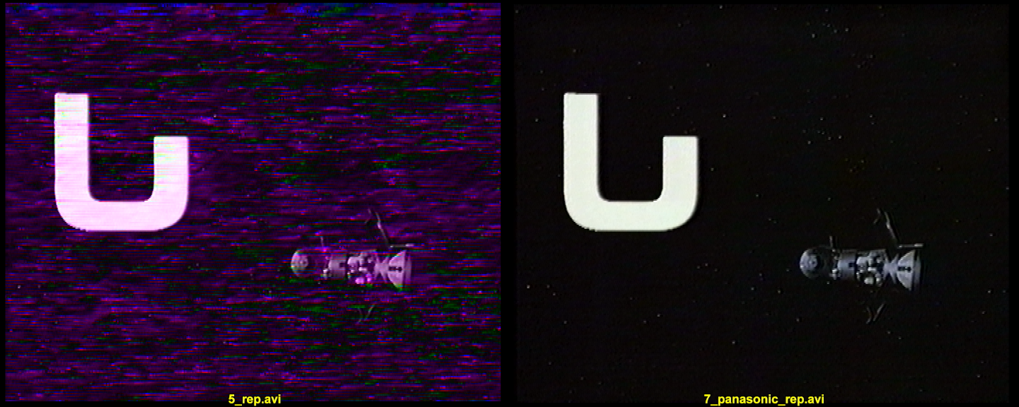

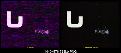

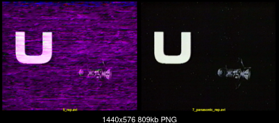

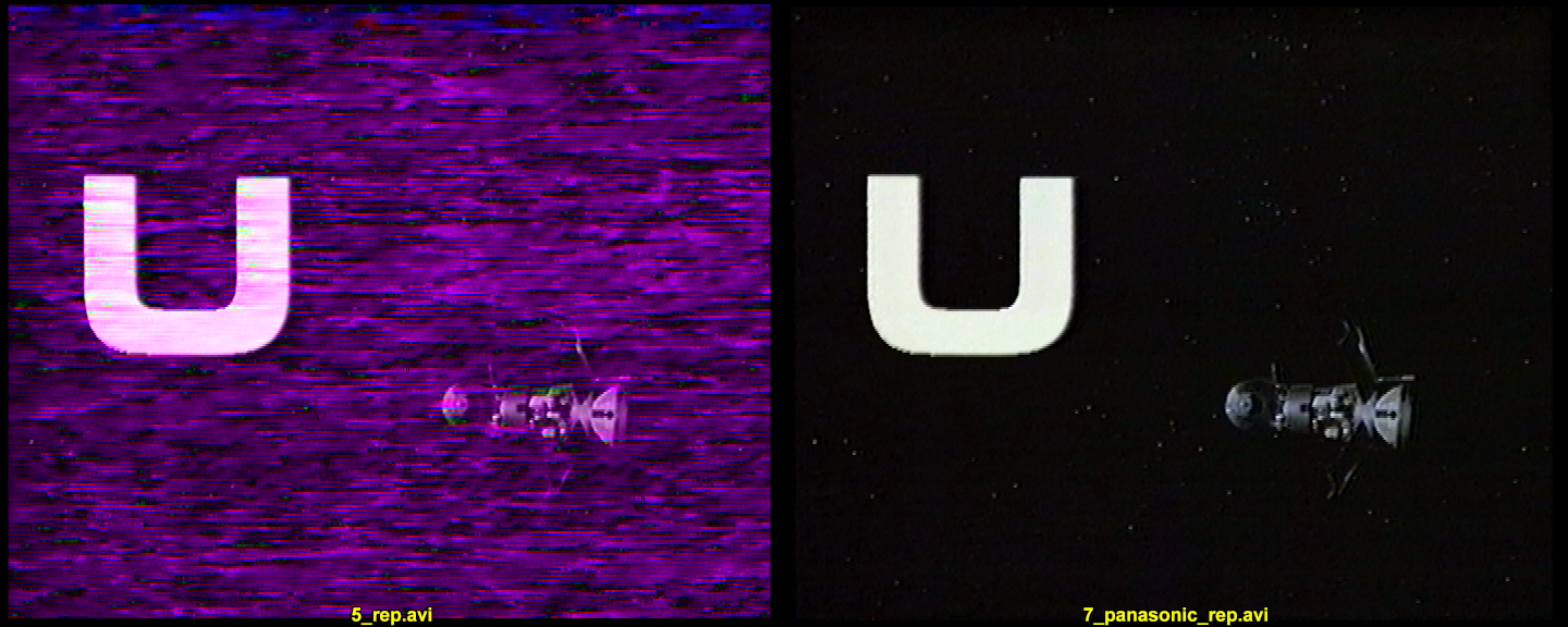

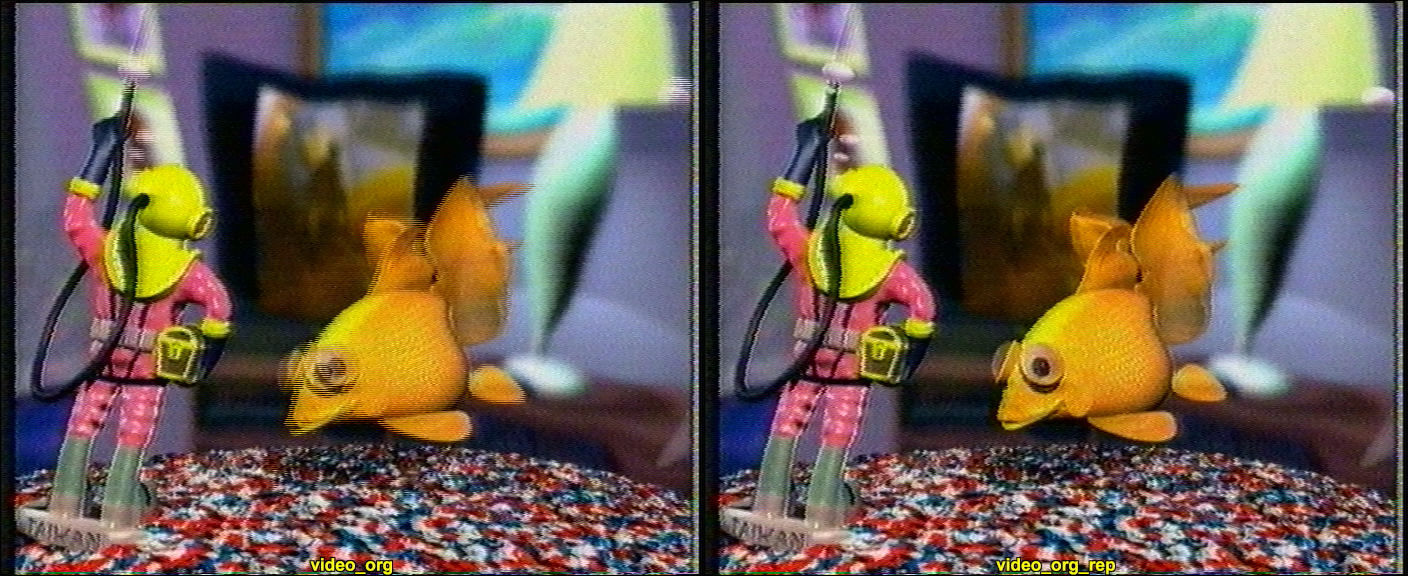

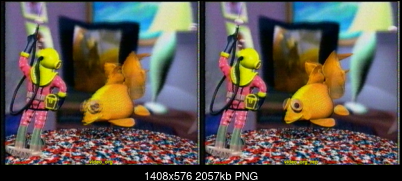

    For some reason I can still see filed blending in your sample, someone can correct me if I'm wrong.
    I do not see field contamination in Recapture.avi. But each field is very low quality and their timing architecture is weird, as Sharc alreay pointed out.
    Is not a simple (constant) phase shift because a DoubleWeave().SelectOdd() does not fix the video. It must be some dynamic phase shift, embedded in the tape or introduced by a faulty device.
    It can be fixed with a field matching operation, here a comparison comp.avi. But OP should solve his capture issue first.
    video_org=AviSource("Recapture.avi")
    #video_org_rep=video_org.DoubleWeave().SelectOdd()
    video_org_rep=video_org.TFM(order=1, mode=0, PP=0, slow=2, field=1)
    stackhorizontal(\
    subtitle(video_org,"video_org",size=20,align=2),\
    subtitle(video_org_rep,"video_org_rep",size=20,align=2)\
  2. Yes, 25p content was broadcast BFF but captured TFF. It can also be made progressive again with something like:
    AssumeTFF()
    SeparateFields()
    Trim(1,0)
    Weave()
    Though this has the same problem as DoubleWeave().SelectOdd(). The filter chain gets confused because there are an odd number of fields left after removing the first field. If you work linearly from start to end there's no problem. But if you go to the end and step backward the filtering gets messed up.
    On the other hand, TFM() can sometimes mismatch or deinterlace inappropriately.

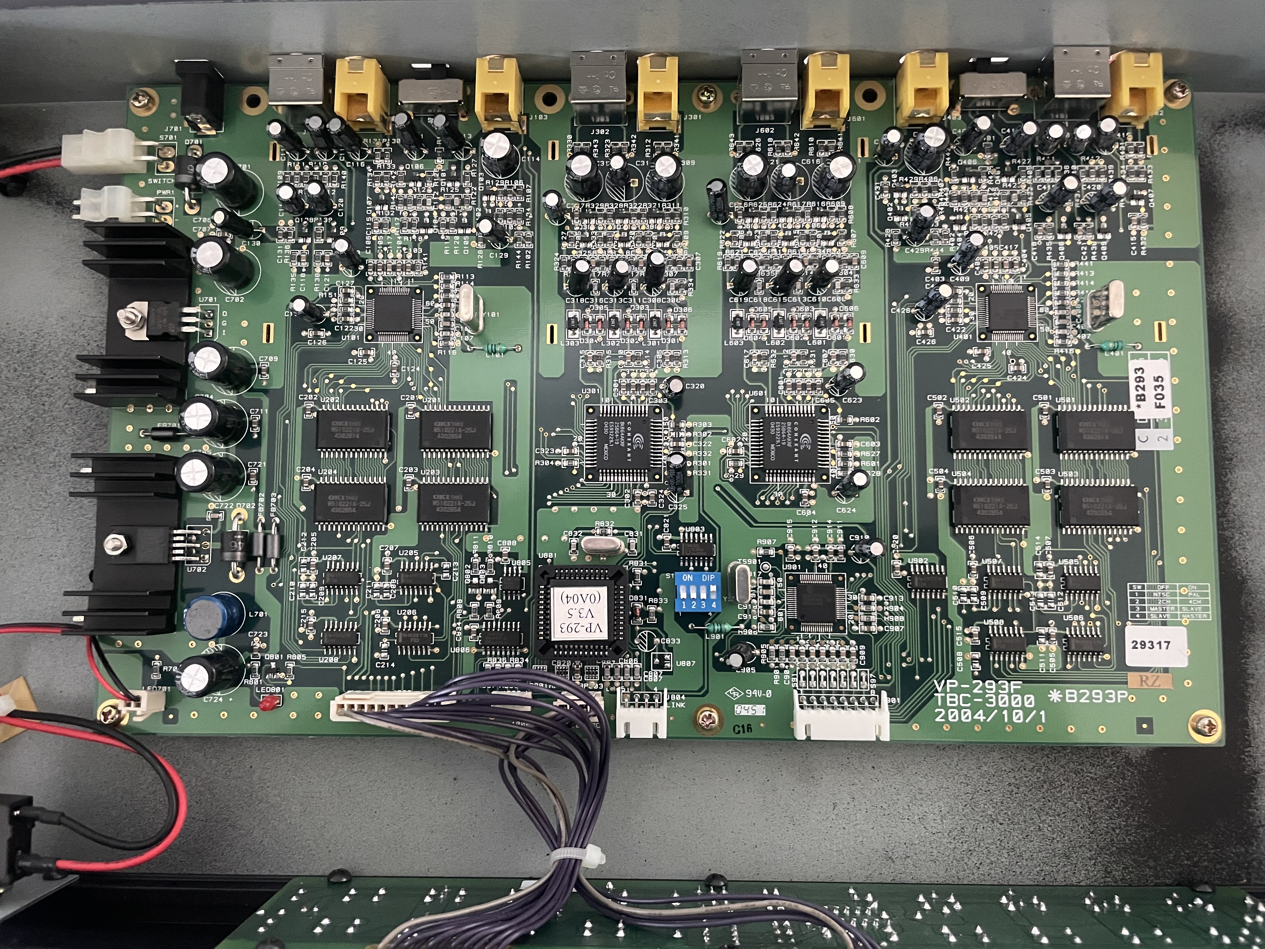

    Jun 2024
    The one i saw was a European model apparently. Slightly different layout on the front as it doesn't have the Tint buttons. One of the later models anyway
    You saw one that had 2004 on it that was PAL? I’m pretty sure you just saw a board image of mine. I haven’t heard of anyone else having one that was made that late.Image
    [Attachment 89878 - Click to enlarge]

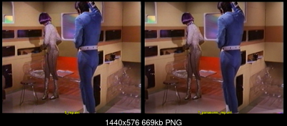

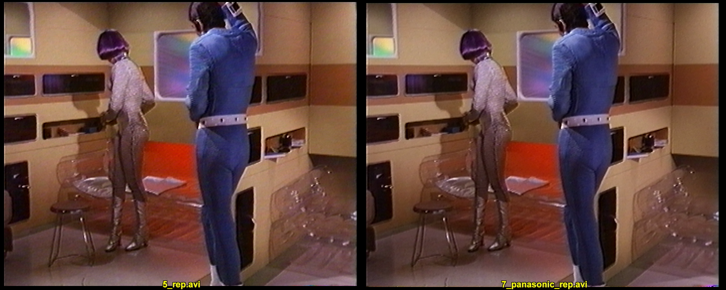

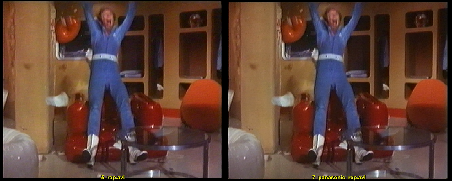

    Better, here a comparison between a problematic VHS tape (not S-VHS, to better appreciate the outcomes) captures with a convential workflow (Panasonic VCR (not a JVC VCR, to have a less smooth picture) + Hauppauge USB-Live 2) versus an enhaced workflow (same Panasonic VCR + Panasonic ES15 + same Hauppauge USB-Live 2). (The tape is problematic because all the even fields are damaged, so they have been replaced with a copy of the odd fields in post, but that's another story.)
    Comparison of the two captures (compressed to h264 crf 17 to be able to upload): compare.mp4
    Frame comparison with slider: https://imgsli.com/NDMxNjI1 (also note has ES15 has straighten the vertical lines)

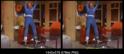

    Frame comparison: https://imgsli.com/NDMxNjI2
    Now you tell me your conclusions.
    Also note how the ES15 was able to fix a couple of problematic frames:
    P.S.: about h264 encoding you problably ignore that it can compress loss less (I would never use it anyhow)
    edit: CaptureCraft arrived first about h264
