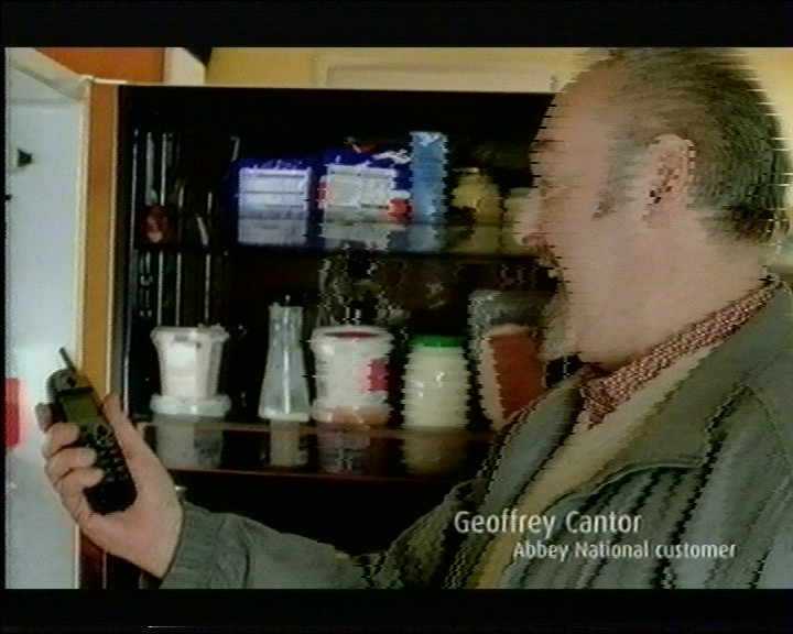

  1. I've been using a 2TB hard drive to capture my tapes for a while, and some files/folders have been stored on there for a few years now. Originally i just used this hard drive for additional storage for some stuff and for whatever reason never transferred the files off it. And capture with the remaining space.
    Could doing this cause any artifacts with your captures? As for a while now i've been having this combing lines artifact (i'm guessing duplicated fields) appearing on my captures at random intervals, could happen a couple of times per tape, or once if im lucky.
    [Attachment 89798 - Click to enlarge]
  2. No.
    And why does the picture fill only about 496 lines of the 576 frame? Something is resizing an interlaced video improperly.
    Because it was recorded on analogue tv when it started broadcasting in 14:9 during it's latter years.
    To troubleshoot further i wonder if it's anything to do with my settings in Virtualdub. Is capturing with a lossless codec like Huffyuv v2.1.1 on a Windows XP era PC fine, or will it be adding extra work for the CPU?

    Is that still image of an interlaced AVI playing in VLC? Try setting the deinterlacing to ON (Video>Deinterlacing>ON) or post a snippet here for the members to take a look at.
  6. Originally Posted by Alwyn View Post
    Yes it is from VLC and is set to deinterlacing.

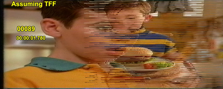

  15. To me it looks like intermittent TBC failures/TBC processing artifacts.
    @MasterTape: Disable the TBC in your setup (and accept some flagging): Do you still get these artifacts?
    [Attachment 89841 - Click to enlarge]

    I checked your videos. It looks like you get some lines from the next half-frame.
    You need to eliminate devices from you chain on-by-one until you will have just the capture card.
    If that not gonna help, then you have to consider to change your capture card. Buy EZcap just for the sake of testing.
  17. I agree with Sharc, the TBC's dropout compensation is kicking in on the bad frames.

    Panasonic NV-HS860 > DataVideo TBC-3000 > ATI All-In-Wonder 9600 Pro. Capturing it on Virtualdub lossless AVI with Huffyuv codec. It's on a legacy PC running Windows XP for the purpose of the capture card.
    The TBC inside my VCR or my external TBC?
