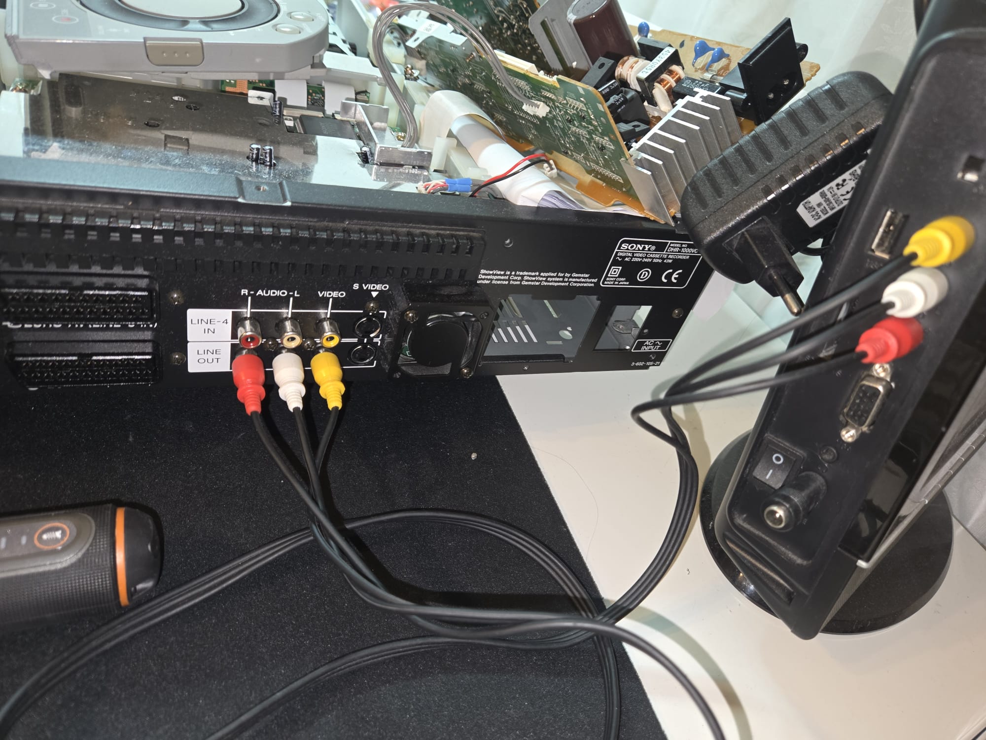

    @johnmeyer
    The deck video output is connected directly to TV, via RCA, as shown in the video. There is no device in between them.
    I don't really do video tape digitization.
    I want to be able to watch video tapes directly on my TV.
    If I need to digitize any, I will obviously use Firewire.
    But in everyday life, Firewire is not an option because I have to connect the device to a computer, which is an inconvenient for me most of the time.
  13. I didn't ask about the video output. I was asking about the audio, which I thought was the subject of the post. You posted an MP4 that contains audio and my question was intended to find out what input you used on the device which created that MP4. The purpose of my question was to find out if you somehow connected the analog audio output from your DV deck into a microphone input on the device on which you are viewing the video & audio. If you are watching these tapes on a computer, especially a laptop, most of them made in the last twenty years no longer have a "line level" (1V P-P) input and only have a microphone input. I think some have a circuit which detects line level and then inserts an attenuator, but I don't think that feature is universal.
    If you connect line level audio to an input which can only handle tiny little microphone signals, you will overload that input, and the audio will sound almost exactly like the audio that you posted.
    Feb 2021
    Romania
    The device that created the MP4 was my phone. I used it to record the screen. There was no other device between the deck and the TV.
  15. Originally Posted by jonnybravo View Post
    You did not answer my question. The question you need to answer, in order to fix your problem, is this: what is the label on the input into which the AUDIO cable from your DV deck plugs into??
    If you recorded the MP4 using your phone, you were recording a screen and its audio. Was this screen a TV set or a computer? Did you plug the audio from your DV deck into a microphone input??
    The audio in the mp4 is distorted but in a particular way. It's not a compressed sound but an expanded sound. It's basically gating, like old fashioned crossover distortion. If it was signal overload the signal would be clipped and unable to go louder on the voice. But it does get louder on the voice.
    Sounds like a faulty amplifier. It's possible this was caused by initially running the too strong signal such as a line output into a sensitive microphone preamp and damaging the preamp.

  21. Capturing Memories dellsam34's Avatar
    Jan 2016
    Try testing the audio out of the RCA jacks, if it is distorted then it's the DV deck, If not then it's your capture card or whatever that black box is.
  22. Member
    Feb 2021
    Romania
    The black box is a TV monitor.
  23. Capturing Memories dellsam34's Avatar
    Jan 2016
    Did you try something else? like an audio amp or headphones even if the level is low it will give you an idea if there is distortion.
  24. Your picture shows that my idea (that you put line output into a mic input) is wrong.
    Dellsam34's suggestion to connect headphones directly to the line audio output from the deck is a good idea. Ideally you should use a 3.5mm to RCA cable to connect to the same audio output jacks you show in your picture. However, this deck has a headphone jack so a quick check is to simply connect the headphones there. If the audio is distorted, then you've proved it's the deck. If it isn't distorted it is still possible that there is something wrong in the output to the line level output that isn't a problem for the headphone jack, although that is pretty unlikely.
    Given that you've done a lot of work on this deck, it seems very likely that one of the audio circuits got damaged, or perhaps did not get repaired. You said that you replaced a HUGE number of capacitors. It would only take one mistake of installing an electrolytic capacitor backwards to cause a problem. Also, you said that a very large number of capacitors had started to leak. I've recapped a lot of power supplies and also, occasionally, the caps in the power output stages of audio amplifiers. I almost never replace ALL the capacitors, and instead start by testing each one while still in circuit. If they test OK, I don't replace them, at least not initially. If they don't test OK, then I put a mark on them, but continue until I've tested all caps while still wired into the board. I then note how they look. In my experience, unless there is electrolyte oozing all over the board, I don't get too carried away by appearance.
    Then, when I've decided which caps to replace, I remove each cap one at a time. Before I do anything further, I give it a complete test. If it tests OK, I put it back in circuit. I know that some people would not do this, and advise that ALL caps need to be replaced because they think they'll go bad eventually. I won't argue against this because, if you know what you're doing and if you have the time, and if you know how to get the correct capacitors for how they are used in the particular circuit (i.e., capacitance, voltage, ESR), then this is certainly the "ultimate" way to do a restoration.
    But, now that I have gotten old, I appreciate the problem of how easy it is to make a mistake, and the more capacitors you replace, the easier it is to make a mistake, not only because you're replacing so many, but also because it is tough to keep your concentration while repeating basically the same operation over 100 times. This is especially true if you ever remove more than one capacitor at a time.
