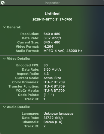

    About 30 mins later...
    Okay, wow. Got the blue QT screen up and I’m ready to try some digitizing. I have not removed the hard drives from the dock, and I do not yet have that adaptor to bypass that whole chain. I do, however, want to see if there’s any difference doing things this way...
    About 10 mins later...
    So far, so good -- except that I am not getting audio-out while recording. Trying to determine why. Otherwise, for ~5 mins, it went well (though the only real test is going to be with a 2-hr tape).
