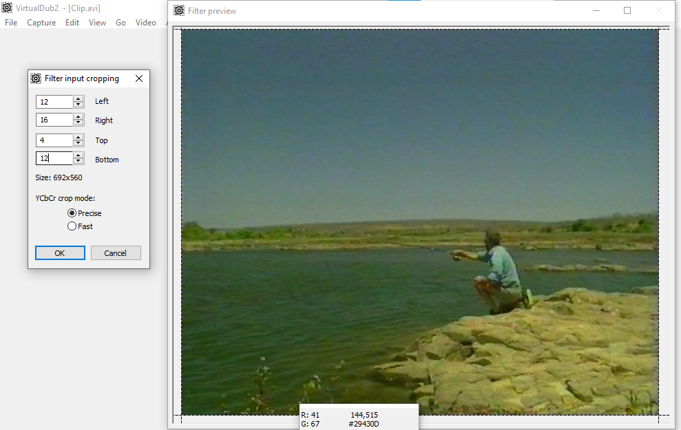

    I followed the steps shown in that thread and did some tests with clips from that thread and used the settings in VirtualDub2.

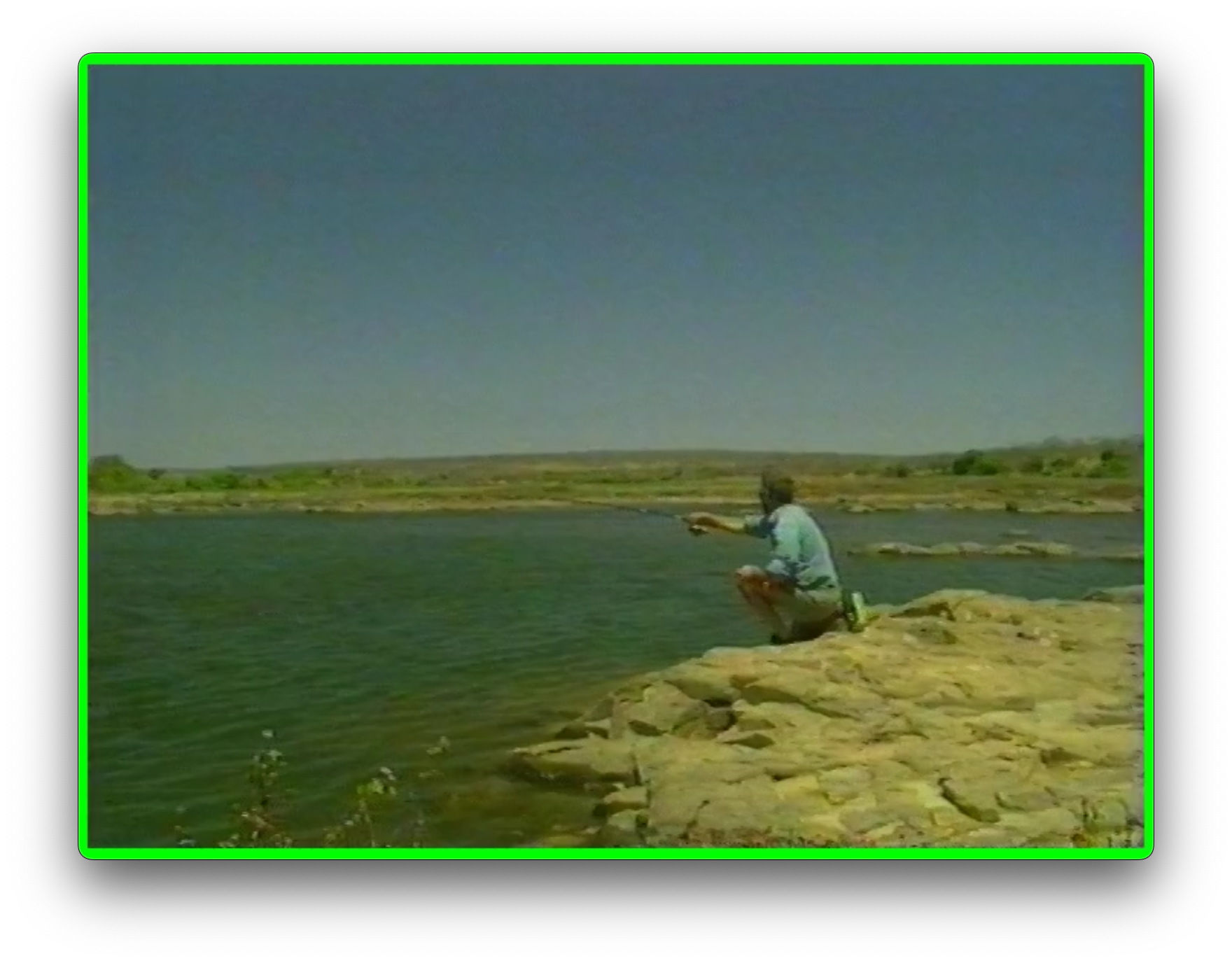

    The basic issue I see (and I mean literally) is that when setting SAR=12:11, the out is stretch compared to SAR=1:1
    E.g. SAR=1:1:
    [Attachment 89574 - Click to enlarge]
    with SAR=12:11:
    [Attachment 89575 - Click to enlarge]
    (the green padding colour was my choice to see padded areas)
    Now when played back, on a UHD TV, one cannot really tell the difference with people in the content but potentially can with objects.

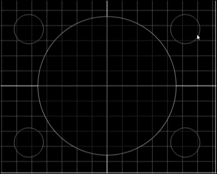

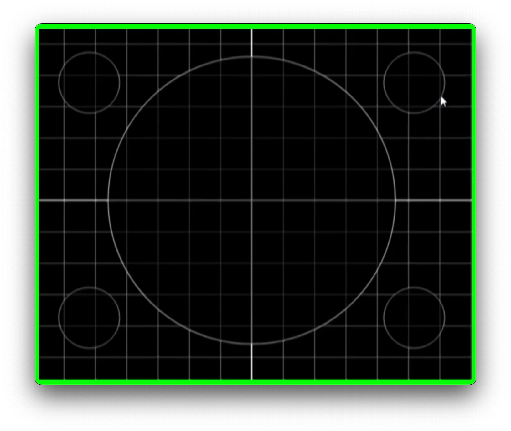

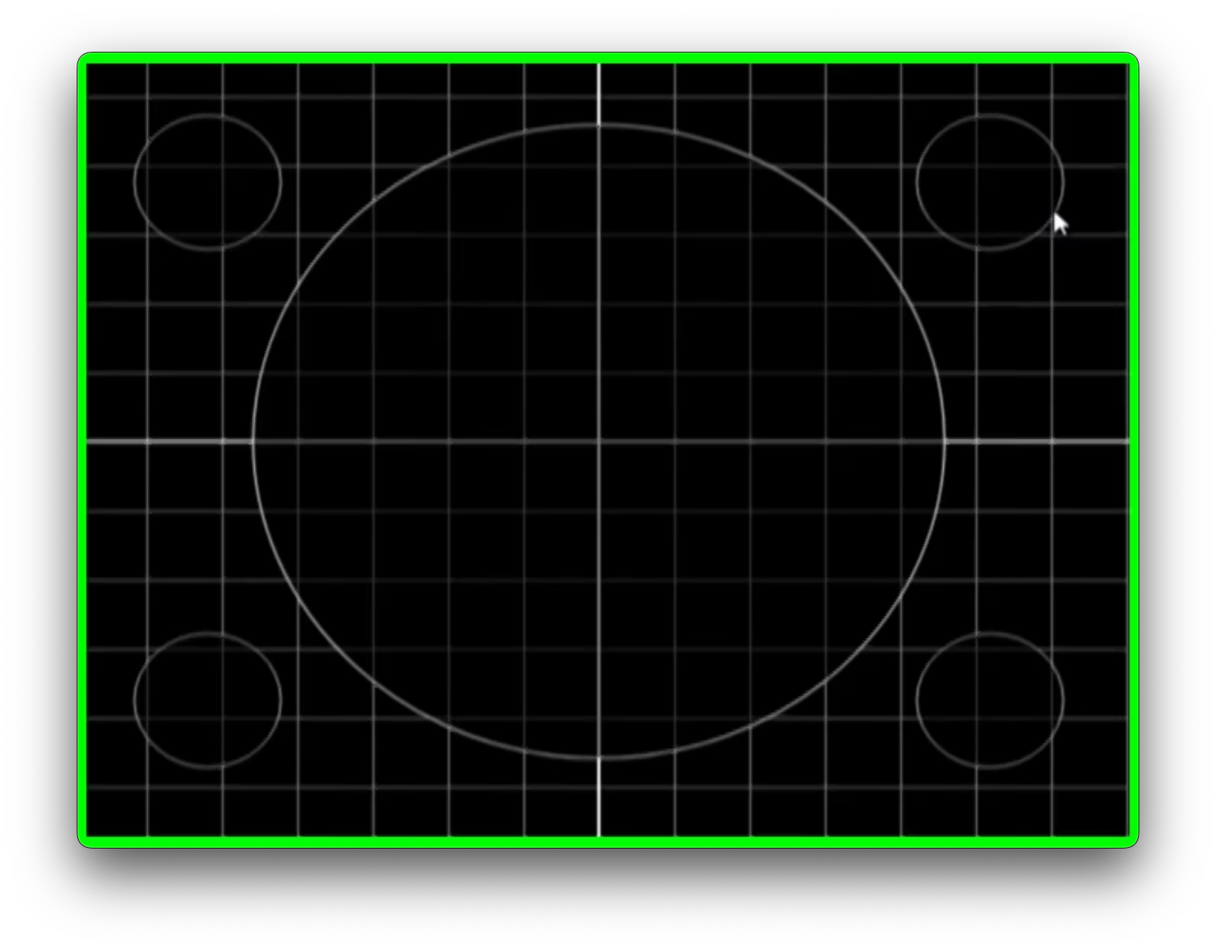

    So I ran another test with a test pattern with squares and circles. Same results and the stretching is obvious:
    SAR=1:1
    [Attachment 89576 - Click to enlarge]
    SAR=12:11
    [Attachment 89577 - Click to enlarge]

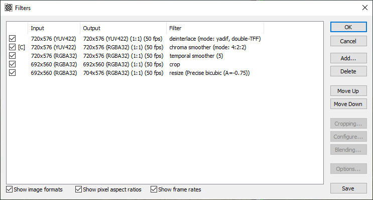

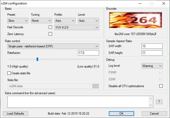

    These are the settings I used:
    [Attachment 89578 - Click to enlarge]
    [Attachment 89580 - Click to enlarge]
    [Attachment 89579 - Click to enlarge]
    [Attachment 89583 - Click to enlarge]
    The clips are used are attached below
    So I am now confused as to why I would use SAR=12:11 if it produces a horizontally stretched and visually distorted output ?
  2. You are confusing yourself: Your Test-Pattern-04-5s.avi has a SAR of 1:1 (square pixels), so it should be encoded with SAR 1:1.
    Your clip.avi has non-square pixels with SAR 12:11. So it should be encoded with SAR 12:11 which stretches it horizontally correctly by 12/11= 1.0909..., which gives 768x576 including the padding bars. (I didn't check your Vdub settings).
    A source should always be encoded with its native SAR.

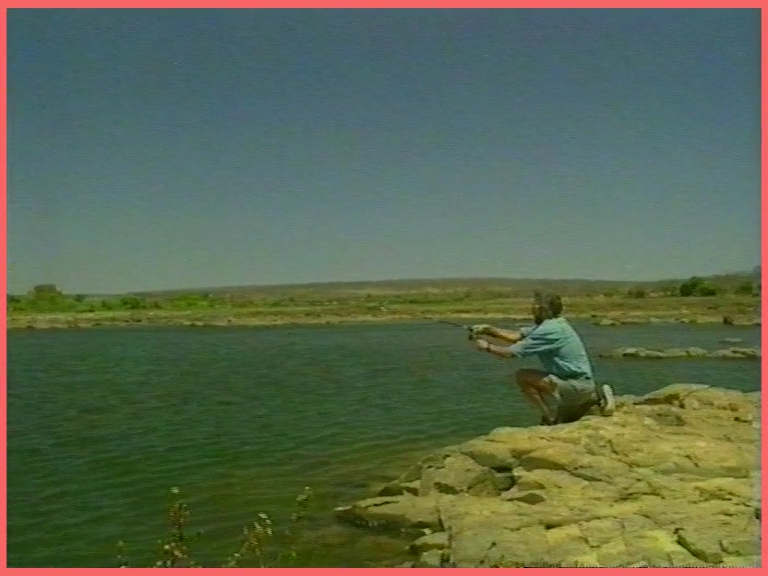

    SAR 12:11
    [Attachment 89589 - Click to enlarge]
    SAR 1:1
    [Attachment 89590 - Click to enlarge]

    The test.avi: Watch it in square pixels, and knowing the shape of the object (circle) which displays as a circle the SAR must be 1:1.
    The clip.avi: This is a PAL tape capture with black bars left and right. From "catalog" one takes the value of 12:11 for properly captured PAL VHS tapes. For finding it out you would have to find a circle in the video and do the "circle test". How to do it has been explained in dozens of posts in this forum, just do a search for "circle test" for example. Otherwise just believe religiously that properly captured PAL VHS tapes have a SAR of 12:11.

    In his first post the VirtualDub video filter dialog image shows he resized the video, changing the SAR.
  21. Originally Posted by jagabo View Post
    Originally Posted by JollyDin View Post
    So if I use the same camcorder and same capture device then I can religiously have faith that SAR with be 12:11 ?
    Yes for 4:3 PAL, provided your equipment is not flawed or any of your steps does not introduce some silent resizing (rescaling) under the hood.
    Hmmm... as I understand it his last filter did not resize the video. It is only used to pad the cropped video (Clip.avi) back to 704x576, so the SAR didn't get changed, no?
  22. Originally Posted by Sharc View Post
    You may be right. I was looking at the filter list dialog where it only shows a resize. But I see a later image shows the resize dialog and it's set to letterbox/crop -- which would not change the SAR.
    Correct. The "resize" was not "real" but was padding/letterbox with the green borders.

    Ok. Call me thick or not so bright but I'm still not getting it.
    All I'm trying to understand is why does the original test-pattern avi and Clip avi's "look" correct when played whilst exporting those clips after "resize" as x264 with SAR 12:11 "look" wrong or stretched when played ?
    Both clips are PAL 720x567 capture clips and so by definition they would have been captured with SAR=12:11
  27. Post samples of your circles/squares images and videos. That will tell us where you went wrong.
  28. Member
    Jan 2006
    Original capture AVI file: Test-Pattern-04-5s.avi
    Output of VD2 using x264 and SAR=1:1 in file Test-Pattern-04-vb2-sr11-6.mp4 that visually looks correct
    Output of VD2 using x264 and SAR=12:11 in file Test-Pattern-04-vb2-sr1211-5.mp4 that visually looks stretched
    Thank you for everyone's patience

    That capture is unnatural/unexpected. SD captures should need to be displayed at 768x576; if you do that with that file, it's stretched (use VDub, right-click on the video, look at 1:1 and then 4:3). With yours, at 720x576 1:1, it shows a circle.
    I would expect a capture to, at 1:1, look laterally squashed. You then apply the 12:11 (or manual crop and resize to 768x576) so that it stretches to the correct, circular shape. See Sharc's post #2.
    I suspect your capture/conversion chain has introduced aspect ratio errors.
    Attached, a "proper" analogue capture of a wheel. Do your two exports on that wheel: you'll see the effects have reversed: exporting at SAR 1:1 results in a squashed wheel and exporting SAR at 12:11 results in a correct, circular wheel.

    I think you gave the answer to your issue in your post #9 yourself: It's your setup. Your Laptop player applied the SAR stretching to the source file and outputs a "SAR 1:1 equivalent" resampled analog video at its S-video output. So when you capture this and encode it with SAR 12:11 the conversion is applied twice, so it gets horizontally stretched (~9%) upon playback via a player which respects the SAR signalling.
    This is what I had in mind in post#16 with the "... silent resizing under the hood". It's your setup which caused all the confusion, IMO.
    Your Laptop player isn't emulating a VCR correctly. It processes the source.
