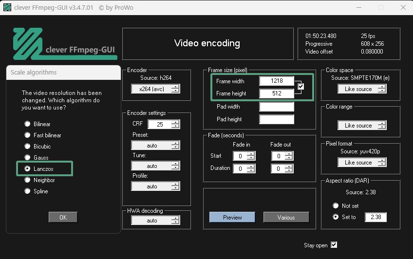

  2. try
    clever FFmpeg-GUI
    use Lanczos [good for quality/detail]
    [Attachment 89546 - Click to enlarge]
    There is nothing wrong .. with my environment

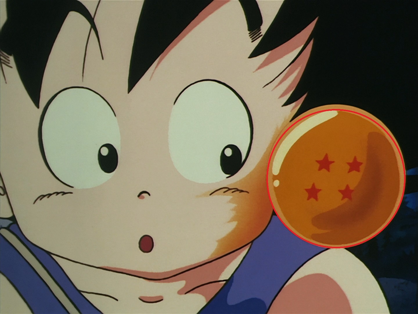

    Exactly, deinterlace with QTGMC, first bring it to 720x540 as I said before, which is the base, and not 768x576 because you are doing unnecessary upscale, and then, if you want, bring it to 1440x1080, which is nothing more than 720x2 and 540x2. But I'm convinced that you'll still have the wrong aspect ratio because I believe that any camera records in 1.37 and not 1.33, so 720x576 12:11 and not 720x576 16:15. You'd just need to do a test to understand this. 90% or more of 4:3 SD (Standard Definition) source footage from DVDs or camcorders transferred to Blu-ray at 1440x1080 all have the wrong aspect ratio. Example:
    All Dragon Ball Blu-rays and streaming videos have been upscaled from DVD to 1440x1080, which is wrong, and those who sell them throughout Europe have done so.
Name:	Dragon Ball_1080p.jpg
  12. Originally Posted by Goku73 View Post
    Exactly, deinterlace with QTGMC, first bring it to 720x540 as I said before, which is the base, and not 768x576 because you are doing unnecessary upscale ....
    You are proposing unnecessary vertical downscale to 540, actually throwing away original picture details/resolution. Usually a bad idea to unnecessary damage the source in a first step.

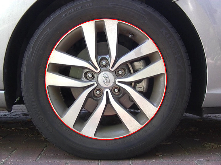

    May 2005
    Australia-PAL Land
    @Goku73, I can't see why the SAR has anything to do with this. This is DV. The display ratio is 4:3. The file is 720 across and it will be displayed as 768. If the 720 file is resized to 768 square, the visual result will be exactly the same. In my experience with DV files there is no distortion when resizing a 4:3 720x576 file to 768x576 square pixels. Here's a wheel from an unedited PAL DV file that has been resized to 768x576 with VDub2 (720>1440 shows the same):
    [Attachment 89562 - Click to enlarge]
    As for your DVD>Bluray Anime, unless you know every processing step, who knows where it went astray.
    My philosophy? Gettem square and keep 'em square. For resizing I just use VDub2 to go from 720x576 to 768x576 as part of the deinterlacing process ie at the end. If I have no editing at all to do, I'll go to 1440x1080 in VDub, or if I'm editing in my NLE, I'll resize as part of the export process after editing. I don't know what algos they use. I don't go straight to 1440x1080 after double-rate deinterlacing because the AVI files are just too big to be manageable (8 times bigger than source).
    In your case, using Resolve, be mindful that it won't accept "normal" AVIs, only DV and ProRes. So using Hybrid, you'll need to export into a format that Resolve will accept, but ideally not back to DV after deinterlacing.

  24. Member
    May 2005
    Australia-PAL Land
    For the exercise, here's a DV file of a wheel (the source of my still image above). I don't remember what camcorder I used (I have a few!).
    12:11 or 16:15?
