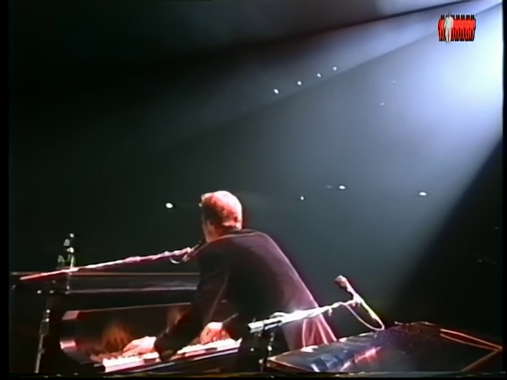

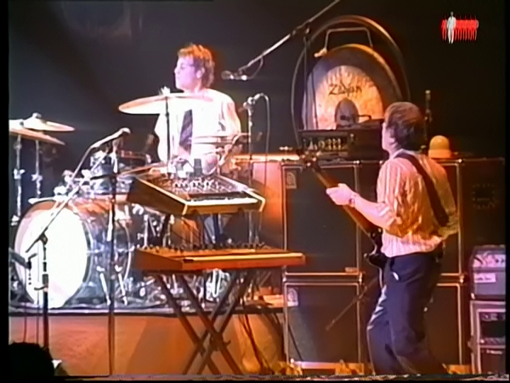

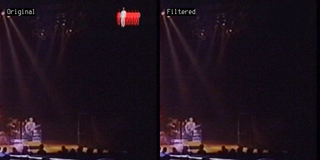

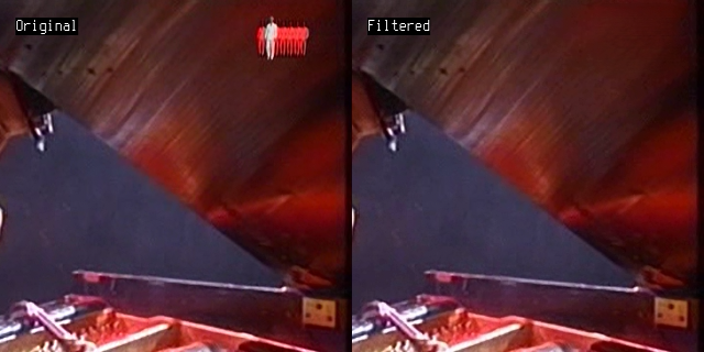

    This is my first post here so my apologies if I'm doing anything wrong. I'm trying to de-ghost and de-logo a DVD, and I'm having trouble removing the ghosting with the filters in Hybrid, as well as getting InpaintDelogo to work. I only really have experience with Hybrid, so any help would be appreciated.
    Attached are screenshots, the logo I wanna remove is in the top right and is static, and the ghosting is more apparent in in farther shots usually.

  5. That's a reencode, DVD content should be MPEG-2 not AVC => sample is useless.
    (Also: I only see some motion blur and blending between scene changes, potentially due to wrong 'deinterlacing',..)
