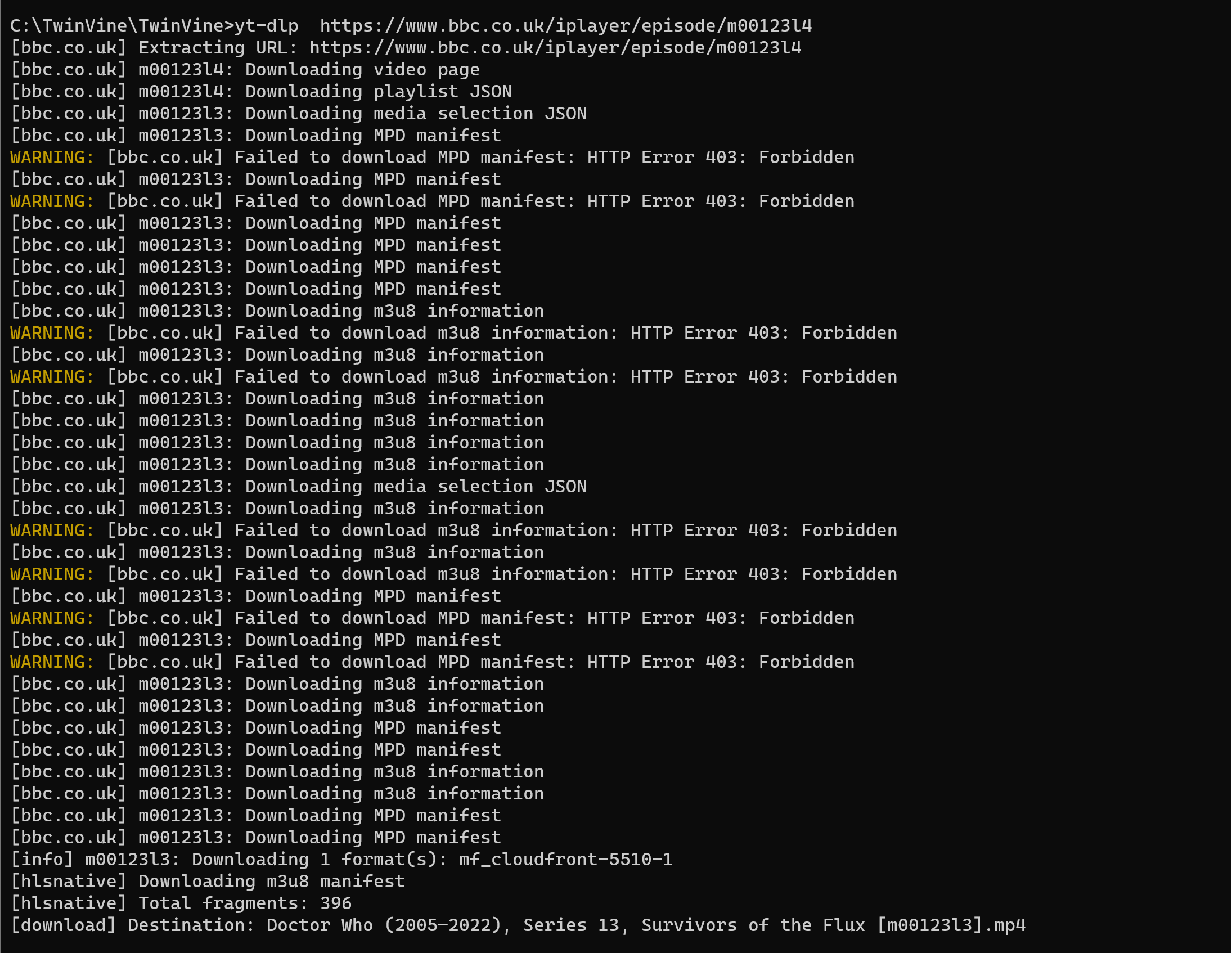

Tried to use the certs with yt_dlp -> does not change resolution still 540.
Tried to change outdated tools to us the new certs instead of old hardcoded ones -> still 540.
Is it my bad windscribe VPN relay point or do i miss something?
Any Tip's?
Thanks -
you have to use scripts, as the 4k content is located at different end points, so yt-dlp will never see it. yt-dlp doesn't even see 1080p unless you make some manual changes to the bbc code it uses.
only certain content is available in 4k. if you only see 540p, not even 720p (which is the max standard yt-dlp can see), it certainly won't be available in 4k.
look at some of the pinned threads, i think i used devine last time i grabbed some 4k from iplayer, but envied or unshackle is what people seem to use now. -

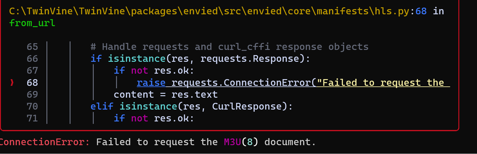

tried with n_m3u8dl-re: gets a 403.
That made me believe i did not have the right vpn/cert/device anymore to access the m3u8
I changed the vpn can now switch between ~70 vpn endpoints in uk -> still no luck.

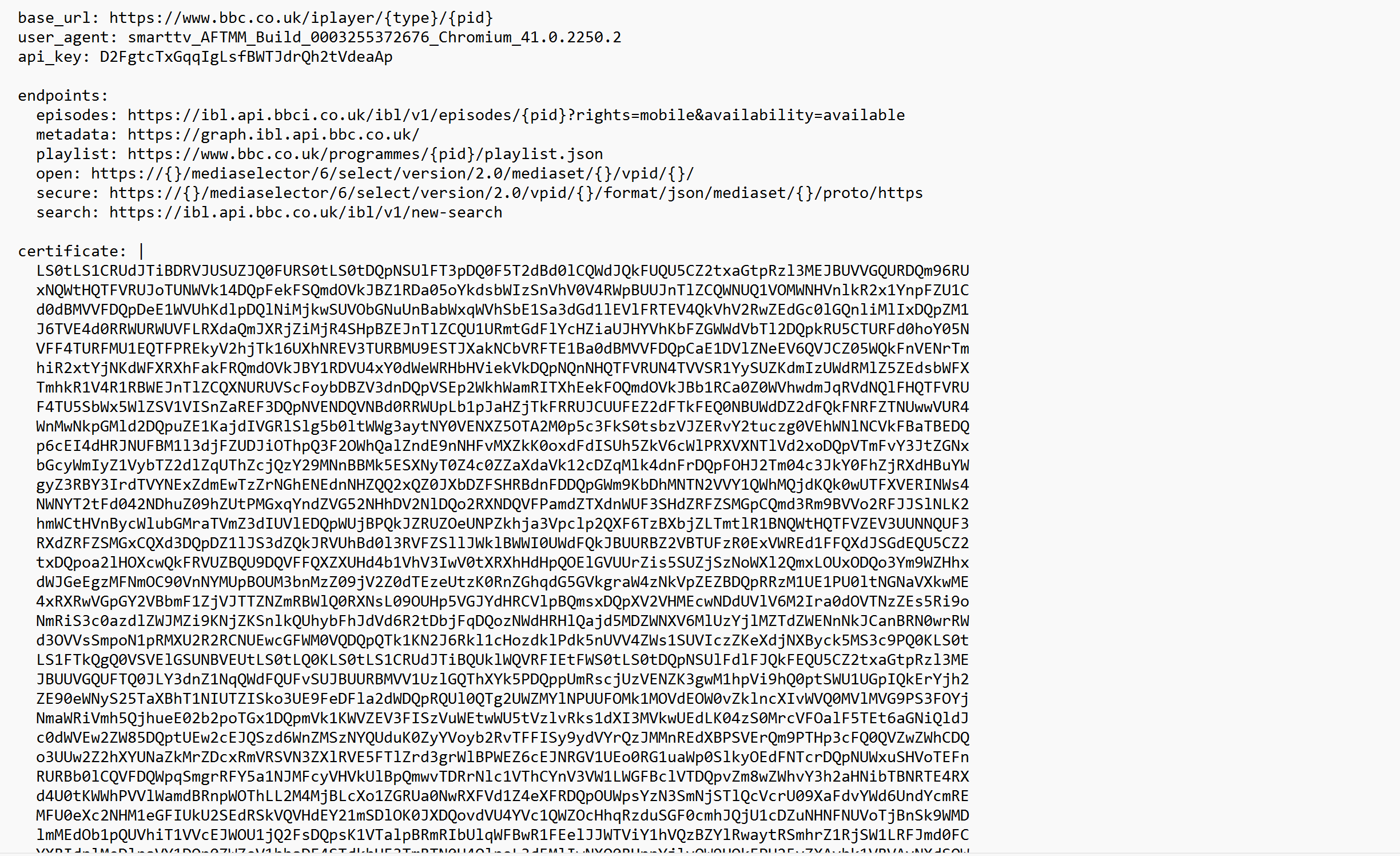

I changed the cert that is provided to envied from the IP config
[Attachment 89619 - Click to enlarge]
with the lower cert + private key from this thread -> encoded it base64 and reformated it to meet the right formatting rules for the config.yaml
I still get the 403.
I used the ?newer? service provided by stabbedbybrick instead of the Mateooo11 one. Is that wrong? thought of it as stabbedbybrick probably cleaned and changed the enpoints in the last year.
[Attachment 89621 - Click to enlarge]
Is it possible that the endpoints(mpd,m3u8) that are forbidden in yt-dlp are exactly the same that are used with envied? I'm allready playing with the thought to change yt-dlp to see exactly what links are 403 for me.

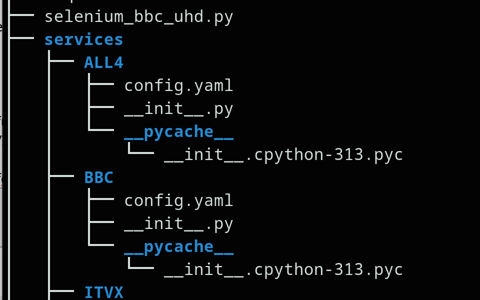

Doctor Who is pain!
VineFeeder tries to be helpful. For the BBC service, it checks the program name - Doctor Who - against the current list of UHD titles from the BBC. The check comes back positive! Because SOME episodes are UHD and Doctor Who is on the list. VineFeeder then tries to download ALL episodes as if they were UHD and fails with those that are not.
The trick is to edit the Vinefeeder service yaml.
[Attachment 89624 - Click to enlarge]
locate services/BBC/config.yaml and edit the line
toCode:hlg_status: True
This will stop VineFeeder automatically looking for UHD programs and all titles will be downloaded in SD.Code:hlg_status: False
So, with Dr Who from the BBC, you will need to be a little more interactive and know which series are UHD; switch hlg_status: True.
For those Doctor Who series which are SD, switch hlg_status: False.
I see you are using TwinVine - as do I - the location of the BBC config.yaml is packages/vinefeeder/src/vinefeeder/services/BBC/config.yaml.Noob Starter Pack. Just download every Widevine mpd! Not kidding!.

The Problem i have is fully in the envied part. I can not get envied to download anything from bbc.
SD dies on hls.py where it (as allready described, at least I tried to
) tries to get from the url (in hls.py line 67/69):
http://vod-hls-uk-live.akamaized.net/usp/auth/vod/piff_abr_full_hd/20d26a-m001dhs9/vf_...ls/master.m3u8
HD dies on dash.py (line 67 it tries to get the result of the following link but it is 403 Forbidden -> wrong device? cert? cookie? missing login?)
https://vod-uhd-uk-live.akamaized.net/ybpgrxdv-pips-pid-m001dhs9/scmaf_abr_full_uhd/rd...76e3a782803375
So both SD and UHD die from a 403 to the mentioned adresses.

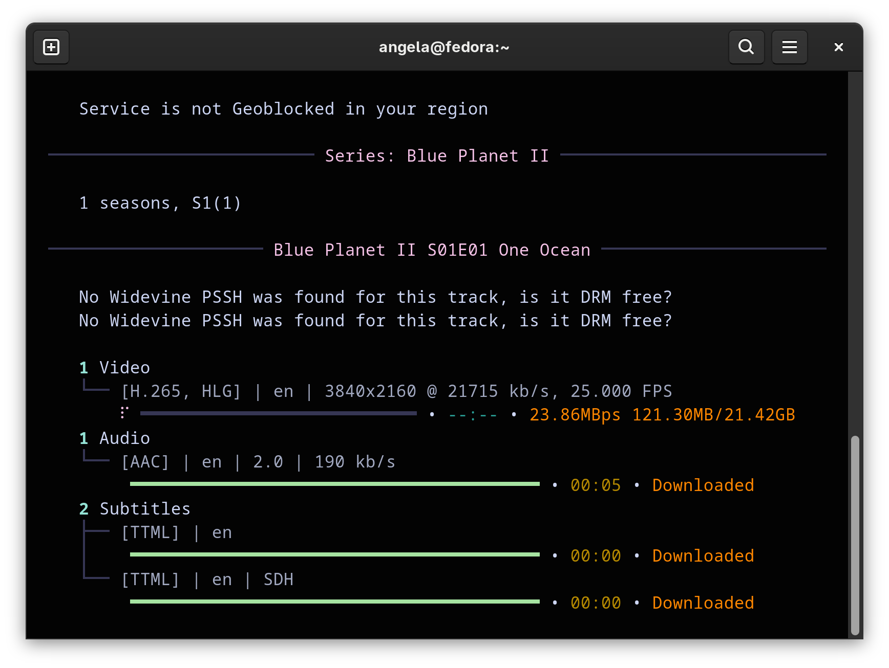

Or better asked: Does envied BBC uhd/FHD still work for UK natives? If yes it must be the vpn. I used your project from github as you wrote in the readme.md -
No and yes.
[Attachment 89633 - Click to enlarge]Noob Starter Pack. Just download every Widevine mpd! Not kidding!.
