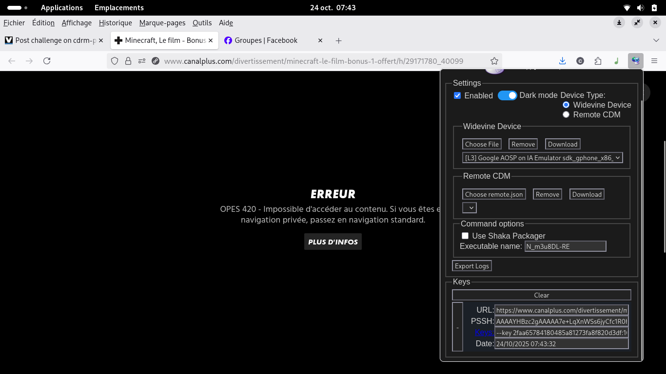

WidevineProxy2 works to get Keys from Canal+
[Attachment 89371 - Click to enlarge]
