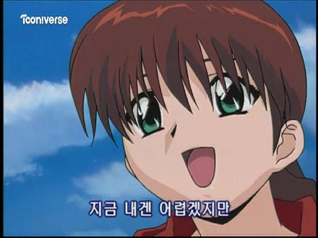

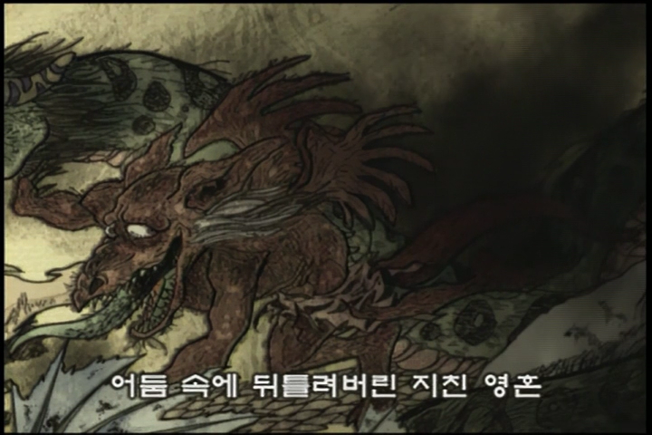

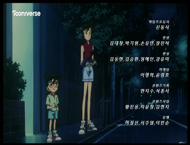

  1. Well... Some reason, when I convert 480i source to 1080i in Premiere Pro, this happens. (Click to see original image, because preview image is worse resolution than original, so you couldn't see same phenomenon in preview.)

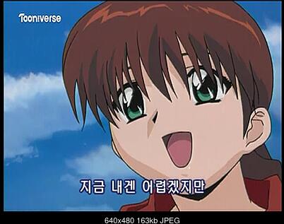

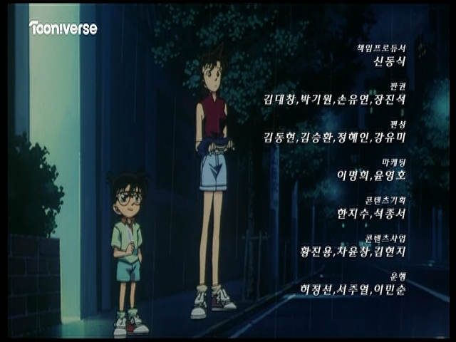

    This is originally 480i Cable TV TS Capture, but I resized to 1080i using Premiere Pro.
    and most of TV Channel in South Korea also have this problem after late 2023~2024.
    This is original 1080i TV Broadcasting.
    but, if I convert it to 480i again, it does not seem to original quality.
    I thougnt It would be better deinterlace filter, but when I used QTGMC, it seems just the same using Bob filter.
    How can I convert it to original quality or similar?
    I couldn't found the way, except keep resize untill it seems good and use QTGMC... but it isn't perfect way.
    I want to get 480i video that looking just same as original 480i source, not the progressive video.
    Could anyone tell me what's the problem, and how can I recover it to original quality?

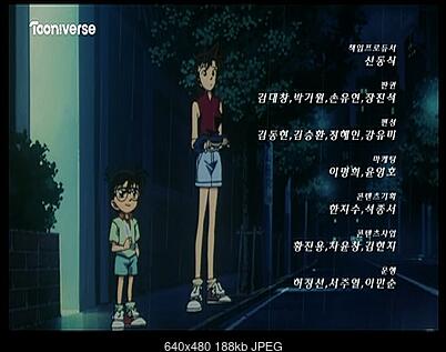

  5. Something like this 480i to 1080i?

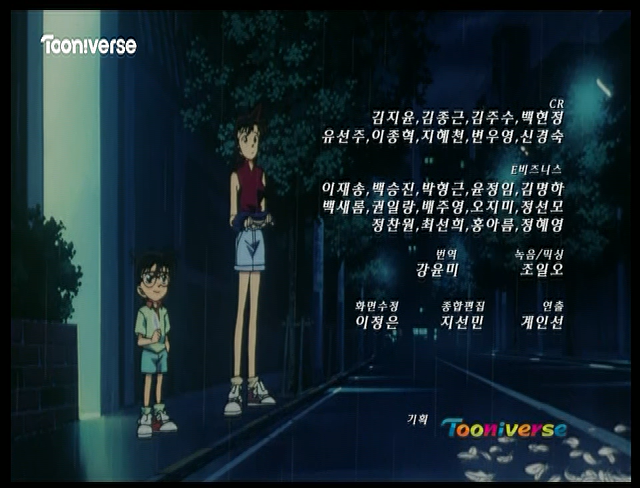

  10. If you look at the 1st post examples of the credits /text e.g. "2 - 투니버스_20250809_235546.ts" , both fields are missing data on static text. There is no conventional way to fix that properly. Maybe some anime folks trained some AI , I'm not up to date on that
    If it were me, I would IVTC and ignore the text. That way you get the highest quality progressive content for the main parts, and you don't degrade everything by deinterlacing. This is anime - the original content is 24p , not interlaced. If you need sd interlaced format, you can downscale progressively after IVTC, and reapply the pulldown for 29.97i
    Gamma aware downscaling will reduce the loss on thin white or bright text lines and characters. e.g. in avisynth a simple way is to use ResampleHQ , but you can linearize with AvsResize as well, apply scaling, then delinearlize . But that will not necessarily help thin dark text as well as bright details or lines

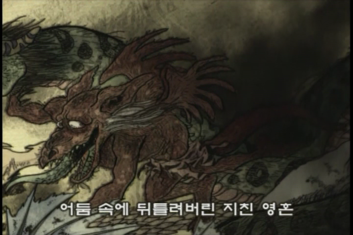

    well, I guess I found very good example!

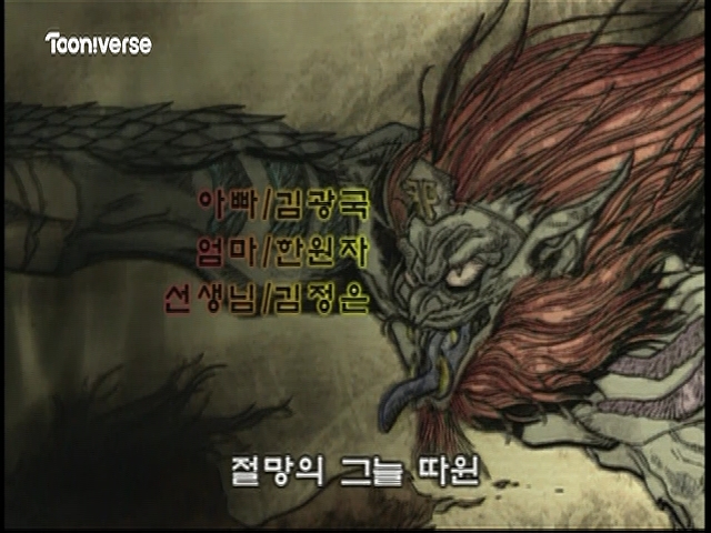

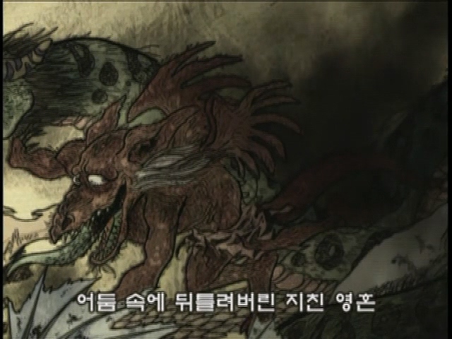

    I found 2008~2011 480i re-air video and 2025 1080i re-air video.
    I guess It could help this challenge a lot.
    "학교괴담OP.ts" and "학교괴담ED.ts" files are 2025 1080i re-air video,
    and "학교괴담 오프닝.ts" and "학교괴담 엔딩.ts" files are 2008~2011 480i re-air video.
    **This videos' first broadcast date is 2002.

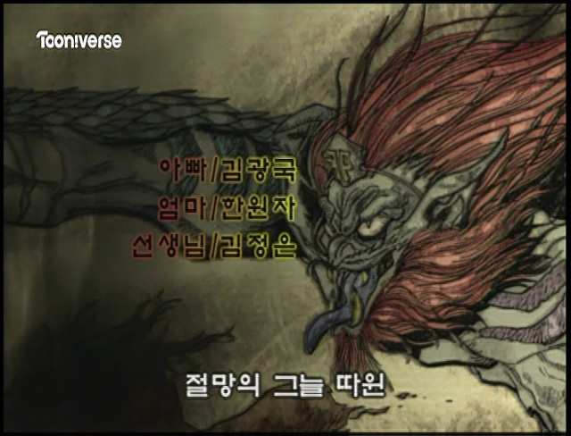

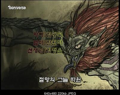

  12. and, If you convert attached 1080i videos to 480i without any adjust, It looks much worse than mine.
    so I adjusted video again in Premiere Pro. and I attached Preset and result video, so check it if you want.
    and can I use other better resizing filter than now?
    I think Premiere Pro's resizing filter is the reason why video is so pixelated.

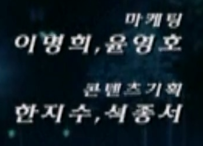

    Yeah, I know that Premiere Pro result has Aliasing artifacts, but I couldn't get any better result than Premiere Pro when using AviSynth.

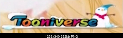

    In AviSynth, all of resizing filter looks like attached image.(see in larger version)
    I'm newbie in AviSynth, so I can't find any better way.
    I'm curious what your method is and what kind of results you'd get if you applied it to an OP video rather than an ED video.

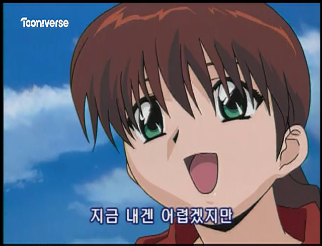

  16. Here is a non par corrected 1:1 screenshot of that frame for the premiere version you posted, and the avisynth filtered version . The difference in AR/borders is because PP has a specific interpretation for SAR for 4:3 DAR 720x480 , whereas the script I used just took the full frame and downscaled for the example. You can adjust it however you want.
    [Attachment 89421 - Click to enlarge]
    [Attachment 89422 - Click to enlarge]
    You can try it
    I used avisynth as I described above, but added some antialiasing. IVTC, descale with sharper parameters, and for antialiasing / fix artifacts - I used AnimeUndeint_Compact . This is just 1 way of doing it , there are dozens of variations for each filter. Many types of AA filters etc....
    LWLibavVideoSource("학교괴담ED.ts")
    TFM(pp=0)
    Tdecimate()
    UserDefined2ResizeMT(720,480, b=40,c=-20,s=2)
    z_convertformat(pixel_type="RGBPS", use_props=0, colorspace_op="709:709:709:l=>rgb:709:709:f")
    mlrt_ncnn(network_path="PATH\1x_AnimeUndeint_Compact_130k_net_g.onnx", builtin=false)
    z_convertformat(pixel_type="YV12", use_props=0, colorspace_op="rgb:709:709:f=>170m:709:709:l") #601 colors
    #Reinterlace - personally I wouldn't do this step and keep it progressive
    ChangeFPS(60000,1001)
    AssumeTFF().SeparateFields().SelectEvery(4,0,3).Weave()
    #Trim(79,2739) #trim to ED , cut commercials
    If you want to keep commercials /live action, make sure to filter sections differently, because obviously they were processed differently
    Taking a quick look at OP - you could probably filter it slightly differently , because there are additional problems, such as more compression artifacts, especially on scene changes. ( Also the other older 480i version had compression problems, probably none of the broadcast versions used proper master)

  22. I found method that convert 1080i video almost similar to original 480i video!
    LWLibavVideoSource("코난ED.ts")
    interlaced_clip = last
    top = interlaced_clip.SeparateFields().SelectEven()
    bottom = interlaced_clip.SeparateFields().SelectOdd()
    target_height_float = 242
    target_height_int = 240
    source_height_original = top.height
    effective_source_height = target_height_int * source_height_original / target_height_float
    crop_offset = source_height_original - effective_source_height
    top_resized = top.ConvertToRGB32().UserDefined2ResizeMT(640, target_height_int, b=0, src_height=effective_source_height, src_top=crop_offset)
    bottom_resized = bottom.ConvertToRGB32().UserDefined2ResizeMT(640, target_height_int, b=0, src_height=effective_source_height, src_top=crop_offset + 1)
    Interleave(top_resized, bottom_resized)
    Weave().AssumeTFF()
    I used gemini because I'm newbie in avisynth, so script is looks dirty.. but I get most better result with seperate fields!
    Important point was src_top=1 in bottom field resizing part.
    but It has ghosting in some part. see in the image below.
Name:	New File000277.jpg
Name:	New File000620.jpg
Name:	New File001457.jpg
  23. Improved, but still has some aliasing . You might be able to play with some parameters to get it closer
    The artifact is generally referred "ringing" or "halos" from oversharpening, not "ghosting". Ghosting implies a temporal discrepancy, such as blend of 2 frames from 2 different times. You can try adjusting the resize parameters to a softer scaler (change the b, c, s values until you find something you like) . YOu have to make some tradeoffs between sharpness vs. ringing artifacts . I would avoid using "dehalo" filters, because they are quite damaging - try to fix it on the sharpening end, or there will be a lot of counterproductive back and forth
    RGB32 is probably not required and more damaging than staying in YUV - if you need 1 pixel cropping on 4:2:0 material, YV24 (4:4:4) is probably better option
  24. Yeah I removed RGB32, because it removes color details a lot.
    and I modified b,c,s, but I couldn't get better result I guess.

    no, I just find out that height value was Important point.
    LoadPlugin("LSMASHSource.dll")
    LoadPlugin("ResampleMT.dll")
    source = "코난ED.ts"
    audio = LWLibavAudioSource(source)
    LWLibavVideoSource(source)
    target_height_float = 243.104
    target_height_int = 244
    crop_offset = source_height_original - effective_source_height + 1
    top_resized = top.UserDefined2ResizeMT(640, target_height_int, b=0, src_height=effective_source_height, src_top=crop_offset)
    bottom_resized = bottom.UserDefined2ResizeMT(640, target_height_int, b=0, src_height=effective_source_height, src_top=crop_offset + 1)
    final_video = Interleave(top_resized, bottom_resized).Weave().AssumeTFF()
    return AudioDub(final_video, audio)
    The reason why halo not disapper is I need to plus 1 pixel in crop_offset.
    so, top needed src_top=2, bottom needed src_top=1.
    and exact target_height_float was 243.104, which was the value what I got in Premiere Pro.
    I think I've done it...
Name:	New File000282.png
Name:	New File000372.png
Name:	New File000620.png
Name:	New File001473.png

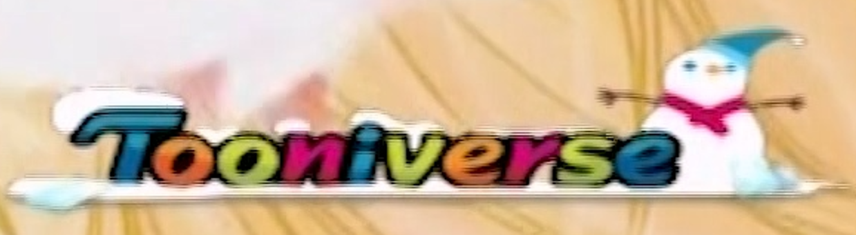

  29. It's improved, but still some aliasing and halos . It makes you wonder if those are current settings are the ideal settings . Maybe the target height is still off, or the kernel resize settings are not ideal. A dead giveaway is the frame edges (top and bottom borders), and logo edges / halos such as around Toon!verse . Height - because you can also see corresponding halos around character top and bottom objects such as mouth, eyes etc.. not left vs. right halos - so not horizontal or width (or at least a lot less). If you can adjust the settings to looking at the logo as a guide, I suspect the result will be better
    Another way for feedback/testing is to use avspmod tabs. You can put different script settings /version in different tabs flip tabs using the number keys quickly and see differences easily
  30. Originally Posted by poisondeathray View Post
    I don't care about Toon!verse logo. that is original 1080i logo, so It must have aliasing and halos.
    and halo in frame edges and character also ok for me, because it is almost looking similar to original in my eye.
