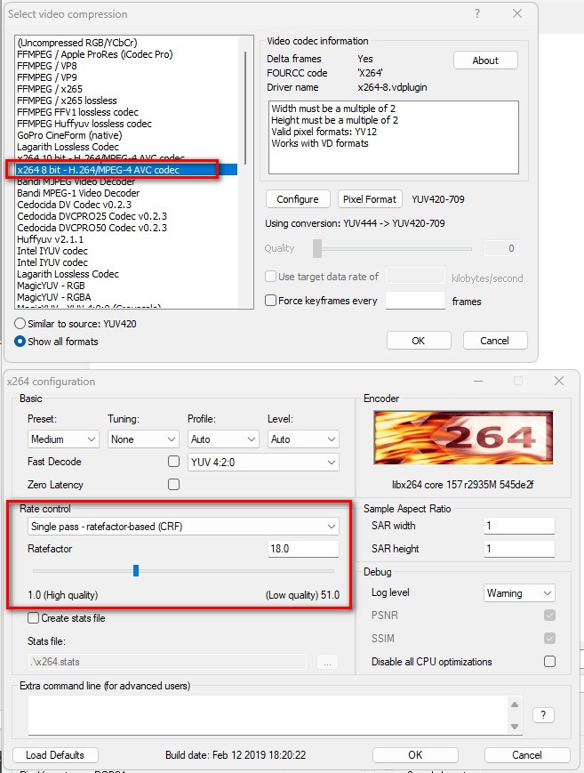

    I think Xvid has fallen out of favour these days.
    You can use the H.264/AVC x264 8bit codec:
    [Attachment 89256 - Click to enlarge]
    You can adjust the file size by changing the CRF value. 18 is a good starting CRF. Lower CRFs=larger file sizes/better quality.
    You probably know this, but make sure you set up the audio compression before you go to the File>Save Video... screen, otherwise you'll be stuck with PCM, which cannot be put into the MP4 container with VDub2.

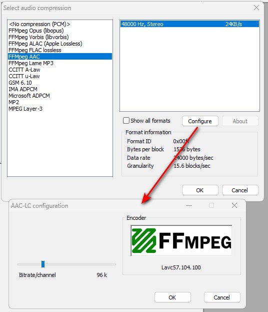

    In my experience, VDub won't "Direct Stream Copy" MP4.
    For audio, Full processing>Compression>AAC. Go to Configure and set rate to 96Kb/sec (that will be 192kb/sec for two channels):
    [Attachment 89274 - Click to enlarge]
    File>Save Video... set up Video as per my post above (via the "Change" button)
    Change the video Save As Type to "MP4 Faststart"
    Then Save.
