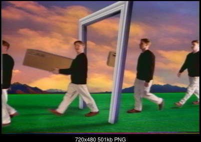

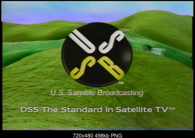

    i'm having this issue that just popped up with my vcr. on some tapes, there are chroma lines and i don't know why it happens.
    it shows up on:
    -a direct s-video connection from my vcr to my capture card (gv-usb2)
    -a direct composite connection from my vcr to my capture card
    -a direct s-video connection from my vcr to my other capture card (wintv hvr-1290)
    -a direct s-video connection from my vcr to my retrotink 5x
    -a direct composite connection from my vcr to my retrotink 5x
    -an s-video connection through my dmr-es15
    but here's the thing:
    -it doesn't show up on a crt through composite
    -it doesn't happen when i run my vcr through my datavideo tbc-3000 (s-video or composite)
    -it doesn't show up on a direct composite connection to my wintv card
    -it doesn't show up on a composite connection through my es15
    -it doesn't show up on a dvd recording through s-video on my es15
    -it doesn't show up when the tape is paused
    -it shows up less when the vcr set to detail/norm, but not fully (it mostly shows up at the bottom of the picture)
    -it doesn't show up on all tapes. i've only seen these on retails, some with macrovision, some without. it's not showing up on any of my home recordings that i've tried

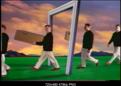

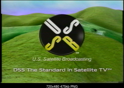

    here's a screenshot through my tbc-3000. as you can see, the issue isn't there.

    what gives? why is it only showing up on certain connection/hardware configurations, and why does it not happen on all tapes?? is my vcr biting the dust?? it got recapped over a year and a half ago.
  2. Hard to say since the details of the refurb aren't really known, but who did the recap and what was all recapped? Deter, for example, doesn't change the "through hole" capacitors on the TBC card (only changes the surface mount ones) to my knowledge, but not sure if that is contributing to your issue or not since I always change all electrolytic capacitors during a refurb.
    Does it do it when the internal TBC is turned on vs off?
    Seems like the difference in what does or doesn't cause the problem comes down to whether the colorburst/sync signal is being rebuilt or not after it leaves the machine. It not being visible on a CRT doesn't really say much since it could just appear more blended, or it might process the colorburst differently. Some capture cards might also tolerate colorburst abnormalities better than others.
    On the other hand, since it doesn't do it with all tapes and it is repeatable on tapes that have the problem consistently, it sounds more handling something about those specific tapes in a non-ideal way.
    The next step would be to see if this is reproducible across other AG1980's or not with those specific tapes to know whether yours is doing something that others won't. If you want to send me a tape or two, I can verify if my refurbished AG1980's do the same thing or not with those specific tapes, but I don't think this issue is particularly widespread since I haven't seen many other posts about it, though it could just be that most people aren't capturing macrovision/commercially produced tapes to have seen it, or another part of their chain might be masking the issue as you mentioned.

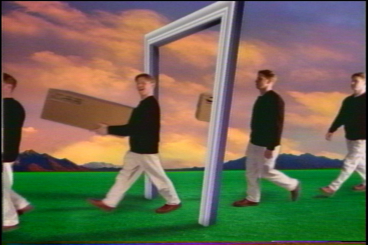

    i might be able to send something sometime. but i found out from someone on the domesday86 discord server that i can filter it out in avisynth.

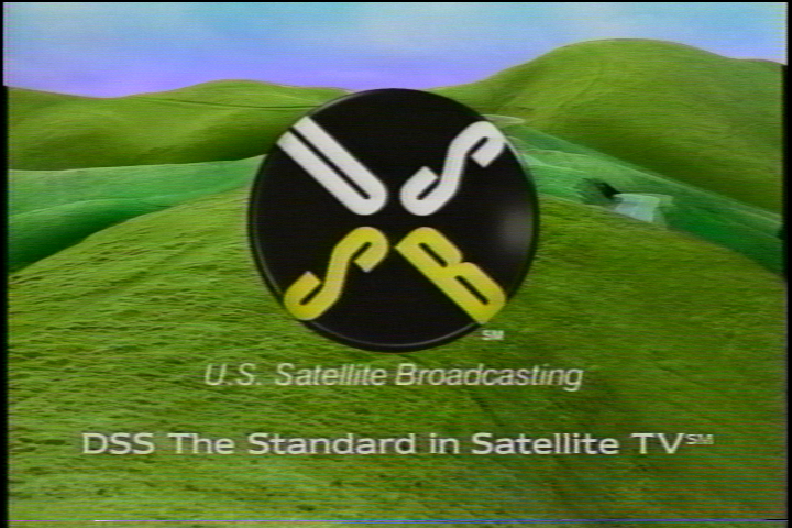

    raw capture, es15:

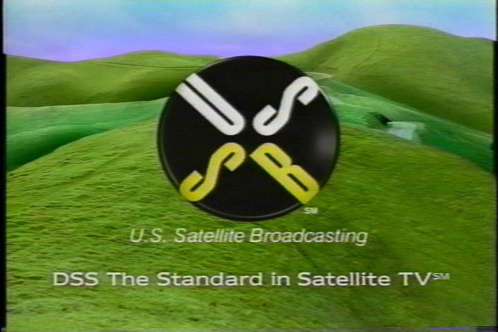

    Mergechroma(separatefields().vinverse().weave())

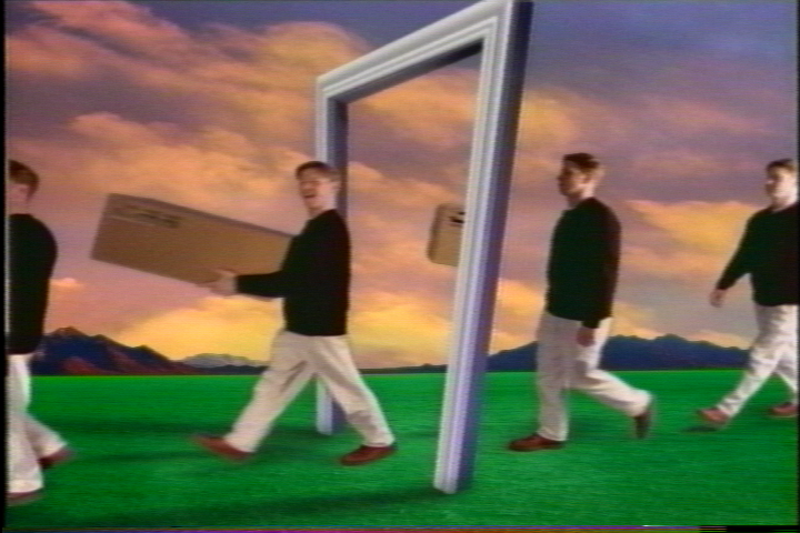

    raw capture, tbc-3000:
    at least i can filter it out, it just sucks that the issue is there to begin with. its super weird.
  4. Those are Hanover bars, the native state of analog pal video.
    https://en.wikipedia.org/wiki/Hanover_bars
    TVs will filter them out, of course. Some capture devices do, some don't.

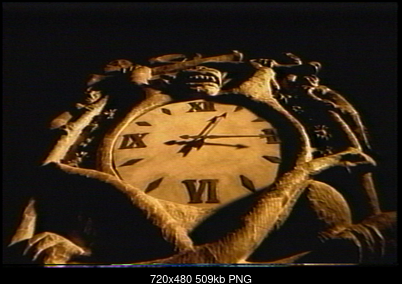

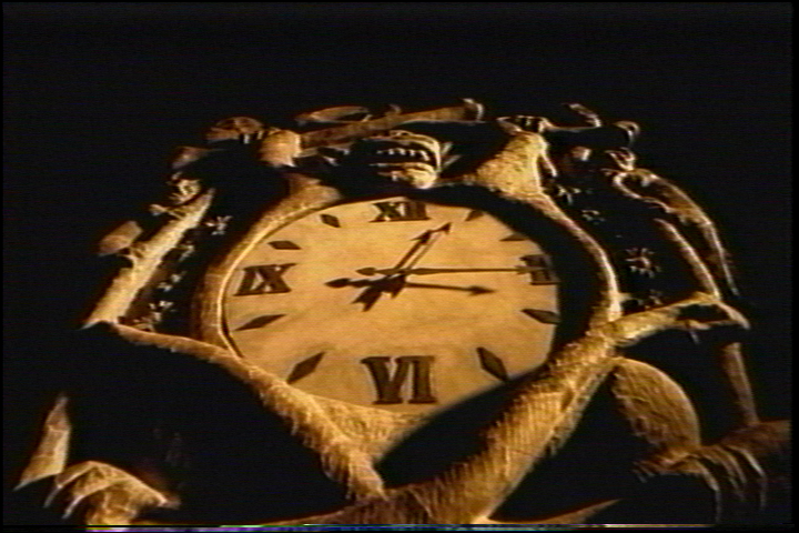

    nah it can't be normal. this particular issue shows up on the bottom right area of the screen, sometimes in the whole image. here it is on another tape.

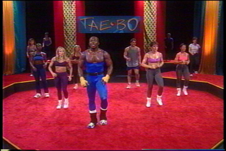

    and another
    on that particular tape, the issue doesn't show up on input 2, but it shows up on input 1.

  13. Video Restorer lordsmurf's Avatar
    For whatever reason, you are getting Hanover lines/bars.
    Odd.
    That has to be a chrome issue within the VCR.
