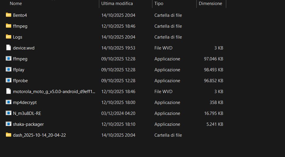

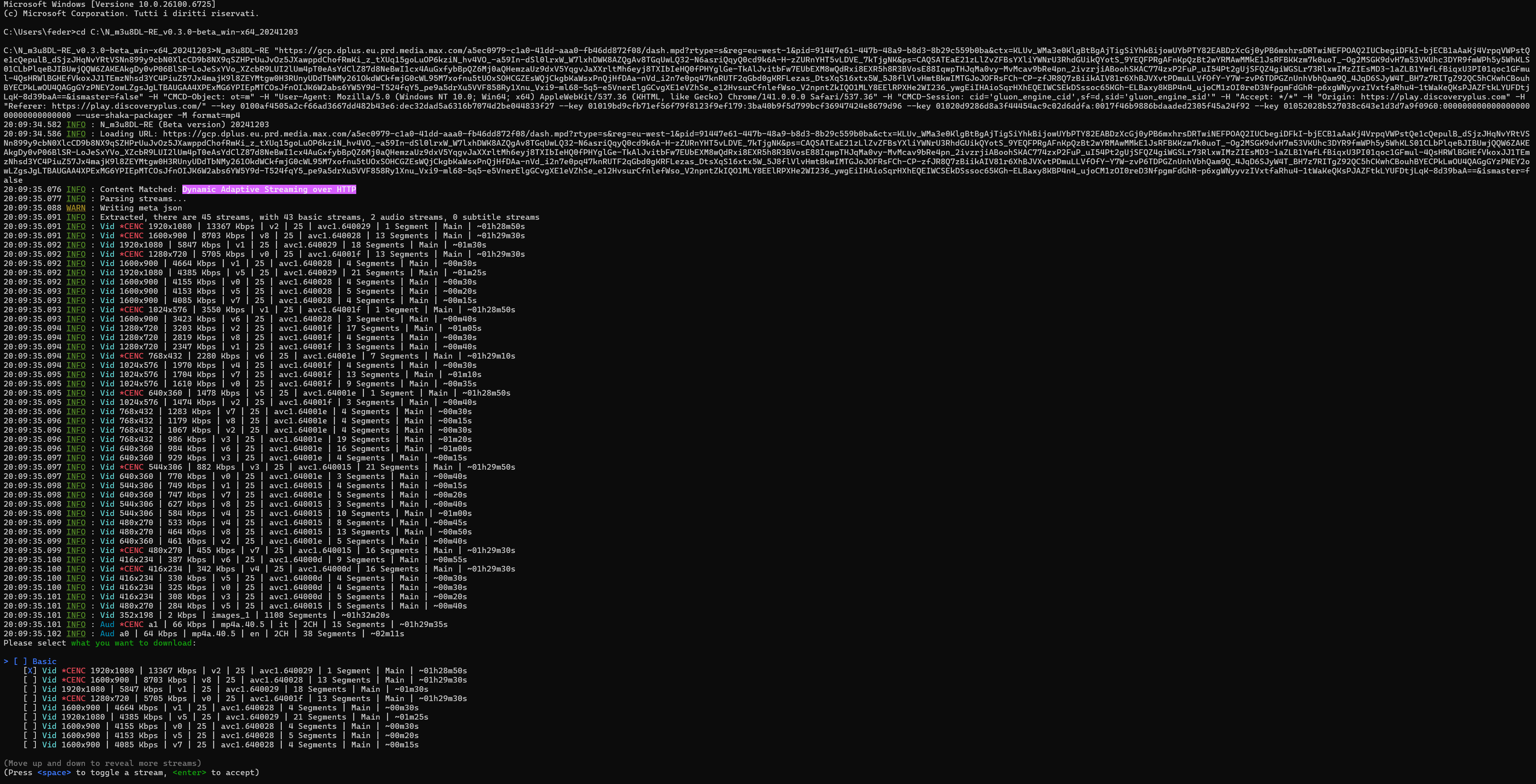

    I'm trying to use N_m3u8DL-RE. I have been following tutorials on this website and it looks like that I'm fully able to use the tool on MacOS. However on Windows, using the same widevine device and widevineproxy2 extension, I'm not able to download the videos I'm interested. It looks like N_m3u8DL-RE works but doesn't decrypt the audio and video files. I'm posing few pics to understand if I set up something wrong.

  2. and then? press enter and download start
    and wvd file need to get key. no need on N_m3u8DL-RE for download

    I know I have to press enter. Considering the issues related to 1080p resolution which requires an L3 device, even if I choose 720p the download starts but I get a “ non monotonous dts error” related to the fact the audio and video are not properly decrypted and thus have different length.
  4. No, Discovery PLUS requires L1 for 1080p, keys for 1080p/900p is wrong which is causing description failure.
    The last key which contains 00000 is needed for L1
    I’m not interested in 1080p. If I choose a different resolution it should work but it doesn’t. That’s strange because on my Mac with the same device and the the same extensions it works. On windows I get audio and video files with different lengths.
