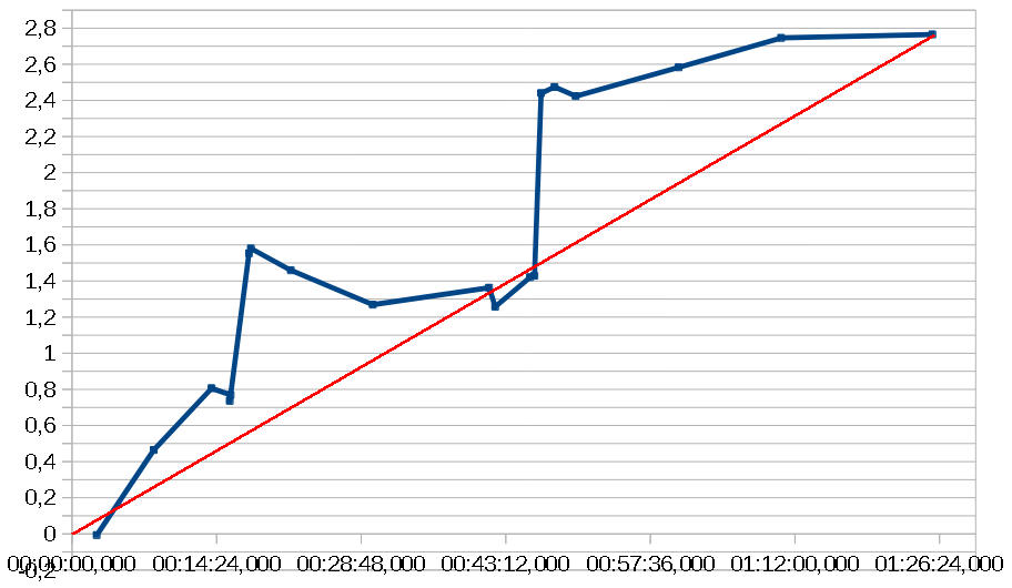

  1. Thank you for the explanation.
    However... I'm sorry... that is definitely wrong for the case I'm describing (see my very first post).
    This is what your correction actually does:
    [Attachment 89202 - Click to enlarge]
    And when I wrote...
    Originally Posted by nji9nji9 View Post
    I muxed it, and checked the result... it seems to be pretty good
    ... I seem to have checked by chance at timestamps where it is close.
  2. Why should my approach in post #1 definitely be wrong for the purpose?
    What are you trying to achieve with this graphic (post #31)?
    Is my audio synchronized or not?
    I muxed it myself with the mp4 in post#22 and it's in perfect sync.
  3. The red line in post#31 shows your correction you described in post#30.
    I.e. your correction is perfect only at the intersection of the two graphs.
    I rechecked the video's audio with your audio in detail at the timestamps
    - with an audio editor this time.
    There should be big differences at e.g. 17:50 and 48:03:
    desync should be abt. 1s at that timetimes. See my graph.
    However... the differences between the audios are only abt. 0.3s and 0.25s.
    Which means that you didn't only stretch to equal lenght according
    to end point peaks.
    It seems that what you call "fine tuning" does most of the work,
    i.e. lots of additional arbitrary corrections?
  4. Originally Posted by nji9nji9 View Post
    Have you watched the video besides your graphs?
    Perfectly synchronized at 17:50 and 48:03.
