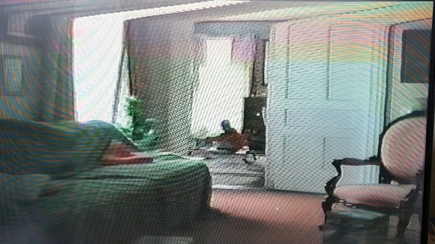

    Hello. I am new to this forum.
    I am digitizing my VHS family movies. Have it all set up and recording already, generally going well.
    My question is about intermittent poor quality on the playback.
    Have a Mitsubishi HSU-446 VCR which was purchase new a long time ago. Since it had been sitting for so long I cleaned the heads and the sound pick up.
    It works OK except sometimes the top of the image sort of folds over as shown in attached photo. I tried adjusting the tracking using the channel buttons and that didn't fix it.
    The problem is intermittent but happens on all tapes enough to be annoying. The VHS recordings were made in the late 1980s and early 1990s so the tapes are 30+ years old. Have been stored in climate controlled conditions the whole time as far as I know.
    If it's tape degradation then I guess there's no hope. But is it possible adjusting the tape roller guides might help?
    Any help is appreciated. Thanks.
  2. Good news for you is that is totally fixable with a re-capture (assuming you still have the original tapes). Your VCR simply lacks a line TBC which addresses the exact problem that you are seeing which is generally called "flagging." If budget is an issue, passing the signal through a DMR-ES10 or ES15 DVD recorder will likely resolve the problem as you re-capture. You could also invest in a higher end VCR that has a line TBC and probably get even better results, but they can be cost prohibitive depending on your budget.

    IIRC, it has been said on here that "flagging", as per the OP's image, might not be corrected by the TBC in a VCR but probably will be when the video is passed through one of those DVD recorders.

    There's also a nasty crosshatch pattern all over that still frame.
    May 2005
    PAL User
    Could be a photo of the screen?

    In response to comments above about cross hatch that is a photo of the monitor while recording the VCR signal using Roxio.

    I got a used Panasonic DMR ES10 and digitized a VHS tape using the pass through function. The flagging is totally gone. Now if I could just go back 30-40 years and use SP instead of EP...
