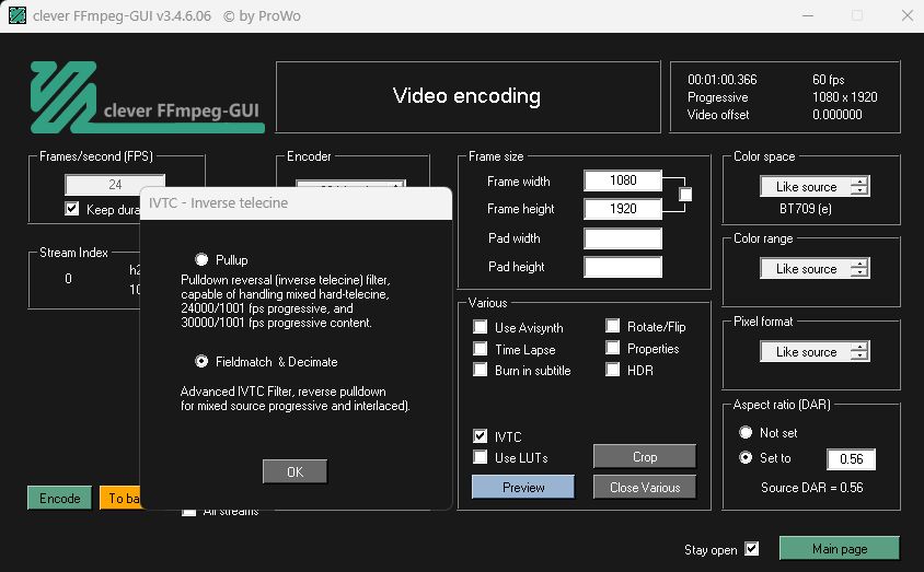

  5. @Manietape
    Hybrid isn't the only tool you can use.
    FFmpeg with GUI can help you in many areas.
    try clever FFmpeg-GUI, it supports a wealth of features, including IVTC/Decimate
    [Attachment 89124 - Click to enlarge]

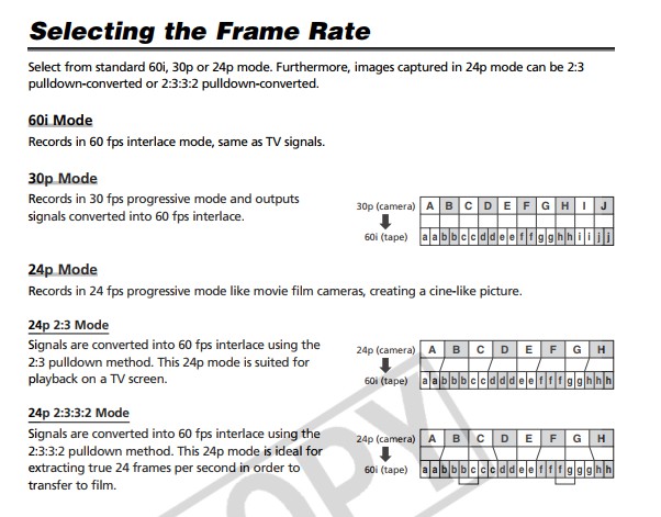

    That's not the whole story. It also "offers" true 24P, as per the manual (AI obviously doesn't/can't read manuals):
    [Attachment 89132 - Click to enlarge]
    As I have already said, the OP should use 24P (not 24P 2:3 or 24P 2:3:3:2).
    No need for IVTC.

    no it doesn't have true pure 24p. there is no way to record it on miniDV tape. you didn't read that page in the manual closely enough. on tape it records either 24p 2:3 OR 24p 2:3:3:2 only. if i recall correctly as it's been 25 or 30 years since editing any xl2 tapes they both required special deinterlacing to get to actual 24p.
  8. What Aedipuss said above ↑.
    MiniDV only accommodated video frame rates (NTSC 29.97 fps interlaced and PAL 50 fps interlaced). I'm pretty sure that was hard-wired into chipsets. It was an "exercise left to the user" to unpack the 24p progressive from the interlaced video version.

    OK, so why has the camera got true 24P recording capability at all?

    it doesn't really. 24p was software faked onto the 30i recording stream of all miniDV.
