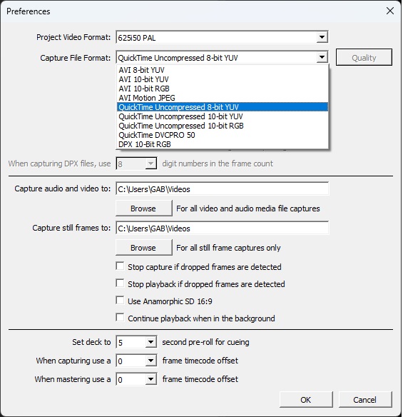

  3. Thanks for the quick response.
    OK so the next step is actually setting the capture device and then getting the footage. So I am using Blackmagic Media Express to capture the footage as that's what came with the capture card. I could use OBS studio if that was a better option, I did try VitualDub and it would not work with the card unfortunately.
    So if I use Blackmagic these are the options and what I have selected. Any suggestions?

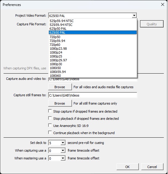

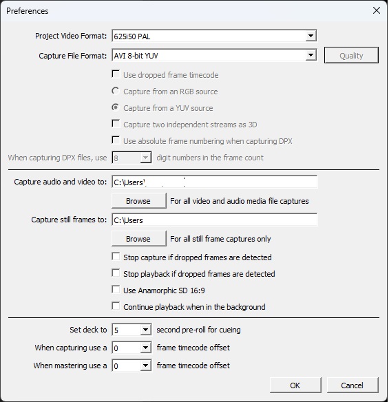

  4. Anyone able to let me know if the settings above are correct? Thanks
  5. I realise I should have shown the options, so this is what Blackmagic Offers
    Video Format Options
    [Attachment 89219 - Click to enlarge]
    Capture Format Options
    [Attachment 89220 - Click to enlarge]
    Mar 2008
    Possibly. Best to do some short test captures and post one here for analysis.
    10-15 seconds should be enough

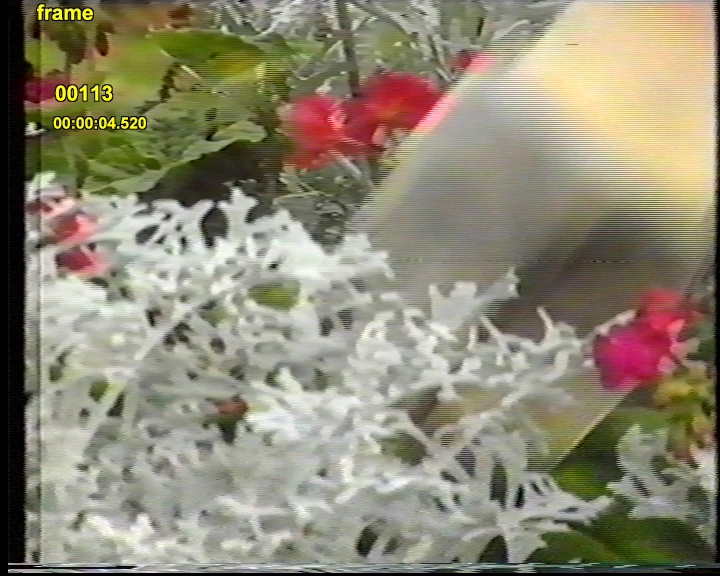

  8. Taking a quick look at your 8bit YUVs:
    YUV422, 720x576, 25fps interlaced, TFF (Top field first). So basically ok.
    The left border looks unusual though for a PAL capture. The width of the active picture (means excluding the black sidebars) should normally be 702....704 pixels. Now it is approx. 690 pixels with a strange bar on the left. The head switching noise at the bottom is about 704 pixels wide, as expected.
