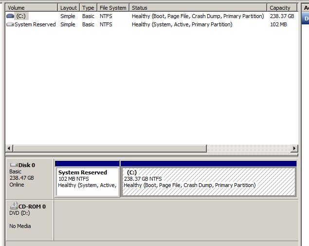

To see the entire drive including hidden, you must use Disk Management tool , which is under Administrative tools, then Computer Management.
Then you get the following view..
[Attachment 91426 - Click to enlarge]
Keep in mind, that view is from a Win7 32 bit install I highly customized which does not have the shadow volume activated.. If shadow volume is activated it would take HALF of the free space shown in C partition.
64 bit installs of Win10 will often have shadow volume activated by default basically using HALF of the drive space..
On edit..
Windows by default at install time also HIDES critical system files like exe (IE program executables), page file, dlls, ini, inf, hybernation file, ect. To see them you must uncheck hide system files and "known file types".. But do very carefully as if you delete or move certain files your system may become unbootable.
Windows can and does also create new page files and hybernation files if the old ones get corrupted, the old corrupted files can end up orphaned, burning up valuable space..
There are tools provided by MS which address those issues, use those tools before just manually deleting, moving files..Last edited by GAhere; 6th Mar 2026 at 19:26.
