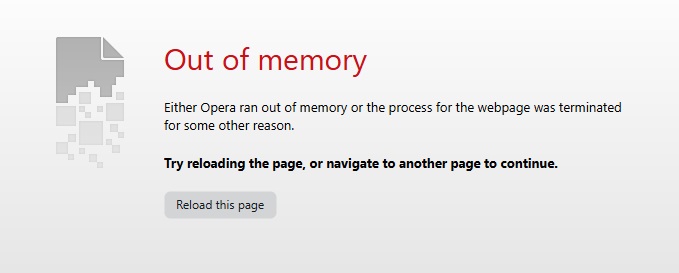

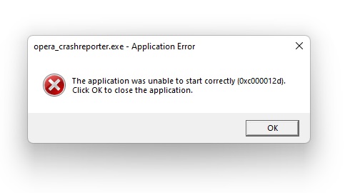

  1. I've mentioned this before awhile back about a problem I had on my Lenovo IdeaPad laptop running on Windows 11. I've had the laptop for about 4 years, but I noticed a few months ago Opera browser (and I think other browsers I was using like Chrome) started to crash and display an error message. This seems to have been occurring more with Opera, though likely because that's the browser I use most of the time. I could never rectify the problem despite people advising me to run a diagnostic, clear temp files, reinstall browser etc. The machine, for some strange reason, one day suddenly wouldn't let me log in with my passport, so I then had to use my sons identical Lenovo laptop that he doesn't use anymore. I've been using it for a few months now, but now in the last week or so I've started to notice the same problem again with it crashing in Opera, more so when I'm on youtube and when bring up a new tab it will crash and display a "crash report error.exe" message and an "Out of memory" message. I regularly clear my temp files in storage sense and temp files.
    Anyone know what's causing this?.
    [Attachment 89017 - Click to enlarge]
    [Attachment 89018 - Click to enlarge]

    The error message somewhat speaks for itself. Memory management is dynamic as Windows adapts and adjusts it's usage
    as the conditions demand. When the RAM availability is low and demand is increasing the system will attempt
    to make more RAM available by moving data in RAM that is not actively being used to the pagefile.
    Tha page file lives on the SSD/HDD and is usually set to have a "system managed" rather than fixed size.
    This allows it to expand if necessary as conditions call for.
    For this mechanism to work properly, you must have adequate SSD/HDD space available so the pagefile can expand.
    But even then, it will not alleviate all out of memory situations. The real solution is more RAM.

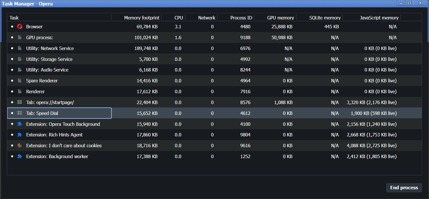

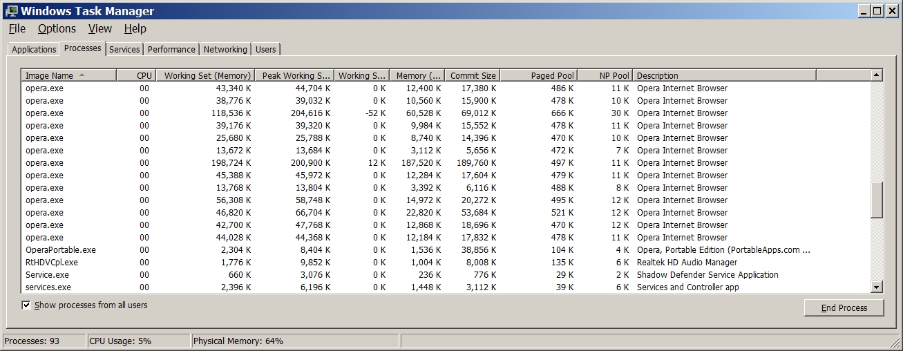

  6. Hi davenet,
    I believe i had read those posts on the Opera forum when I was tryiong to fix the error.
    My Windows Task Manager never has anywhere near the memory use the pictures in the Opera forum have.
    My Windows Task Manager shows the amounts in kb.
    If I convert K to MB the max is about 198MB.
    But I have several opera.exe's showing but only one Opera browser open & only one tab.
    This does not seem to cause problems & I only get the Out of Memory occasionally when going to several pages at ebay or Amazon.
    @videoAI, I plan to test the iron portable.
    [Attachment 89070 - Click to enlarge]
    [Attachment 89071 - Click to enlarge]

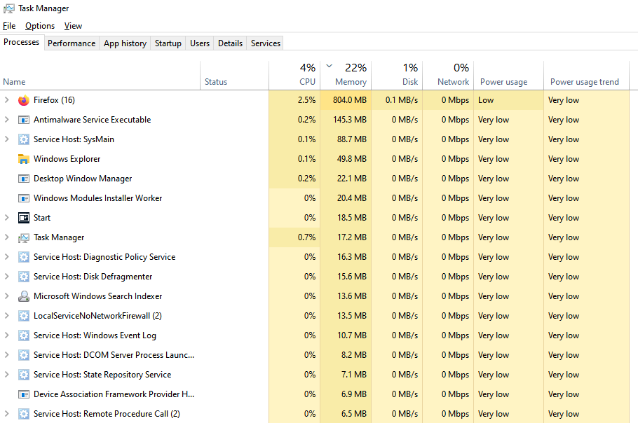

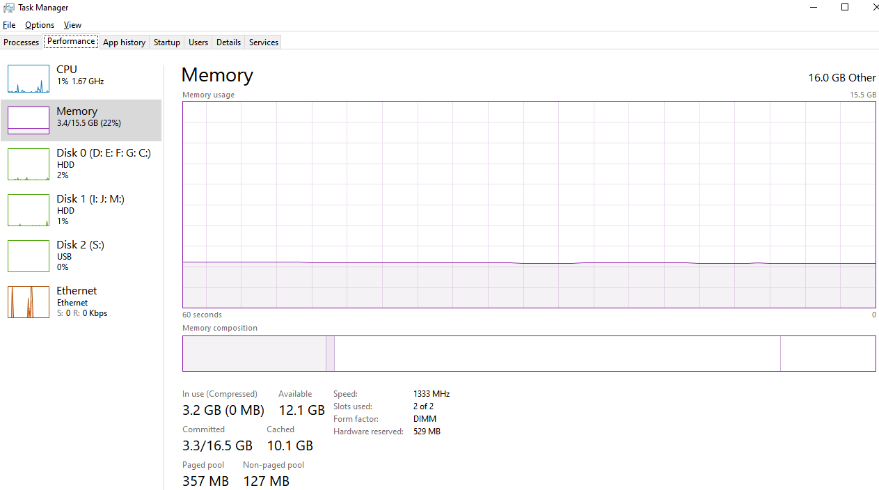

    Probably best to evaluate it using these screens, sort by memory usage on the processes tab
    and the "big picture" view using performance tab/memory. On mine you can see 3.4GB in use,
    12GB available.
    This includes the 10.1GB memory that is "cached" because that memory can be freed at any time,
    it doesn't need to be written to disk first

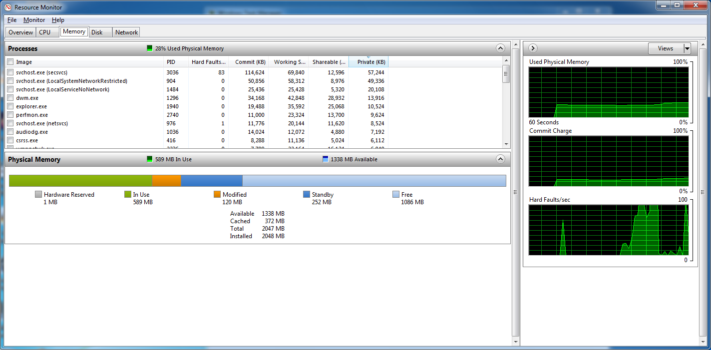

    I also have a Windows 7 32 bit PC, for more useful memory info, use the Resource Monitor
