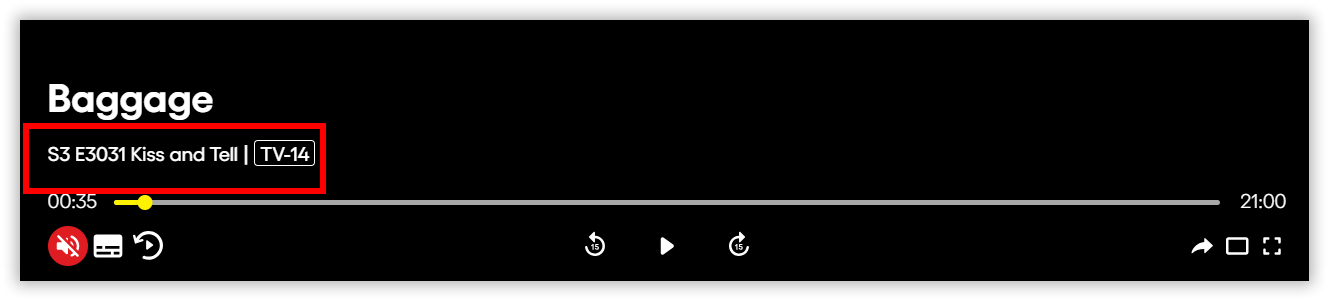

  7. oh shit, sorry for delay and sorry for my bad post above #2
    after 1 hour i've understand your issue: is due to wrong number by pluto!
    ep31 is real E3031, look here
    [Attachment 89004 - Click to enlarge]
    so i think your script work fine, just add 3031 for EP31 !
    anyway here simple m3u8 to download with N_m3u8DL-RE just run N_m3u8DL-RE Baggage.S03.E3031.Kiss.and.Tell.m3u8
    https://files.videohelp.com/u/287921/Baggage.S03.E3031.Kiss.and.Tell.m3u8

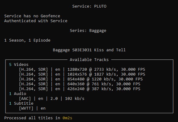

  9. Use unshackle or devine and get videos with the correct title and subtitles
    https://gofile.io/d/0oWGAc
