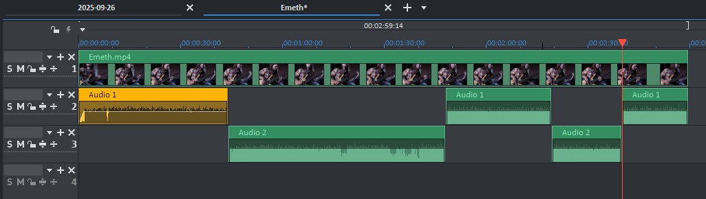

    You need a non-linear video editor. Put your video on the timeline, the two audio objects on the timeline and cut up each one at the appropriate places. Very easily done when you know how (learning curve involved). If you're going to be doing this regularly, programs such as the free KDenlive or the paid Magix Video Deluxe will do it in a flash. Here's Video Deluxe:
    [Attachment 88947 - Click to enlarge]
  4. Magix Video Deluxe looks like exactly what I was looking for. I will give that a try. Thanks a bunch!
