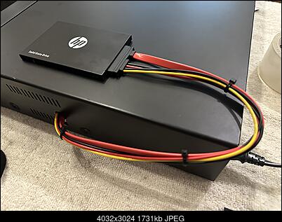

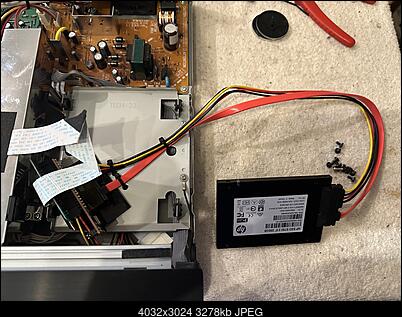

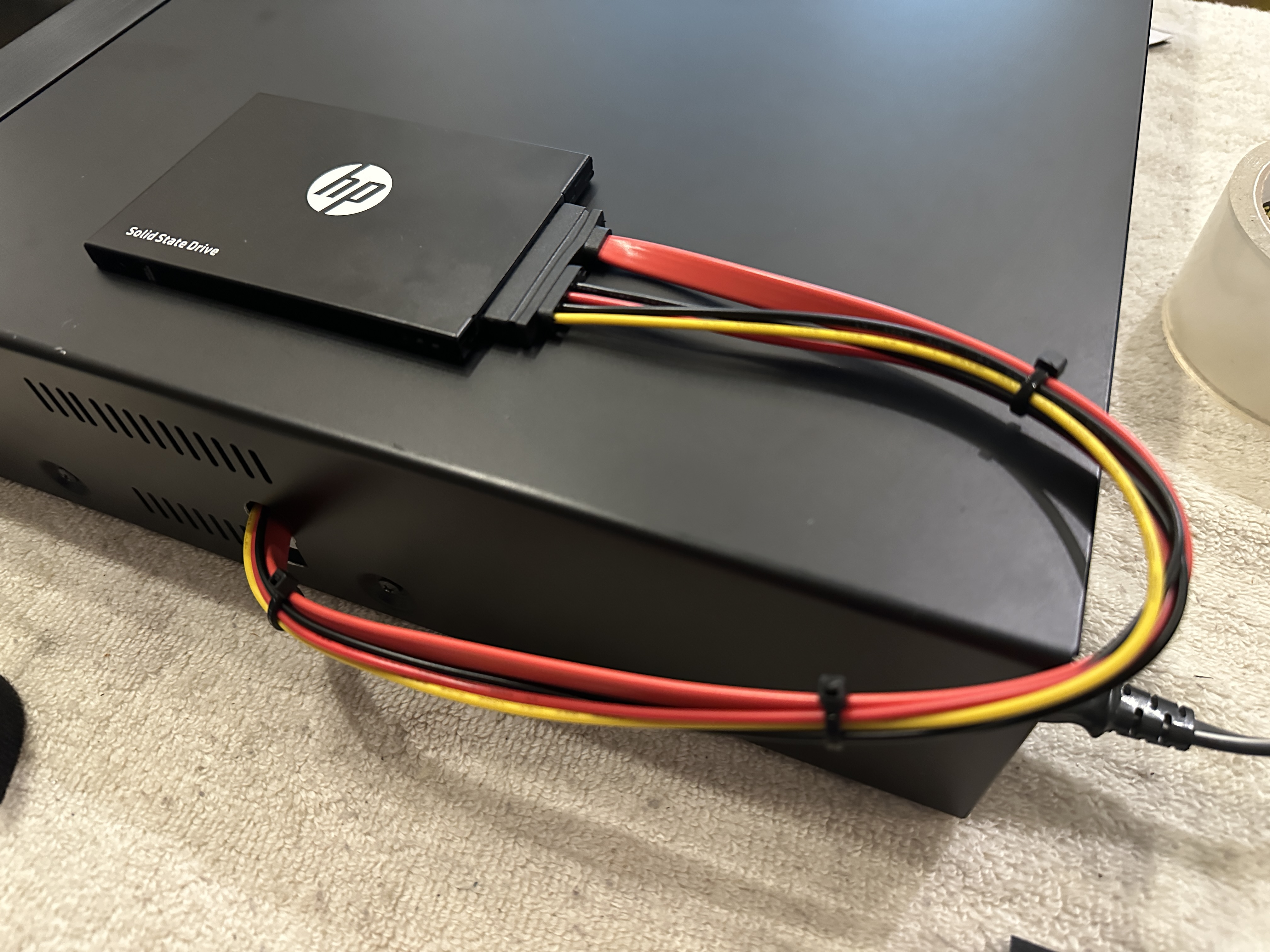

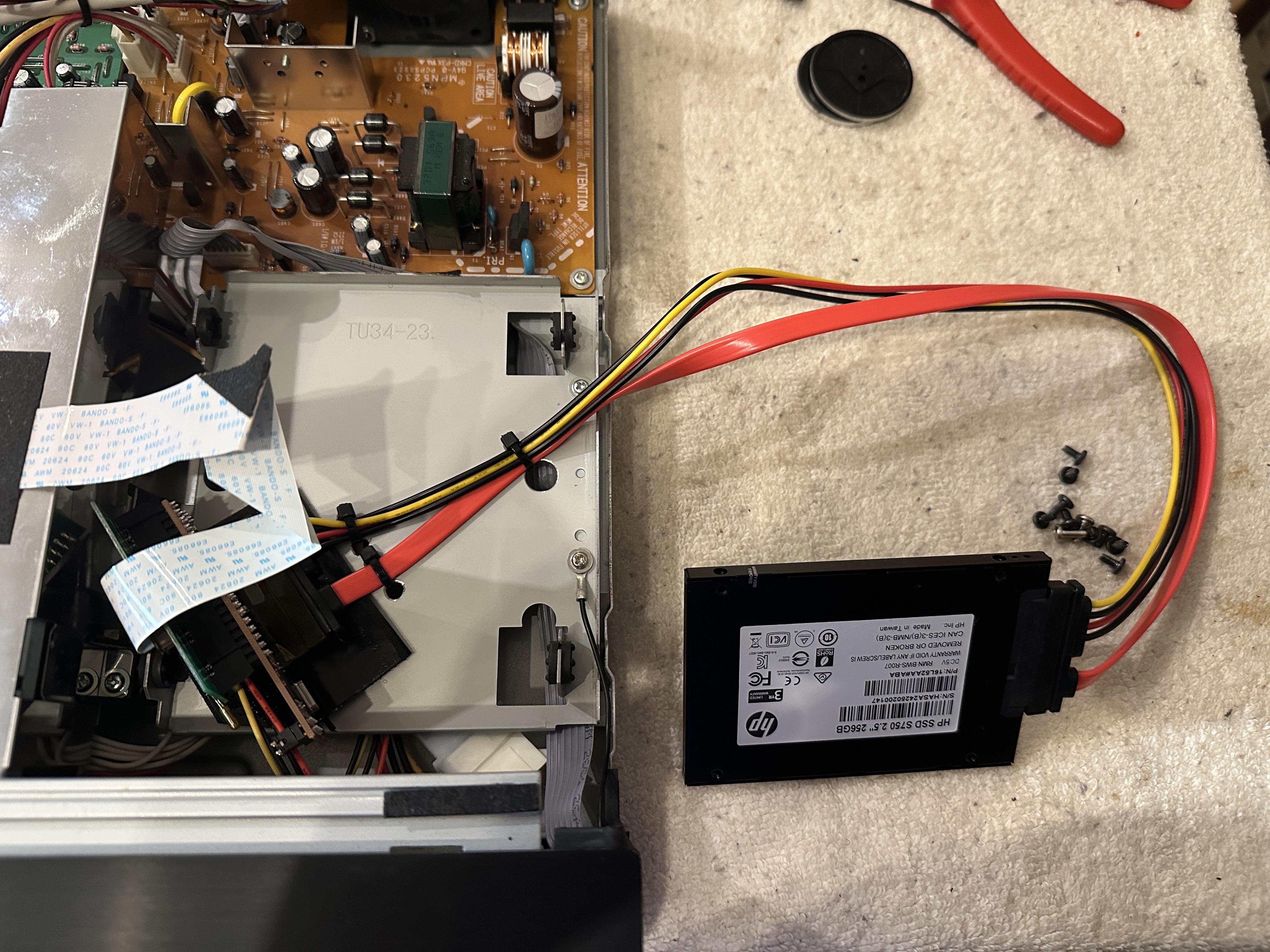

  13. Originally Posted by MrCreosote View Post
    I think I've decided on my workflow: SVHS to Toshiba RD-XS32 or RD-KX50 HDD, then IsoBuster rip the HDD. Appears Toshi has TBC.
    RD-XS series is a good option if you need smaller filesizes and don't need a lossless capture. Many players can do live deinterlacing on MPEG2 files, so as long as you aren't planning to edit either, it can make for a decent distribution format if being primarily viewed on a computer or streaming player that does well with MPEG2 files. There are some documented issues with black/white levels on the XS32 that the 34 and 35 supposedly addressed. The results should be better than most other standalone capture options and is one of the few that preserves interlacing and doesn't require ripping DVDs, but it won't be lossless as mentioned.
    Personally, I converted mine to to SSD SATA and then used an extension cable to make the drive external for easy disconnect/transfer, see attached. Drive is held in place with adhesive velcro.
    [Attachment 88922 - Click to enlarge]
    [Attachment 88920 - Click to enlarge]
