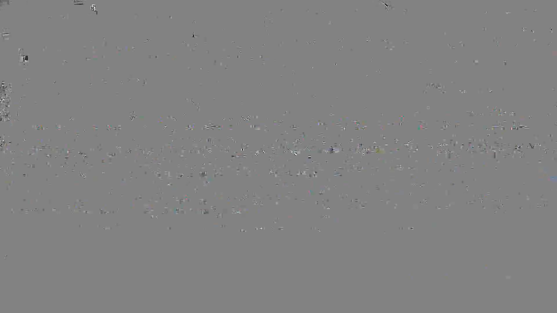

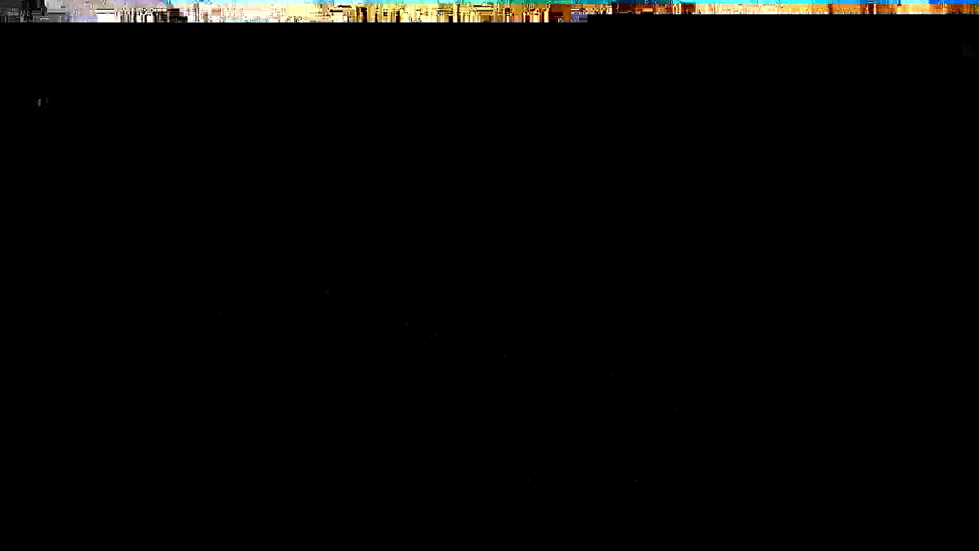

Many players show green/black image or refuse to open the .264:
[Attachment 88848 - Click to enlarge]
[Attachment 88849 - Click to enlarge]
VLC (even with H.264 demuxer selected and hardware decode disabled).
PotPlayer with external LAV Filters forced preferred (also tried disabling internal filters).
MPC‑HC/LAV, 5KPlayer, etc.
MKVToolNix GUI: adding .264 and setting Default duration/FPS produces an MKV that still doesn’t play reliably.
Shutter Encoder GUI (Rewrap to MP4/MKV and H.264/AVC re‑encode) tried; rewrap often fails, re‑encode yields black/garbled video.
