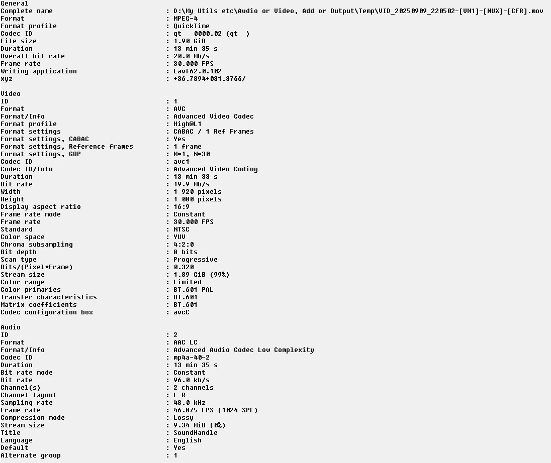

    This is Mediainfo of my CFR version. Anyway main thing is it works. Nice show.
    [Attachment 88884 - Click to enlarge]
    VP23 ..
    shows end clip position at 13:33;28f
    I see now that the audio is at 13:35;24f
    So my conforming did this but mediainfo of original is 13:35 when VFR. I wouldn't sweat it anyway, it plays aok.

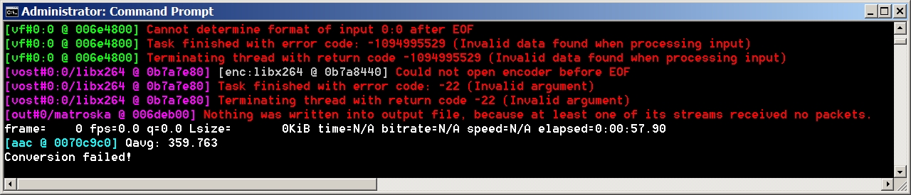

    I first tried a conversion from CLI with FFMPEG.
    I got these errors:
    [Attachment 88885 - Click to enlarge]

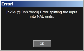

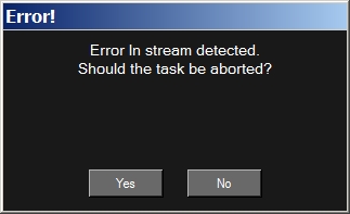

    Then with Clever I trued to encode the video stream & got thes errors:
    [Attachment 88886 - Click to enlarge]
    [Attachment 88887 - Click to enlarge]

    So it has a video and audio duration of 13:35.
    After conforming to 30 fps cfr before extracting streams and muxing it changes to 13m:33s.
    The conforming process shortens the video by ~ 2 seconds.
