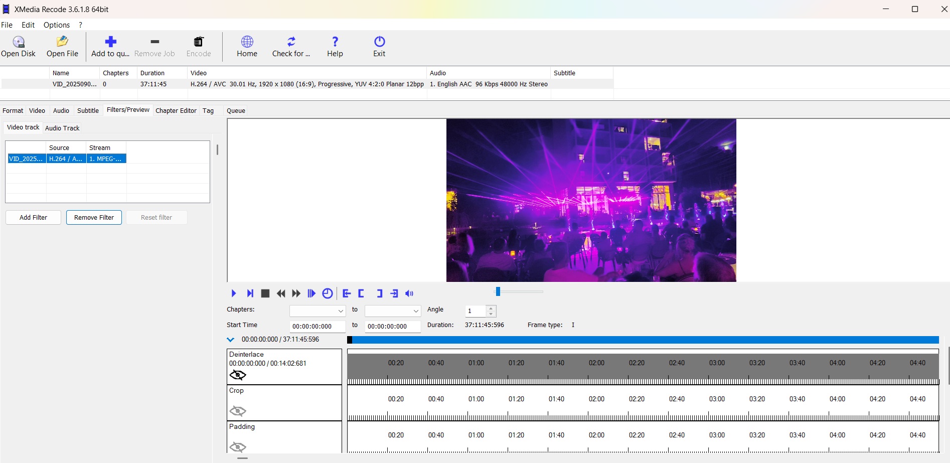

    I tried to convert the file using Xmedia Recode and in the preview tab the video plays fine with sound:
    [Attachment 88840 - Click to enlarge]
    Which leads me to believe that the issue could be due to the fact that the videos are in NTSC format or a codec issue despite already having installed codec packs.

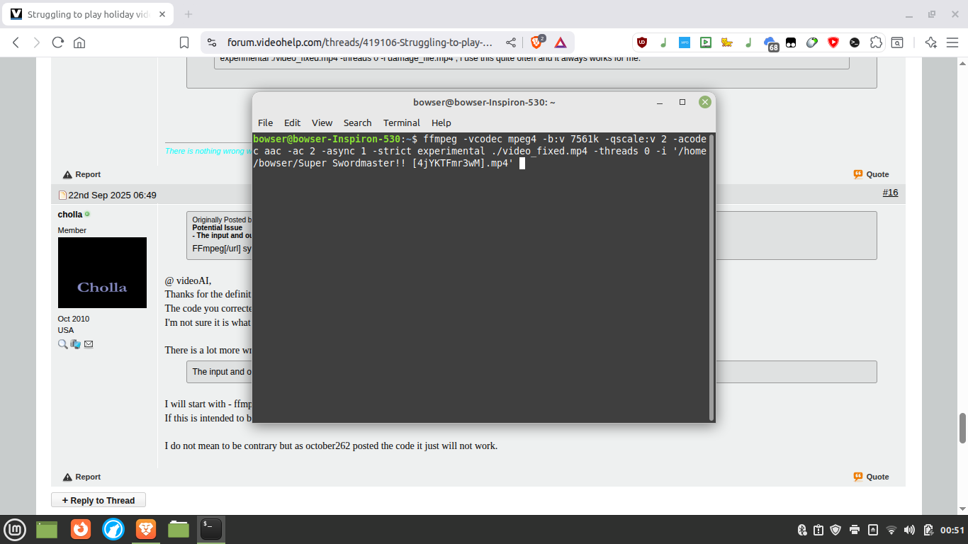

    try running your damaged video file through ffmpeg using this command - ffmpeg -vcodec mpeg4 -b:v 7561k -qscale:v 2 -acodec aac -ac 2 -async 1 -strict experimental ./video_fixed.mp4 -threads 0 -i damage_file.mp4 , i use this quite often and it always works for me.
  12. @ october262,
    Would you explain how to use the code for ffmpeg you posted ?
    I use ffmpeg quite a bit & I do not know how to make the code you posted work.
    Maybe post am image of it working in a command prompt.

    once you enter this part in terminal - ffmpeg -vcodec mpeg4 -b:v 7561k -qscale:v 2 -acodec aac -ac 2 -async 1 -strict experimental ./video_fixed.mp4 -threads 0 -i your bad video.mp4 goes here , just hit enter and let ffmpeg do it's thing.

    ffmpeg -i damage_file.mp4 -vcodec mpeg4 -b:v 7561k -qscale:v 2 -acodec aac -ac 2 -async 1 -strict experimental -threads 0 ./video_fixed.mp4

    Potential Issue
    - The input and output file positions are swapped from the typical [url=https://www.videohelp.com/software/ffmpeg
    FFmpeg[/url] syntax
    @ videoAI,
    Thanks for the definitions of the settings.
    The code you corrected would work with ffmpeg.
    I'm not sure it is what I would use but it should work.
    There is a lot more wrong with the code october262 posted than:
    The input and output file positions are swapped from the typical FFmpeg syntax
    I will start with - ffmpeg the - before ffmpeg will get you a "not recognized" error.
    If this is intended to be the input file "./video_fixed.mp4" it is after the video & audio instructions with some more added after that.
    I'm not sure what the ./ does before the input file.
    I do not mean to be contrary but as october262 posted the code it just will not work.
    Feb 2006
    Originally Posted by videoAI View Post
    FFmpeg Command Breakdown
    | Parameter | Value | Meaning |
    | `-vcodec mpeg4` | MPEG-4 Video Codec | Specifies the video codec to use |
    | `-b:v 7561k` | Video Bitrate: 7.561 Mbps | Sets a high bitrate for video quality |
    | `-qscale:v 2` | Video Quality Scale | Adjusts video quality (lower number = higher quality) |
    | `-acodec aac` | AAC Audio Codec | Specifies AAC audio encoding |
    | `-ac 2` | 2 Audio Channels | Stereo audio output |
    | `-async 1` | Audio Sync | Adjusts audio synchronization |
    | `-strict experimental` | Experimental Codec Support | Allows use of experimental codecs |
    | `./video_fixed.mp4` | Output Filename | Where the converted video will be saved |
    | `-threads 0` | Auto-threading | Uses all available CPU cores |
    | `-i damage_file.mp4` | Input Filename | Source video to be converted |
    Potential Issue
    - The input and output file positions are swapped from the typical FFmpeg syntax
    Corrected Command
    Originally Posted by october262 View Post
    [Attachment 88855 - Click to enlarge]
    see the screenshot after the -i is where you put your bad file and hit enter
    see here with same code the one with #4 next to it - https://video.stackexchange.com/questions/18220/fix-bad-files-and-streams-with-ffmpeg-...ould-not-crash

  19. @ october262,
    Looking at the CLI you posted I figured out how to use the code you posted.
    The end file damage_file.mp4 is the "input file"
    It needs the path to it.
    For me just damage_file.mp4 did not work.
    In your CLI there is a '/damage_file.mp4 with a path.
    For me the '/ did not work I had to use C:\damage_file.mp4
    To add to that Deadlyhydra's file is too damaged to work.
    No code I tried worked on it .
    I substituted a good file I had to get the code you posted to work.
    It still needed the changes I posted to work on my OS.
    Also I had to figure out the new file ./video_fixed.mp4 went to my ffmpeg/bin folder.
