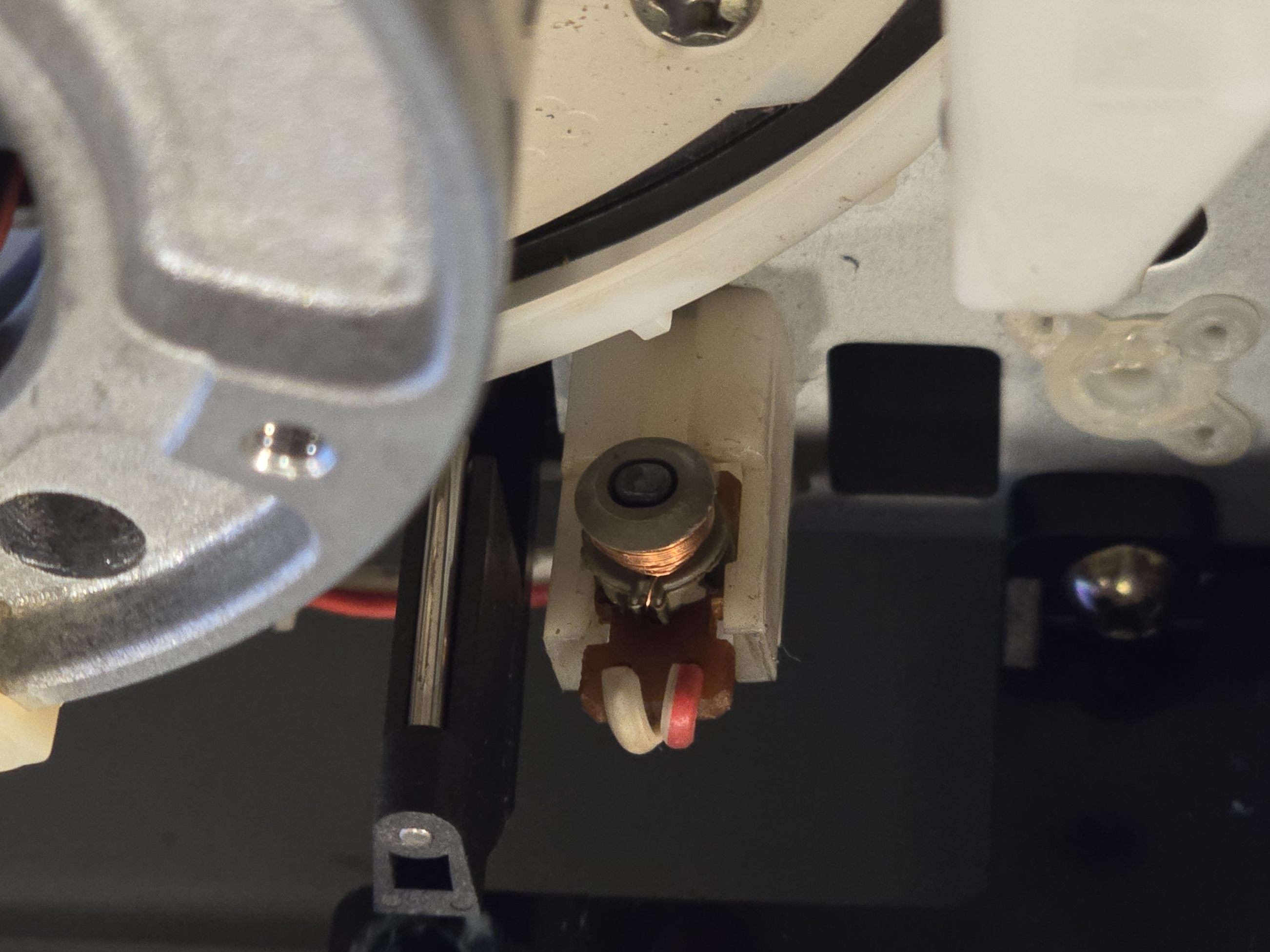

I'm now having tape ejection issues. The cassette is carried in, and the machine starts threading the tape, but it stops immediately at the same point and ejects the tape. I couldn't attach another video file, but I did upload it to the site. Here is the link:
https://files.videohelp.com/u/314628/20250920_044116-00.00.03.325-00.00.22.305.mp4
Any help would be appreciated. It looks like maybe there is some sensor that is telling the machine to eject. The mechanism always stops when the tape is moved in front of this part:
[Attachment 88835 - Click to enlarge]
Any ideas? -
When the cassette goes in and down make sure it's fully seated by helping it tapping it on top, If it worked that means you have loading issues.
