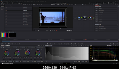

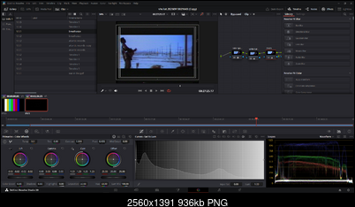

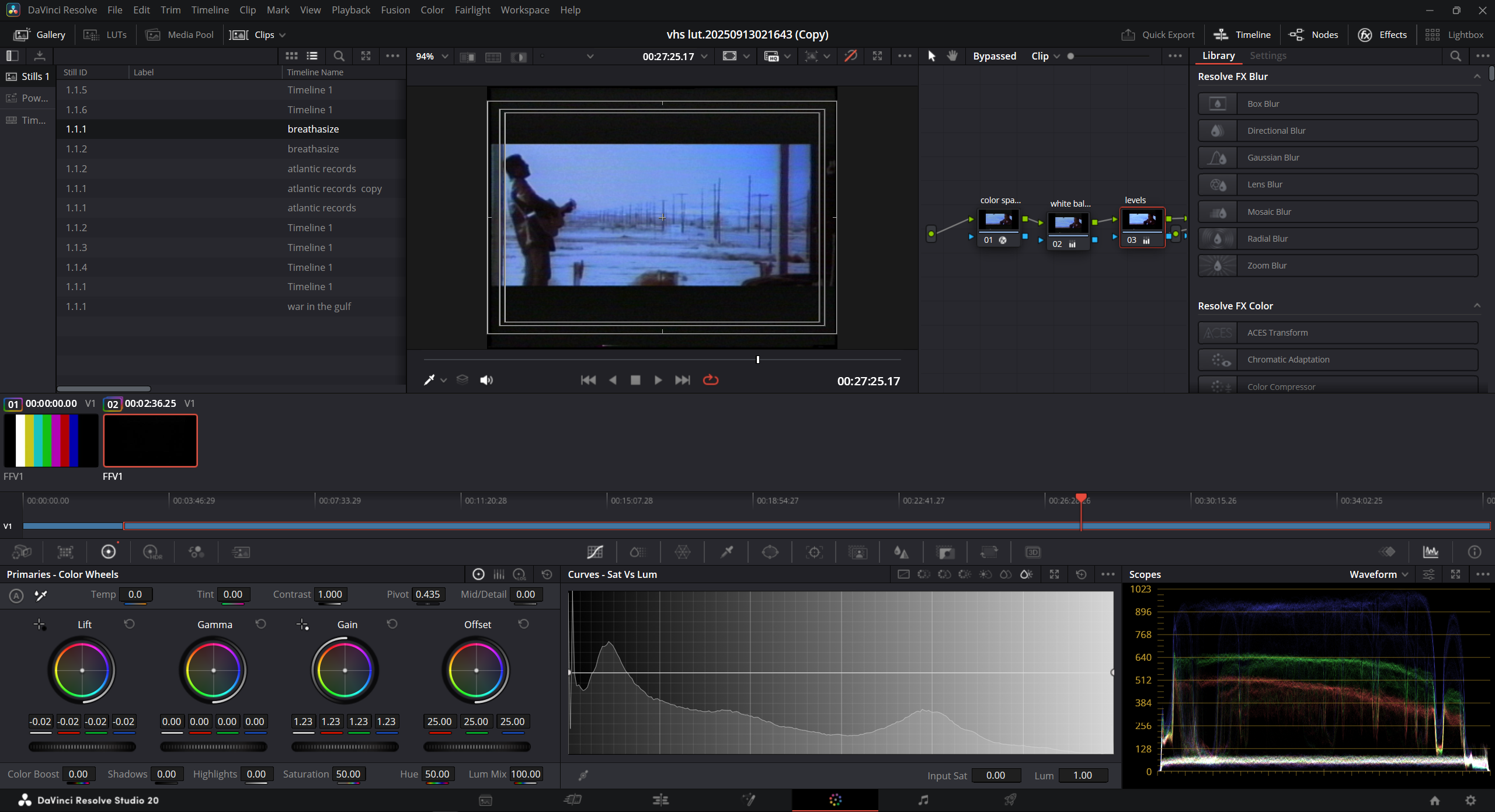

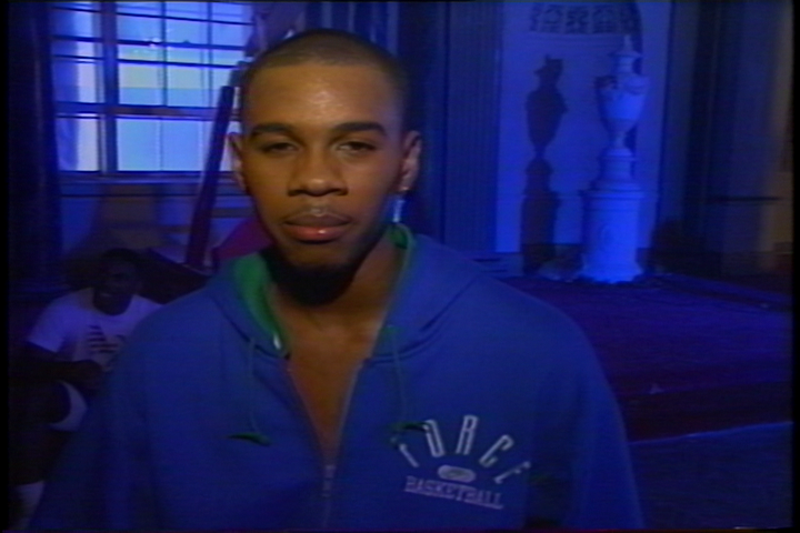

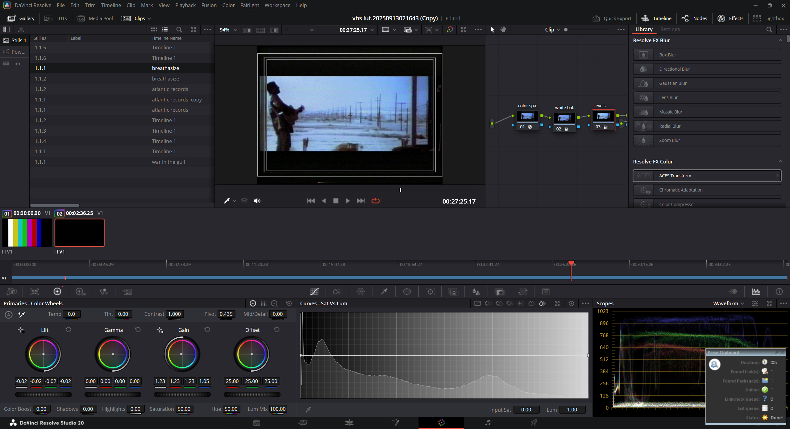

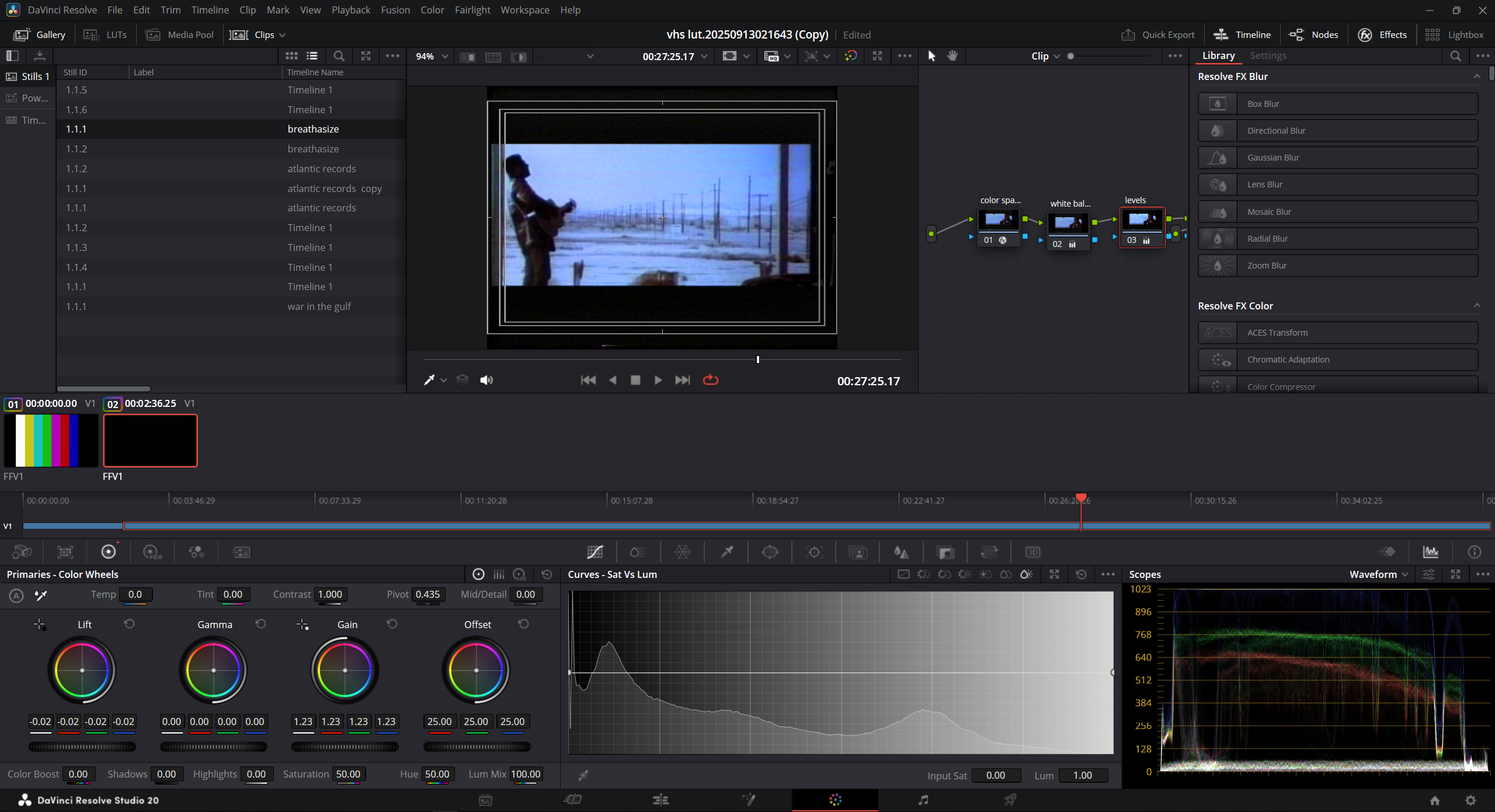

    i'm trying out color correction for my tape transfers in resolve again. i usually do levels adjustment in avisynth, but someone said i should try resolve for color correction. i still don't think i get it. so what i'm wanting is the darkest black to be black and the brightest parts to be bright without clipping. that's what i usually do in avisynth, but in resolve i'm just really confused about it.
    for example on one tape i'm doing, i'm looking at the waveform, and whenever i find a spot where i can go all the way to 1023 without clipping (by increasing the gain), another spot clips, but only in the blues. i lower the gain, and then everything looks washed out. and when i lower the gain on the blue channel, the blues don't clip, but then everything else looks weird. it's like its not white balanced even though i white balanced.
    no correction:

    all gain channels adjusted at once:

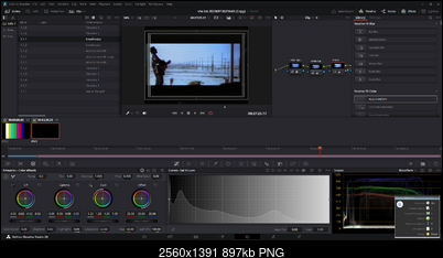

    all gain channels adjusted but only the blues are lowered so they won't clip:

    is this something i should worry about? does anyone have any pointers on how to get this right?
  2. What's wrong with the first picture (no correction)? Nothing is clipped it seems ....
    If you want to lower the darks try to lower the "lift" and "offset" (brightness) adjustments. (I am not really familiar with DaVinci though).
    The second picture is definitely clipped (blue), and only reducing the blue (3rd picture) will unbalance the colors.
    Sometimes one has to accept occasional clipping of one component (e.g. the blue in the sky) for VHS footage. Reducing the gain (contrast, saturation) too much may result in washed out pictures.
    Maybe I am missing your point. I suggest to upload a snippet of your unprocessed capture so someone with DaVinci experience may take a look.
    it's the source tape, it's a little washed out.
    that's what i've been doing and in that regard the darks look fine.
    thats my concern. honestly looking at it now, i don't think it looks THAT bad with the blue channel lowered. it might be a little off white balance wise though, maybe?

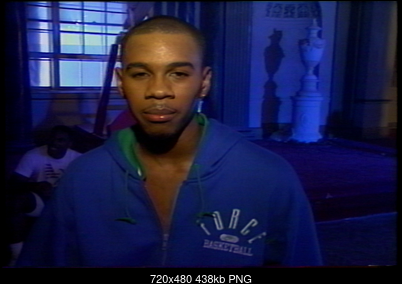

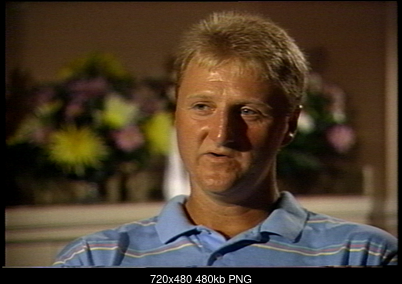

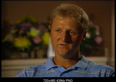

    raw:

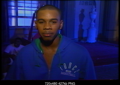

    "corrected":

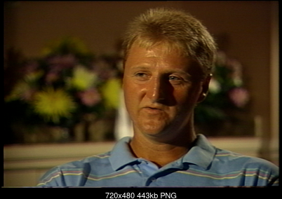

    raw:

    not the same part of the tape but its just an example.

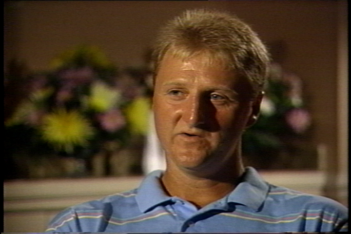

    here you go. this has a good chunk of blue in it. i can send more if anyone needs it.
  4. Not sure if this will help or if you already know this, but if you click the original node and then from the menu click Color--Nodes--Add Splitter Combiner Node you can then correct each of the colors separately, or click the Auto button to auto adjust each color. The result can sometimes be better than doing an auto-correct for the three combined colors.
    thanks! i checked it out and it seems to do the same as using a regular node and lowering the blue gain there. i did the auto corrector and it didn't really help with the clipping.

    This is not the best capture to begin with. What is your capture setup/capture card? Check your proc amp settings. The luma is too low for the brights, see the picture. Adjust contrast and brightness and maybe saturation of your capture device to fit the luma histogram.
    io-data gv-usb2
    datavideo tbc-3000
    virtualdub for capture
    what i usually do is set my contrast to -5 or -10 of the defaults, and have the brightness +5 or +10 of the defaults, and i just leave it at that regardless of the tape, as i prefer doing all my levels adjustment in post. i found that this gave me a little more wiggle room for post processing, there's more detail being brought in. my tbc-3000 has a proc amp too, but i left that at the defaults. i can't view the histogram in virtualdub for some reason. i usually lower the saturation in avisynth as i think its a little oversaturated by default.
    whoever made the tape did a really poor job, the tape itself is washed out. all my other transfers are fine, it's just this one tape. i have this on laserdisc and it looked fine, so it's probably the transfer to vhs that's the problem.
    But anyway, it is not clipped, so you can do corrections to taste in post processing (Avisynth or your NLE) as long as you don't introduce (too much) clipping. In Avisynth you can try something like
    colorYUV(gain_Y=100,off_Y=0,cont_y=50)
    i usually use the levels function in avisynth, maybe that's all i really need.

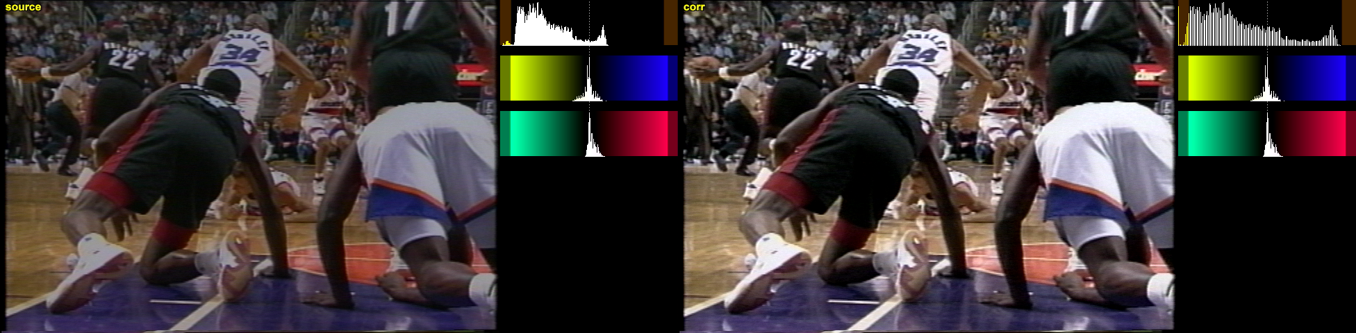

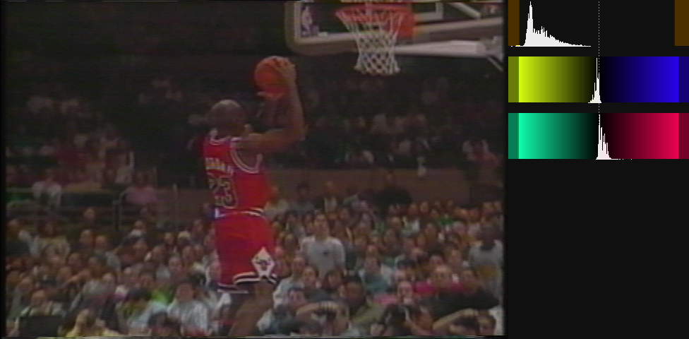

    assumetff().converttoyuv422(matrix="rec601", interlaced=true).convertbits(10)
    Levels(55, 1,735, 0, 1020, coring=false,dither=true)
    tweak(bright=0, cont=1.00, hue=-0, sat=0.850, coring=false, dither=true).convertbits(8)
    colorYUV(gain_Y=70,off_Y=0,cont_y=35).convertbits(8)
    this was slighly modified from your settings. i usually try to keep the brightest parts below the orange bar in the avisynth histogram. i'm just trying to keep everything mostly within the 16-235 range.
